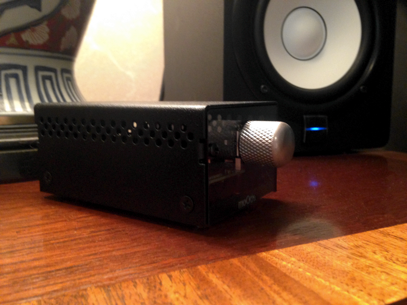

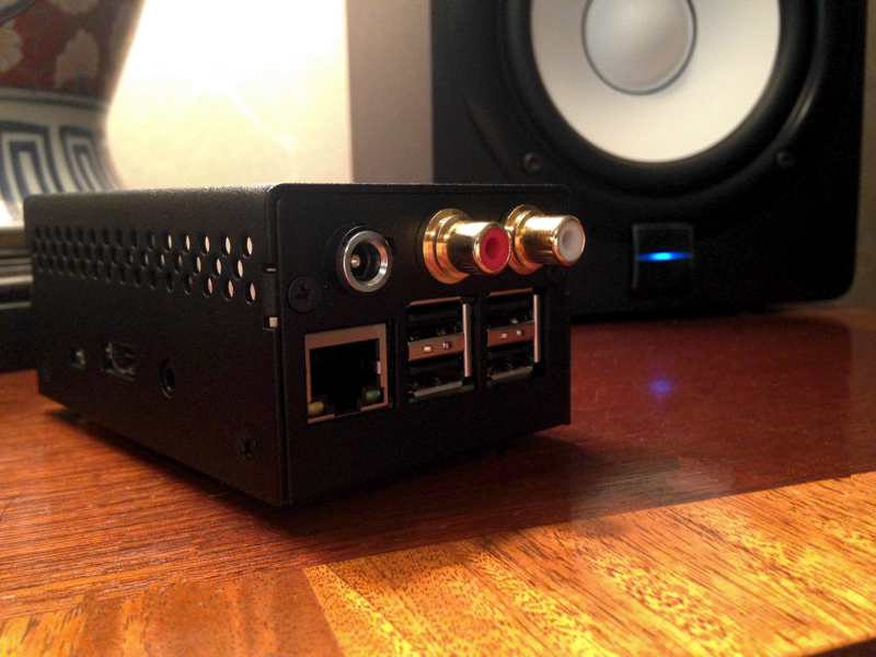

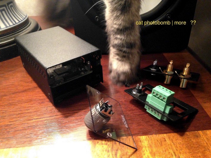

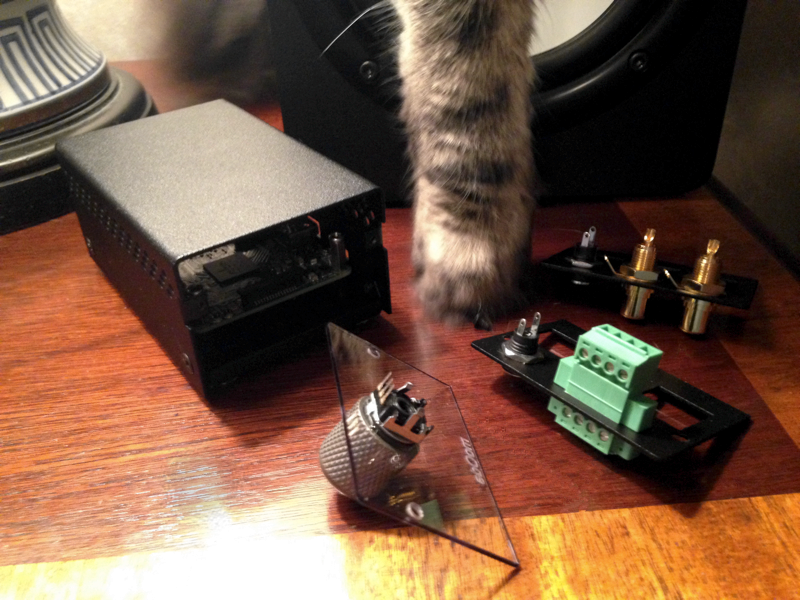

Just a few quick iPhone pics of MoodeCase.
The finish is industrial strength, matte black power coat with a zero-fingerprint texture. The rear panels are machined with double-D, no-twist through holes for the DC barrel connectors and Neutrik RCA jacks. A custom speaker terminal block provides easy and secure wire connections. The front panel is shown with a really nice ALPS rotary encoder and vintage Fender Telecaster knurled volume knob 🙂
Tim
Tim

Whoa. I never thought I'd hear these two items mentioned in the same conversation!
Kidding aside, this is a nice piece of work. Congrats.
Kent

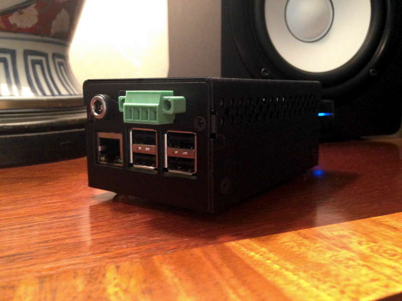

MoOde case
Is there a hint for a custom command for improved SQ hidden in the last MoOde case image...????
