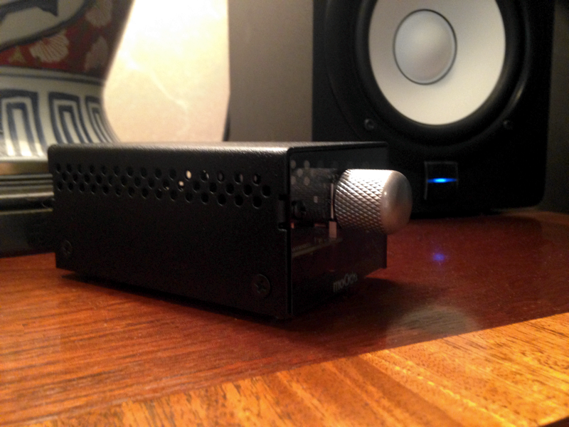

Just a few quick iPhone pics of MoodeCase.
The finish is industrial strength, matte black power coat with a zero-fingerprint texture. The rear panels are machined with double-D, no-twist through holes for the DC barrel connectors and Neutrik RCA jacks. A custom speaker terminal block provides easy and secure wire connections. The front panel is shown with a really nice ALPS rotary encoder and vintage Fender Telecaster knurled volume knob 🙂

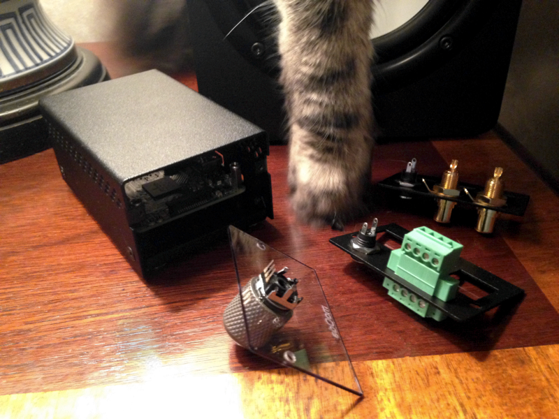

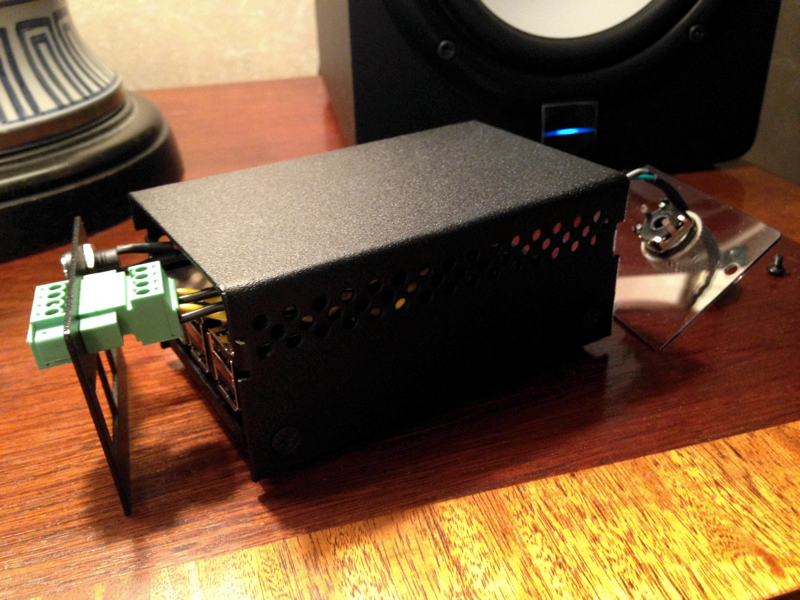

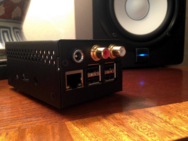

Hi Joe,
I'll be selling the enclosure system online from moodeaudio.org after product photography and web site mods are complete, and after I finalize which boards I can optionally offer in the kit.
The enclosure system consists of the main chassis top cover and bottom plate, choice of rear panels with premium connectors for DAC or AMP applications, clear Acrylic front panel with or w/o ALPS rotary encoder and vintage Fender Telecaster knurled volume knob.
The bottom plate has integrated standoffs for Raspberry Pi 2/3 boards and stick-on rubber feet. All enclosure and board mounting screws are included plus a set of hex stainless steel standoffs and screws for attaching a HAT board.
Pricing is not finalized yet but would be based on the particular combination of panels and options in an order. For example MoodeCase with DAC rear panel and plain Acrylic front panel would be less than MoodeCase with AMP rear panel and Acrylic front panel plus rotary encoder and volume knob.
Some nice options in the works include selected DAC and AMP boards with wiring harnesses for power, audio out and rotary encoder, smoked Acrylic front panels and a custom rotary encoder driver that updates Moode volume knob.
Other possible options include custom colors for volume knob and Soma FM vinyl case wraps 🙂

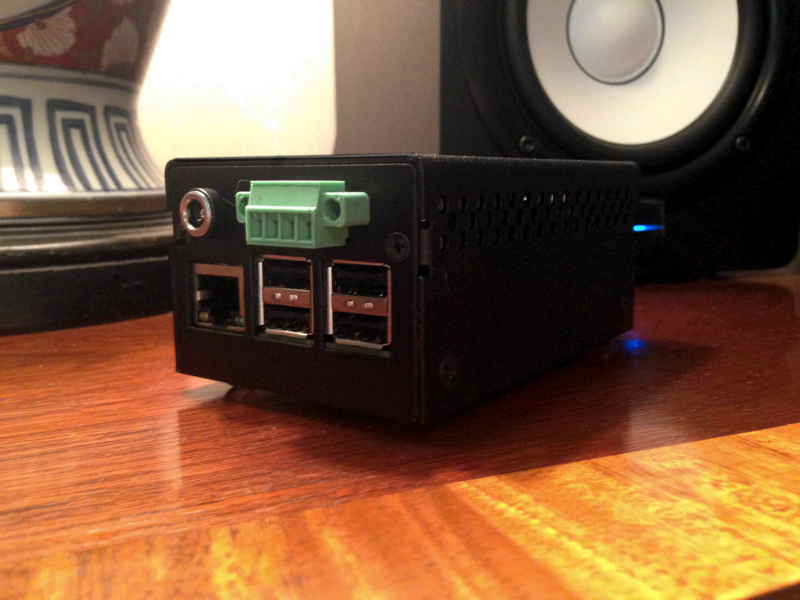

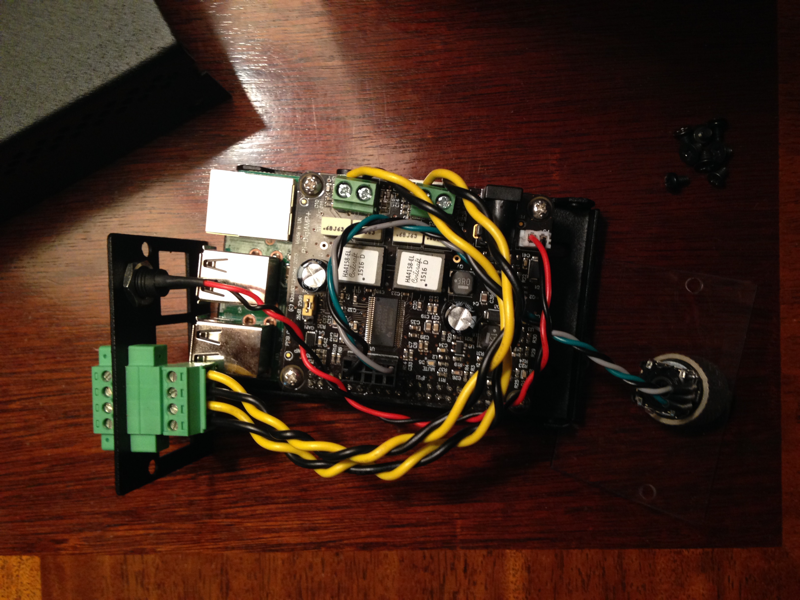

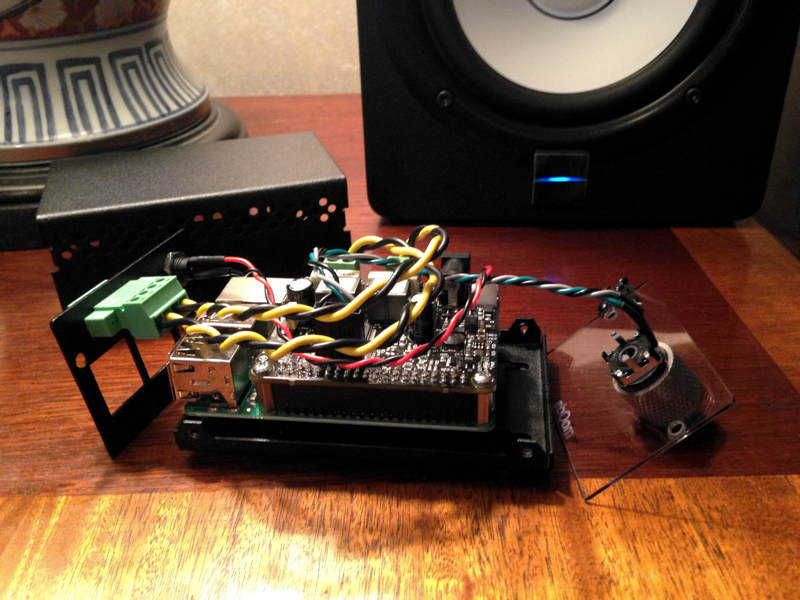

Tim, this looks very tidy! Will the enclosure have enough height for two hat boards, in particular, I'm wondering whether the IQaudio Pi-DAC+ and Pi-AMP+ combination will fit?
Good idea!
Only room for single HAT board. Here are some quick pics of an IQaudIO Pi-DigiAMP+ wired into MoodeCase. The 7/8" (21mm) space above the HAT allows the wiring harnesses to float unrestricted.
Tim
