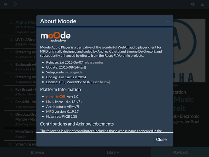

1. it works
2. don't have image file in the folder
3. takes embedded art from the first audio file. If I remove that file, it takes from the next 'first' file.
Example:
a) First artist is A with embedded art, everything is fine and shows that cover art, next artist in the folder is B without embedded art and it still shows file A embedded cover art.
b) If I delete that file A, now is the first file B with embedded cover art and when player switches to the file C without cover art, it still shows file B cover art. Next file could be D or J or X or Y it still shows cover art from the file B. But if this D, J, X, Y or some file has embedded cover art then it shows it.
I think it would be nice to show Moode Player logo if there is no embedded art or image file in the folder. What do you think? Can it be done?
I'm able to repro this and its due to coverart module fallback routine looking for any image in the containing folder, file or embedded if the currently playing song has no embedded image and there are no image files matching the list below.
I can probably change the logic so the fallback routine only looks for image files and does not also check for embedded images but I have to think a bit about whether this would create a situation when one problem is solved but another is created.
I'll add to the TODO list.
Tim
