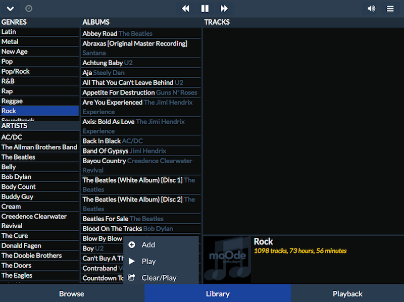

Yup, perhaps I misunderstood, I thought Tim indicated I could play albums, even genres from the Library, but I only have the capability to play tracks.
Very odd. Screen shot shows Genre that can be played, added.
-Tim
