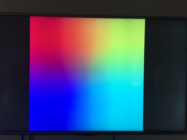

Hi. I have issues with Raspberry Pi 3 and Moode Audio. While moode was playing perfectly well with Raspberry Pi 2, with 3 I get a large rainbow screen. I took some help at Raspberry Pi Forum. Where they advised I sudo apt-get update and upgrade but despite I get a rainbow screen. I was then advised to get in touch with moode creators so here I am. My question is; is moode compatible with raspi 3? If yes what can I do to resolve this?
Thank you.
Thank you.
Moode 2.5 is running 4.1.15 kernel and Pi-3 requires 4.1.18 kernel with the Pi-3 commits. This is the kernel included with updated Raspbian Jessie.
Feel free to try Henry’s Moode 2.5 image that contains a transplanted 4.1.18 kernel. I posted instructions on how to do this and Henry was kind enough to offer his image as download. http://www.diyaudio.com/forums/pc-based/271811-moode-audio-player-raspberry-pi-207.html#post4646871
It should work ok but note that Hifiberry drivers are broken and won’t run on Pi-3. Hifiberry is working on fixes…
Moode 2.6 will support Pi-3 but no timeframe yet for release.
-Tim

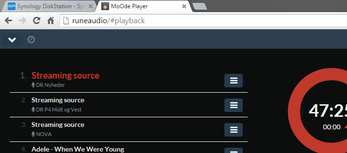

Problem upgrade to R25
I have finally decided to upgrade my ver. 23 to 25, despite nothing I needed have changed to my knowledge.
I'm just having problems connecting to my NAS now and I know I'm using exactly the same path as I have been using the last half year (have pictures of alle old settings). Same IP to NAS and RPI2
My installation hangs a lot and nothing seems to help. I'm using NFS and have had no problems with that.
Last year I tried Runeaudio and have since then lived with the name in my browser, but despite now formatting the SD-card to moOde and clean new install, I'm still only able to use the name Runeaudio as path in my browser - How do I get rid of it ? I can't se how this is possible on a clean install and clearing my browser's settings.
