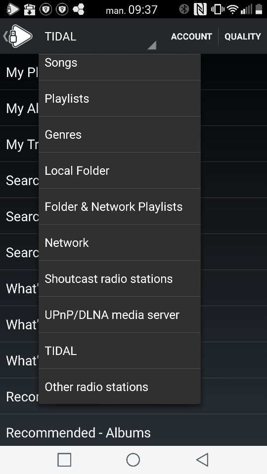

I fully understand your unwillingness to support an endless list of providers such as Tidal etc. However, as described in post 306 in the Computeraudiophile forum it is not difficult to set up a BubbleUPnP server to run on the Moode. This server provides Tidal, Qobuz and Google Music. It can then be controlled by external software like Lumin and run in parallel with Moode. When it plays, the user interface from Moode can control stop and start and volume.
I am also using an app on my android phone called USB Audio Player Pro. He made an interface in which what is provided from BUPnP is available (picture). So, in the same way as you replied about the quest for Roon (which is not attractive for me), would not be possible to make this available in the interface of Moode. This would take no extra effort, since all the maintenance about the providers is done in the BUPnP.
This would make Moode the most perfect player for me!

Hi Henry,
It might be possible but would take time for me to learn, develop a config UI, test and support.
-Tim
