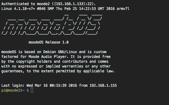

Just a quick status:
moodeOS milestone #2 has been reached. Moode Audio Player up and running on custom factored J-Lite with new core servers, mpd and configs 🙂
Tim

Working on a new audio-centric distro "MoodeOS" based on J-Lite 🙂
Input welcome!
