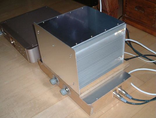

The amp is stable both with unbalanced and balanced input. Only thing is that if I give "high level" input signal voltage at 100kHz, I see somewhat overshoot and ringing in the square wave which indicate excessive HF gain and low damping. All other characters are just fine.
I feel that the balanced input gives me somewhat better sound. The sound is a kind of young, determined, quick responding, clean, detailed and very much enjoyable. I am thinking that this amp could be used not for a sub system, but for my 2nd main system. I neither calculated nor measured the power. Anyhow, the sound level is loud, louder than enough.
Next week I will try 4ohm 92dB Ariel speakers.

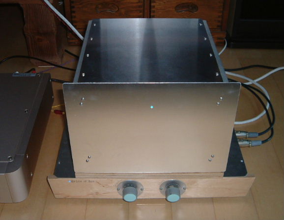

This shows the face of the finished baby and the blue LED. Sized WxDxH 30cmx28cmx21.5cm.

Thanks; I knew it would be loud enough, certainly with your sensitive speakers.
I like the look of the amp, looks very solid and with the oversized heatsinks, it seems like you build a massive power amp. Compatible with Peter Daniel’s products! :nod:
/Hugo - happy now, with the blue led.😎
Little Big Man
I have thought the heat sinks are oversized. But, I have found that they are of proper size. They are nearly cold on idling condition. Once the signal is injected, however, they get to rather warm. From this fact, the current booster is considered as being able to boost the current much more than required to the speaker impedance, probably even for the lower impedance speakers. If this is true, this amp would be of having a good output power. This is based on a presumption without any measurement or calculation, but with the heat sink temperature and with the quality of the sound.

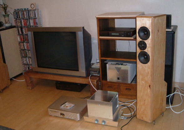

Attached shows PASS_YAX2_JH with 4 ohm 92dB Ariel speakers.
Loudness and sound quality are good. My immediate impression is however that they do not match well, particularly against bottom frequencies, which play important role of musical foundation. In this respect, the 6 ohm 86dB (maybe 88dB) Phase Technology PC80 speakers are much better for this amp to my subjective ears.

Yeah , I feel the same with Dynaudio , a pair of old small IMAGE ,
they are 89db into 6 ohm , but that mpedance is easy to drive into low frequencies.Otherwise there are 90db into 8 ohm loads speakers , (BandW) that presents peaks of low impedance in those ranges of freq were more energy is needed.
