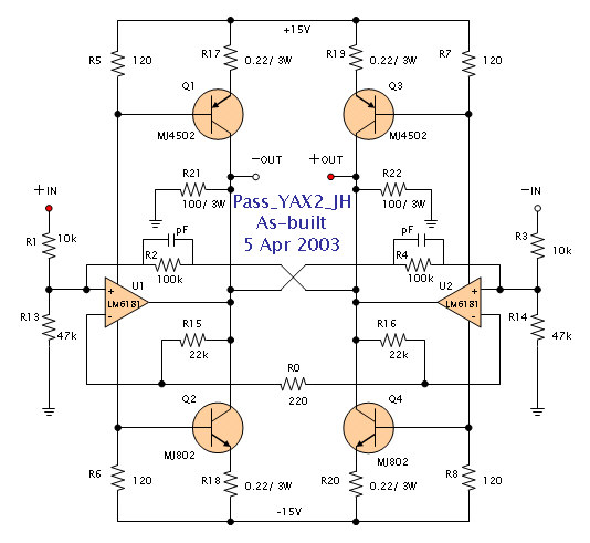

Part of the charm of a "current feedback" type op amp
is that it is not an ideal op amp in the usual sense. It has
a poor input impedance on the (-) input node, a highly
exploitable "flaw".

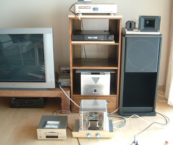

jh6you said:Here is a new construction.
I am listening with the unbalanced signal input. Sweet...
JH

Netlist said:
Passdiy should make a seperate gallery for it.![]()
I was thinking about it, Hugo.
JH

This thread is merely a diversion along the path. I would not
expect anyone to take the integrated circuit approach too
seriously, but I do think it has been an instructional excercise.
JH has done particularly well, I'm sure we'll all agree.

Nelson Pass said:This thread is merely a diversion along the path
it has been an instructional exercise.
Nelson,
if a circuit got all the supersymmetry stuff except the cfb OP, will it be supersymmetry still ?

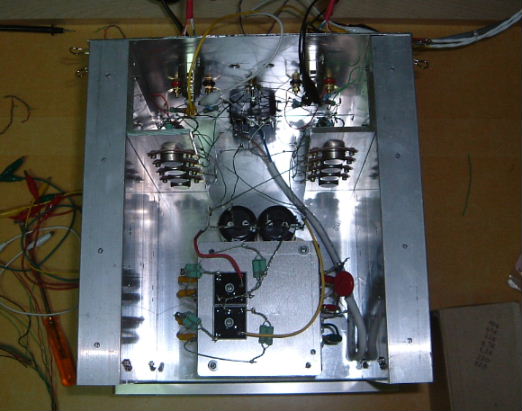

The XXX file
The space in the middle is for upgrade with madness circuit.
Mosfets can be paralleled of course.
JH, is there a difference in sound, power, stability ...
balanced vs. unbalanced?
Bernhard, according to the rule: gain is feedback R/ input R
you seem to have very high gain. Not good for distortion IMHO.
Try a square wave too.
/Hugo 😉
/Hugo 😉
