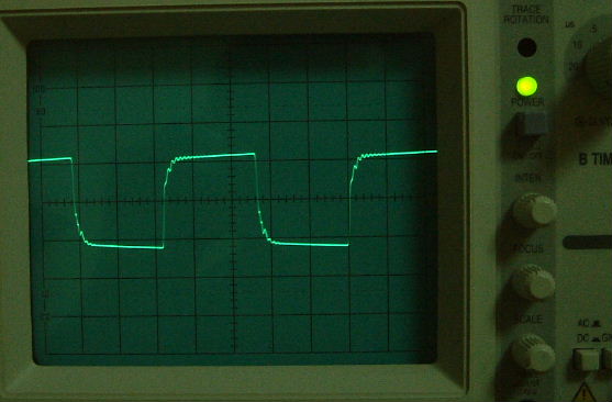

Finally, at 100kHz (1V/Div, probe setting x10).
Here, I see the overshoot and ringing clearly. This however looks OK for me. It must be that two poles (conjugate complex numbers) are in the stable side and so the ringing decaying rather quickly. I imply that the amp is stable. But, since I am not a professional interpreter about the overshoot and ringing, if you tell me any different opinion or any tip, I would much appreciate it. Thanks.
JH

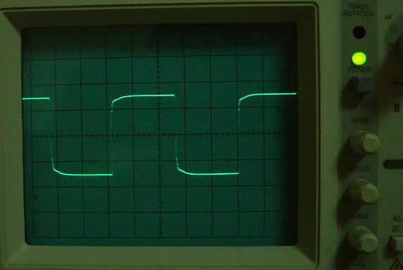

jh6you said:Then, I pressed the square wave button.
The shape is a bit odd, maybe you should take a look at the scope probe adjustment for best sq wave at the input?

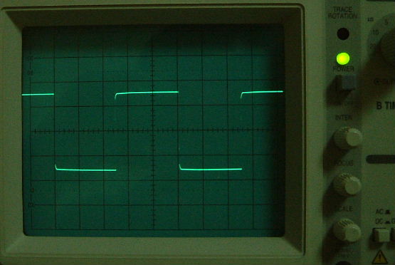

Example of the input sq wave.
JH

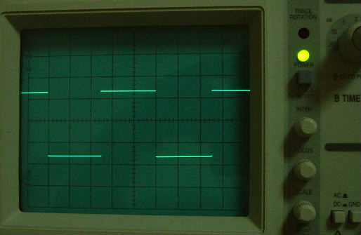

Nelson Pass said:Your output square wave still looks like the probe needs adjustment. I would recheck it.
How do you go about adjusting a probe?
Most of the times there is a little trimmer on the tip area, which allows you to trim the internal cap across the series resistor. (This is with 10x attenuator probes). You connect the probe to a cal signal (which should be available on the scope) and adjust for best-looking square wave.
With straight 1x probes, there still sometimes is a trimmer to adjust for cable cap, but this trimmer may be on the connector of the probe to the scope.
Jan Didden

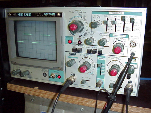

On many scopes you have a calibration output, mine give 0.5Vpp
squarewave. Just hang the probe on that calibration point. On the probe there shoud be a small screw. Turning that calibrates the probe. On the right side of the picture you can see the probe hanging on the calibration point.
/Hugo
