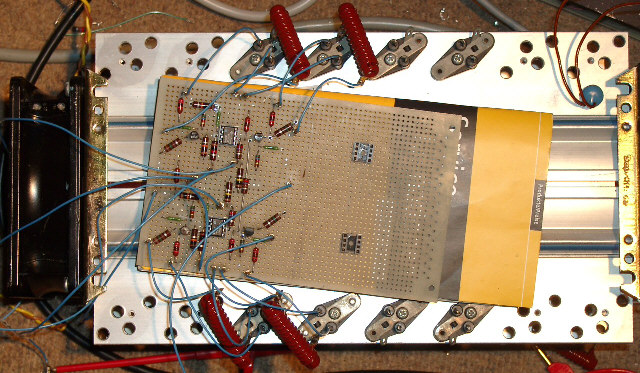

This LM6181 is a beast
It does not make any sense if I post the picture from the scope.
I think everybody nows how a sine looks. 😉
My scope has a multimeter that shows everything: Frequency is 3,05MHz with modifications, V0p is full swing to the rails 😡
With 100nF across the 10k feedbacks, the mosfets get melting hot in seconds.
Also I have loud 100Hz noise.
Now I have tried the NE5534 instead.
Everything perfect:
No noise.
No offset ( 0,0065 V ). Best result ever.
No oszillation.
No heat. 130mA through each Mosfet.
No supersymmetry
I have no idea what to do about the LM.
May be the gain is too high.
SOS, please

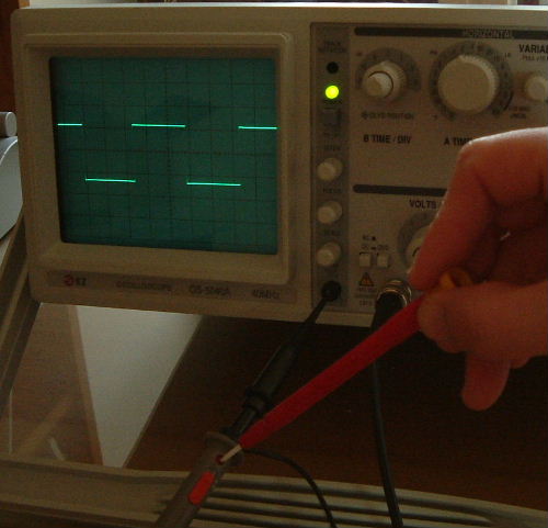

Re-adjusted the 10X probe for the proper compensation.
And measured at 20kHz on vertical scale of 1V/div.
Arrrrrrrrrrrr.................
Funny.................

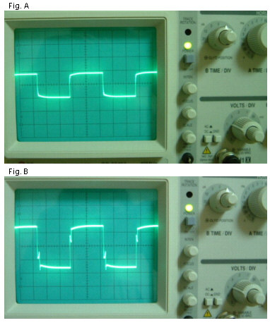

When output sine wave is at 25V (peak to peak), the sq wave is as shown in Fig. A. But, when the output sine wave passes beyond 25V (ptp), the sq wave changes as shown in Fig.B. I can't understand this. What's wrong...? Sigh.
JH
PS. But, the sound is still like a sweet green apple.

The squarewave in fig. B is due to the female touch on your probes.
No, to me it looks like a perfect normal clipped squarewave.
Perhaps 25Vpp is the limit for your amp. But squarewave experts will be capable of giving you a better technical explanation.

Netlist,
it is the schematic that I have sent you by email. (Also posted here, uses 2SJ/2SK Mosfets)
Its made for the LM but it fails in reality.
But with the NE for which it was not made, it works.
The waiter from the coffee shop round the corner told me, it could be a ground loop that causes oszillation, but the LM is just too fast.
May be the idle current is too high also.
I have tested the circuit with NE and 27V
rails, no problem.

JH,
The top graph seems normal now, no sign of probe maladjustments.
As for the lower graph, it is not uncommon for amplifiers with not enough stability margin to break into oscillations or oscillatory bursts, like here, with increased output level. Practically all capacitances and other specs of semiconductors are voltage- and current level dependent. In a certain sense, your (and anybody else's) amp changes its character with output level.
The only sure way I know to cure this is to improve the stability margin until you can go up to max output with a clean square wave. And oh, dont forget to test with some cap loading at the end of the speaker cable (like 1uF // 8Ohms). The square wave can have longer rise/fall times with cap loading, but should not lose its integrity.
Ahh, such are the pleasures of amp design....
Jan Didden

Thanks for the comment, Jan Didden.
Accordingly, I re-thought about the principle of feedback and stability.
Trying reduction of loop gain, I switched the input resistor value from 10k to 15k, with a positive result. The clean square wave maintained untill the voltage swing reaches to 35Vpp. I'm going to increase the resistor value further up to 20k, and will see another result (for further improved stability margin).
Sure of the pleasures... 🙂
JH
PS. Somewhat lower gain is acceptable as the superb BOSOZ drives it.

JH,
This is interesting, because lowering the (closed) loop gain means higher feedback factor which generally makes things worse (as far as stability is concerned).
The fact that in your case it improves with higher input R points to some unwanted (pos) feedback to the input pins. You may want to review your layout (if it's PtP) to make sure there is no unintentional coupling of the output signal to the non-inverting input, and/or no unintentional coupling between the two inputs.
Jan Didden
