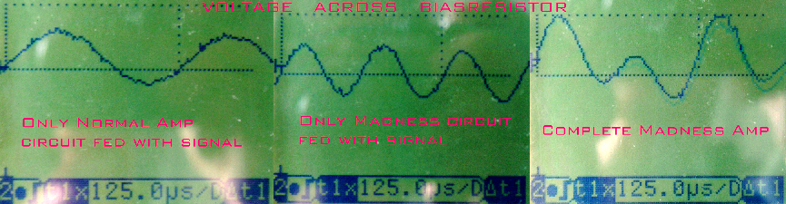

The signal across the bias resistor is small and I can't find my probe... 🙁
Any comments ? 🙄
The amp sounds the same to me with normal and with madness operation
Any comments ? 🙄

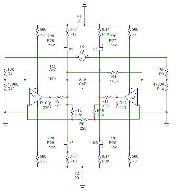

This is the very good working balanced Mosfet version: see pic below. Note the 4ohm load (my two speakers in parallel,). Didn't build the stereo version like you. Of course anyone can jump in to make improvements.
Bernhard said:The signal across the bias resistor is small and I can't find my probe... 🙁
Any comments ? 🙄
Difficult to say, but to me this doesn’t look like a 'clean' signal.
What do you mean by bias R's? R3/4/6/7?
Where or what do you connect, disconnect to switch the Madness on or off? R17/31/32/33?

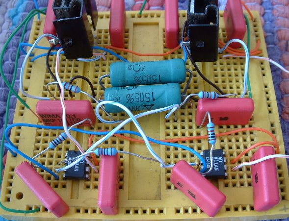

OK circuit together, but it's not working yet🙁
In the pic below you can see the finished breadboard, with the X in the middle bottom and the two parallelled 15Ohm resistors as the load.
When I first plugged in one of the OPAs was oscillating I assume, as it heated up quickly, so I added the .1uf to ground as per Sawzal's idea. This killed the heating, but after I applied a signal I get no output. So, I think I will check all the devices, and then retry maybe using some of Netlist's ideas.

The signal is small and I do not have a probe so the cables pick up noise...
Yes, R3/4/6/7.
I have seperated the inputs of the madness part of the circuit from the inputs of the normal part.
I disconnected the wire that goes from amp input to R20/21, so normality/madness become independent.
But there is always the idle current from all three OPs/each side.
I will make new measurements, it was AC coupled and...
pinkmouse said:OK circuit together, but it's not working yet🙁
Hi, pinkmouse
I never build the circuit, only sim.
Why all those caps around your board?
Where did you get those breedboards? Looks like you can do the "Turbo-DIY" with them. 😎

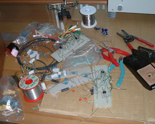

/Hugo - will post a picture of his "mess"

Well that makes two of us then!😉
The four on each end are for decoupling the power rails, as suggested in the device app notes, and the two in the middle run to ground from the X resistors as suggested by Sawsal.
I got them from a friend who found a load of bits in a cupboard he used for electronics when he was a kid.
I now have the circuit working, (badly), but I think there may be a connection error somewhere as it is distorted and single sided!
The pic below shows the input and output:

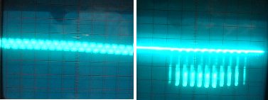

Guys...
Wanna know, what is real madness ? 😡
My PSU is already in current limiting mode and gives big fat 2,2Vpp triangle spikes with 50Hz repetition rate 😡
This was not visible in the first measurments, because one side of the bias resistor is on the rail...
Now I tried to see whats going on on the madness OP supply wires, and I was wondering and wondering...
Ramp all over the screen... 😕
But the amp seems to be very good. Even this worst case PSU gives a clean output signal. 😎
Now I must build a PSU

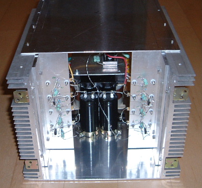

Here is a picture showing the amp on progress into a case (rear view). I could restart the listening this weekend--with the balanced input.
JH
PS. The case is not a brand new, used materials. This is why the heat sink is this big. And there are many old bolt holes. 🙂
JH

jh6you said:Here is a picture showing the amp on progress into a case (rear view). I could restart the listening this weekend--with the balanced input.
Joooohooo....looks like you cleaned up the mess.
Nice.
/Hugo - his amp will never be boxed.
