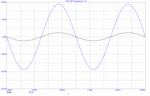

I made a sim, based on Rookie's schematic.
I was just playing with resistors and their values, not a single cap came in.
Little by little a nice sinewave showed up in transient analysis,
the gain increased, until I could no longer wait to post some results.
The drawing is a mix of everything; Nelson's original idea, Rookies
schematic, the datasheets of the AD811/OPA544 ( the sim has no
OPA549, for the moment) and the bits and peaces I learned from you all.
The source is a 1Khz 2.1Vpp sinewave and the load is an 8ohm resistor. I(load) and V(load) are shown in a separate picture.
The resistor values are hidden for now, not to influence anybody.
I would very much appreciate the input, (Nelson, Sawzall?) from everyone.
Perhaps its not even an X, and far away from SuperSymmetry…
/Hugo – waiting for feedback, but working in the meantime. :wiz:

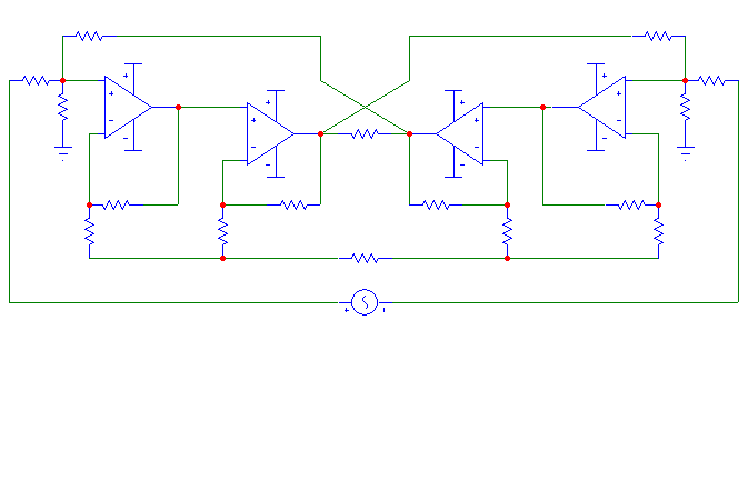

maybe you like to put my madness circuit on the sim too 🙄
My idea was to have classA at all power levels.
But without having classA idle current all the time.
The additional circuitry in the center works parallel to the basic OPs.
It modulates the idle current.
If you measure the idle current while having a sinus on the input, the idle current will be a sinus too.
More current flows through all the bias resistors / transistors when there is a signal.
If you leave out the basic OP circuitry it should work like this:
There is normal idle current.
If there is a signal, the idle current will go higher on both sides accordingly to the signal.
No input signal --> Normal idle current.
Full input signal --> High idle current.
So no output signal, no DC offset, just modulated idle current.
IMHO this means classA all the times, but low power dissipation when low signal or low signal.
Paralleled output devices will be required.
May be all this is nonsense :cannotbe:

Ok, I have revised my madness circuit.
There was one big error.
I don't know if it will work now, its a circuit for diskussion. 🙄
How it should work in detail:
If we put a static 1V input signal on the +input of the amp (left side input)
additional current will flow through: R6 R17 IC1 R9 IC4 R31 R4.
If we put a static -1V input signal on the +input of the amp (left side input)
additional current will flow through: R6 R17 IC4 R9 IC1 R31 R4.
Now IC1 must take care of the introduced (by IC1 and IC4) DC offset too...
