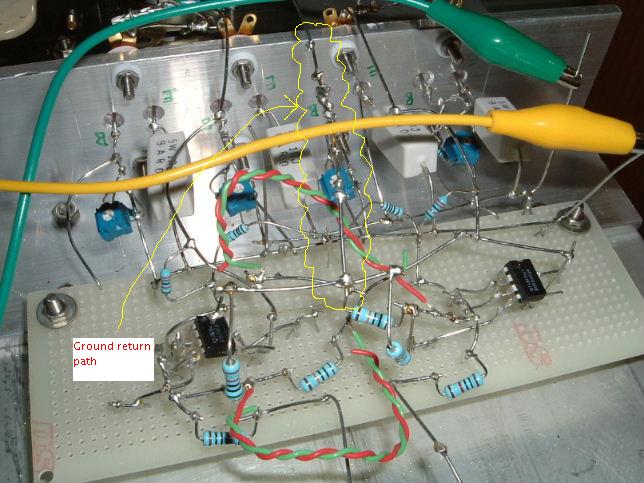

Monolithic SuperSymmetry with Current Feedback
You could read from this picture how hard I was struggling with the grounding--soldering, resoldering, resoldering... 🙂
JH
Re: I easily could be wrong
Sawzall said:
but I thought in this amp was supposed to "float" with respect to ground? And with this assumption, DC offset was not material.
(This is as much a question as it is a statement....)
Well, the power supply is symmetrical about gnd. So, to get a nice max dynamic range signal with both polarities clipping at (almost) the same time, you want your output in rest to be zero volts. I mean, in the extreme, if you have a rest output of +5VDC with +/- 10VDC supplies, the max output voltage undistorted would be less then some 2VRMS. With the output at zero, you would get some 5VRMS which means more then 4 times the output power (just rough guesses, don't shoot me if I am 20% off).
But other than that, it will work, as was shown by several posts above.
Jan Didden

You know...
I know a lot about your circuit 🙄
- The schematic.
- It gets DC offset if you decrease some resistor values.
- Still more DC offset compared to other similar circuits 🙄
I do not stand alone with my opinion.
My amp sounds good with headphones, I have no speakers with passive crossovers to make another listening test.
I build a 20V PSU soon and try the amp on my plasma tweeters.
Ringing - singing - overshooting may look better in my circuit because of the 100 ohm resistors.
Otherwise I have to do compensate the OPs too, or look for other ones which are not so fast.
By the way, in your circuit the ground connection we were talking about, is made also: the 100ohm that go from output to ground, IMHO useless and on the wrong place.
Should be on the -inputs.
But honestly, I'm just a bloody beginner in amp design... :clown:
Bernhard said:
May be the supersymmetry operation (who understands that :scratch: ) depends on the use of cfb OP.
Bernhard,
Super Symmetry is a concept. Concepts can be implemented with a large variety of components. I am not aware of the NEED for CF in these circuits, although as shown by you and JH it is POSSIBLE to use them.
Don't make it more complex than it is. Opamps don't "know" in which circuit they are. They are a one-trick pony: they only try to adjust their output voltage so that their input voltages are (pretty well) equal. If you look at it that way, your (and JH's amp) is really not that difficult to understand. Start to assume that the opamp's + input is higher than the - input, and work from there.
You will also appreciate that CF or VF may make a difference on how easy or difficult it is to implement what you want, but the CONCEPT is the same.
Jan Didden
