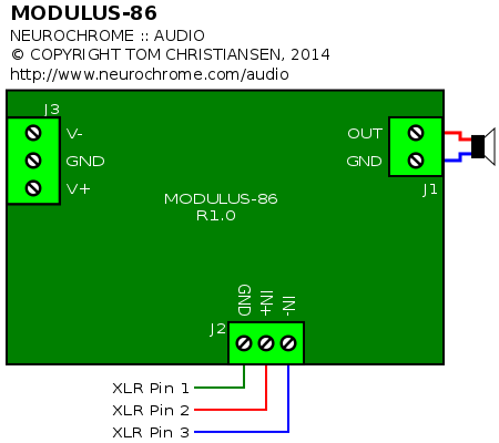

Mmm, stopping shield at the chassis is one option. So is continuing shield to the board if one's concerned about noise pickup within the chassis. The latter makes sense for helping get the most out of a fairly low noise amp like the Modulus-86 but does want a board which distinguishes between chassis/shield/earth/green wire ground and power/signal grounds off the secondary. I think that's the case here---the circuit topology diagram has a different ground symbol on the signal input than the power input or speaker output---so most likely it's a labelling issue with the figures in post 86.
If you want the EMI/RFI filter to work, you have to provide a ground for the RF return. If you prefer that XLR Pin 1 connects to only the EMI/RFI filter and the chassis, you can pluck a wire link off the board. However, you do need to ensure that the common-mode voltage of the input is within the common-mode range of the input amp - just as you would for any other differential input.
At the very least, continue the shield (connected to Pin 1) all the way to the input connector as Twest explains above.
I'll update the figures to rename the Pin 1 ground on the board. That should clear up some of the confusion.
Much of the optimization of the board involved optimizing the various grounds to ensure the best signal integrity possible. Sadly, my figure labeling skills aren't up to par with my circuit design skills...
~Tom
~Tom

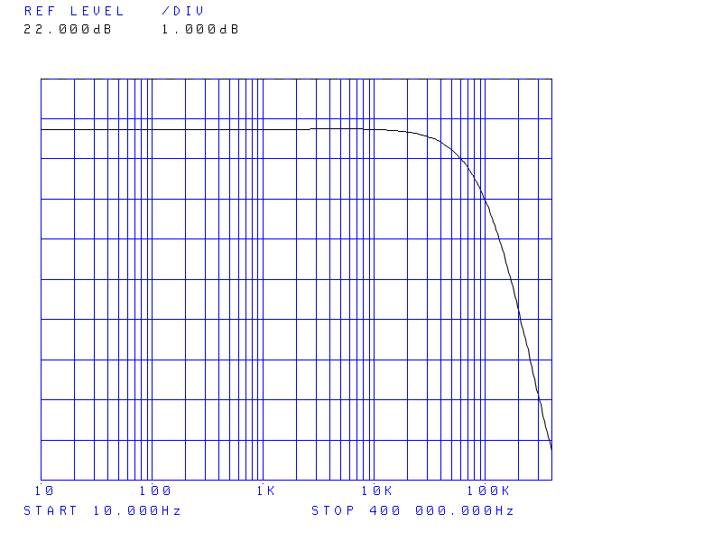

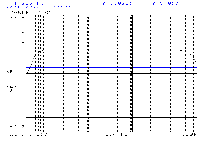

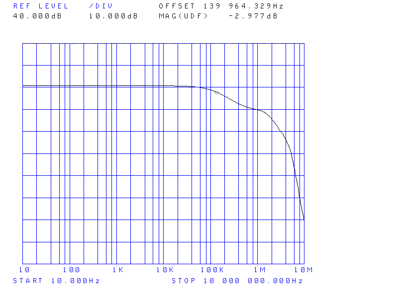

Frequency response measurements
Not to change the subject, but I got curious and measured the frequency response. That was a bit interesting as the LF -3 dB frequency is 1.6 mHz. That's one cycle every ten minutes... Needless to say, I started the analyzer and went to bed...
Now the HP3563A only goes to 100 kHz, so to get the HF -3 dB point, I resorted to a network analyzer. Hence, the units are different between the two measurements. The LF measurement is in dBV and the HF measurement in dB (gain). Thankfully, 3 dB is 3 dB, so life is good.
The bandwidth of the Modulus-86 extends from 1.6 mHz to 140 kHz (-3 dB). The amplitude variation within the audio band is ±0.04 dB. That's approaching the measurement tolerances of the network analyzer.
~Tom
