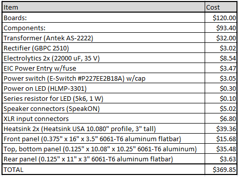

I appreciate the effort and engineering that went into this interesting design. Buy for a diy effort it is expensive. $220 for boards and parts, by the time you add the PSU, case, and incidentals you're at around 500 bucks. I'd love to give it a try, but limited budget.
On the topic of price, $299 + $25 shipping in the US, buys the LM3886 based GT-101 kit. In my opinion, its quality is excellent: solid chassis, three quite large and heavy extruded aluminum heatsinks, beefy power switch, nice binding posts, Avel Lindberg 240VA toroidal transformer, good fit & finish. (Why three heatsinks? Because it also includes a regulated DC power supply (!) and the third heatsink is for the big whomper power MOSFETs on the regulator PCB). The schematics and build guide are online, Google will find them easily, if you are curious.
To me, a zip-a-dee-doo-dah circuit improvement on the basic 3886, feels like it is worth maybe an extra hundred bucks or so. To me.
Attached is what I would consider a reasonable build budget. I went a bit overboard on the chassis with 6061-T6 aluminum rather than the less expensive 2024. It would probably be less expensive to use one of the chassis available from the outfits in Hong Kong.

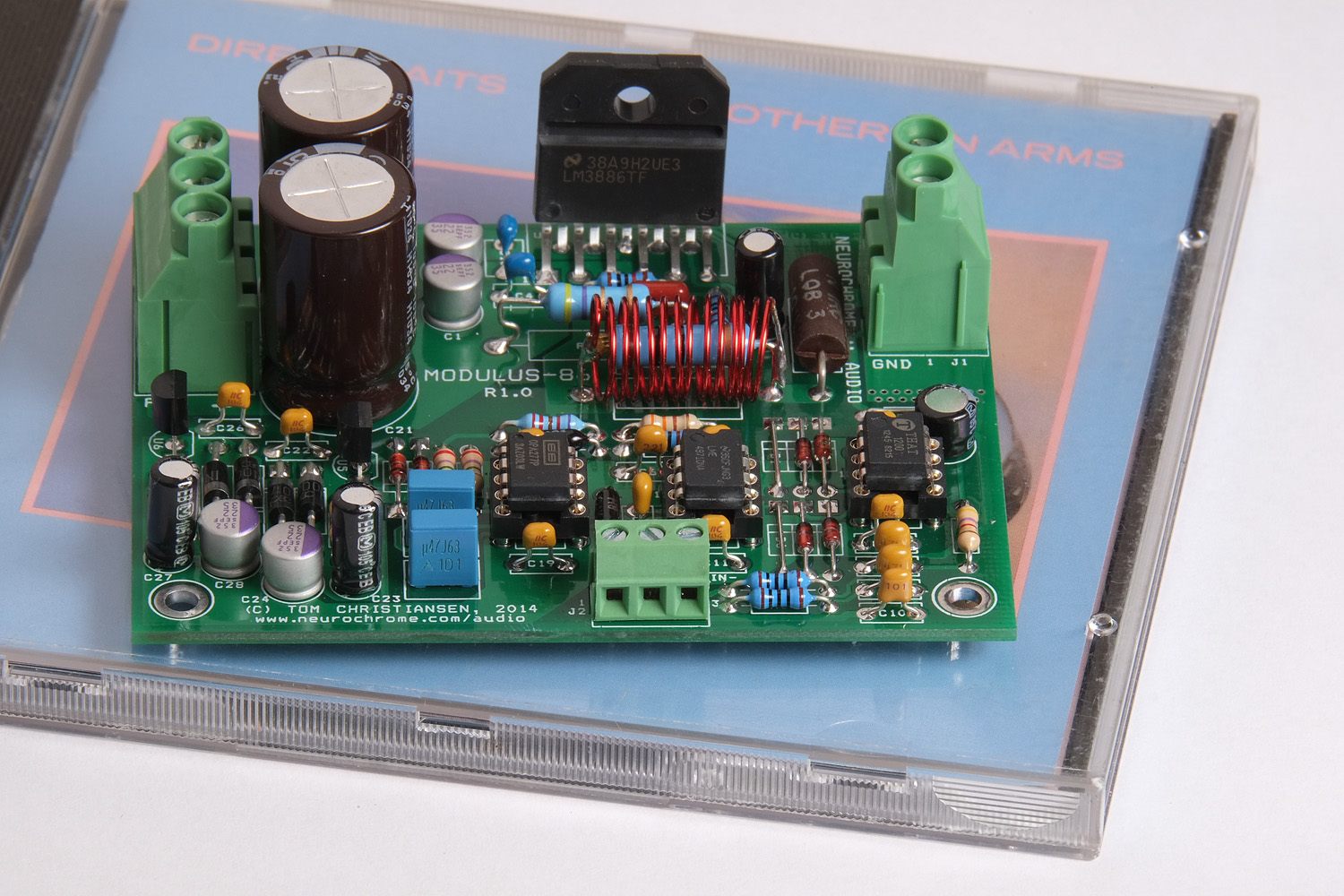

The less expensive amplifier options I've seen so far have all been basic LM3886 amps. I am offering a composite amplifier that beats the performance of a typical LM3886-based amp by an order of magnitude. In addition, it offers dramatic reduction of hum, differential inputs, easy bridging and paralleling, etc. I have pointed to this many times now. If the features and performance of my design have no value to you, then I can't help you.

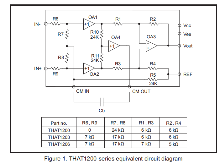

... there are three different gain versions ...
Yes I suppose that modifying the DC gain of the front end stage, while keeping the global feedback ratio constant (around the entire composite amplifier), does allow fine-grained tailoring of the Bode plot at the far left hand side. All three variants of the IC appear to have the same input impedance.

It just occurred to me that an excellent answer to the question, "Why socket the THAT chip?" might be,
Because I suspect that some of my customers will socket it. I want to test it in this configuration, just in case the extra parasitics from the socket affect the measurements and/or listening results.

Can I ask why the output power is only 25W?
I have both 3886 and 49710/20/40. Also the 22V 'new' LM (i forget the pn). I would've hoped for slightly more power.
I used sockets for the ICs to be able to test the circuit in blocks rather than have a Big Bang test.
By pulling the THAT, I can test the composite part of the circuit alone. Pulling the LME49710, I can test the LM3886 alone. Pulling the OPA277, I can test the circuit without the DC servo. This is pretty handy for debugging.
Also, as you point out, I wanted to make sure the circuit worked well with the added parasitics from the socket.
I have been recently been dipping ny toe into the basics of composite amplifiers.
It's totally worth it to go the composite amp route! It's the most direct route to getting good performance from the chip amps.
The output power is dependent on the power supply voltage. The lab supply I was using is limited to 30 V and the "real supply" (toroid + rectifier + caps) was using 35 V capacitors. So I was in a pretty tight spot.
I went back and looked at the data from a previous measurement. That shows the Modulus delivering over 35 W before clipping. This at ±28 V. I think in my most recent setup (that I've shown measurements from), I didn't have a good enough connection between the LM3886 and the heat sink and the power is limited due to the SPiKe circuit protection circuit in the LM3886 engaging.
You should be able to hit the same power numbers as listed in the LM3886 data sheet, provided that the LM3886 is very well heat sunk.
