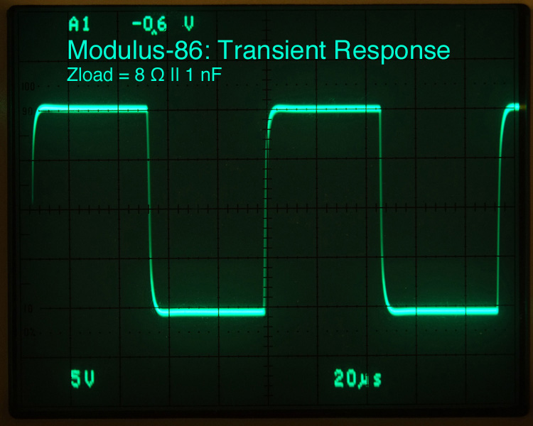

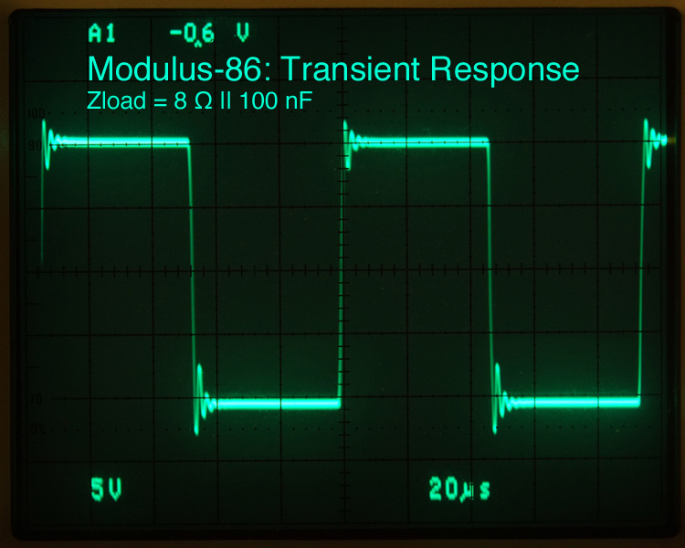

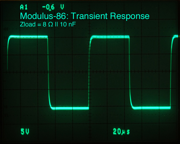

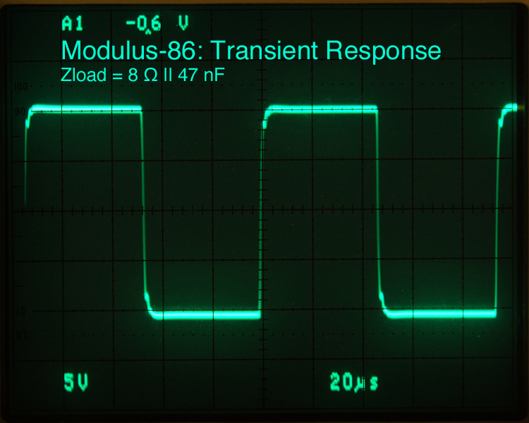

I noticed I forgot to include a title/legend on the oscilloscope shots of the transient response in Post #19. Please find annotated scope shots attached.
~Tom

So, as the power goes up, the dynamic range increases WRT the noise floor. So if the amplifier distortion does not increase in concert with the power level, one can see what is an apparent decrease in THD+N with increasing power.
