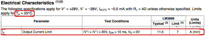

11A from a 3886? I'm probably wrong but i thought more like 3 A was more reasonable in practice.
Datasheet says 11.5 A (typ), 7 A (min). It's in the spec table, hence, tested in production.

The 3886 is specified by National as >=7A maximum output when Tj is 25°C
Um, no. It's min. 7 A at an ambient temperature of 25 ºC. 11.5 A typical. This means that if you grab a random part in the tube, you're pretty likely to get one that can deliver 11.5 A. But National/TI won't throw a part away as a test failure unless it falls below 7 A. I've attached an excerpt from the data sheet table for your convenience.

That is the part of the specification I was referring to, when I said:
The minimum value for the maximum current when Tj=25°C is 7A
That is the peak value for a low limit device when passing an AC signal.
Yes it can be much higher and usually will be as specified by the typical value of 11A. Again that is a peak value for Tj @ 25°C
