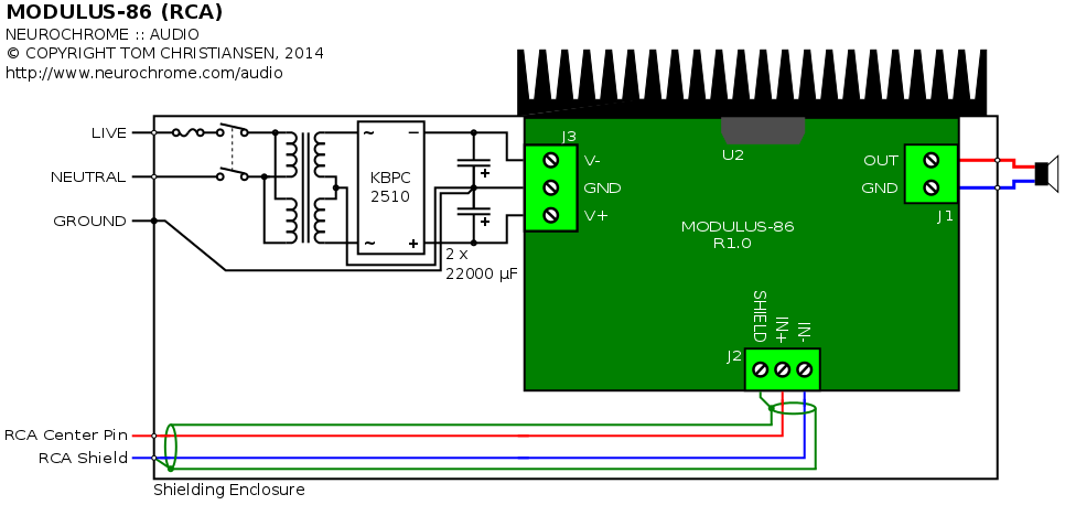

What are the recommendations for the power supply?
±28 V. I was using a toroid mains transformer, KBPC 2510 rectifier bridge, and 2x22000 uF, 35 V electrolytics for my testing. Worked well...
There appears to be no speaker protection circuitry but without a schematic it's hard to tell. What happens if the LM3886 output shorts to the V+ or V- supply rail?
As Twest points out, if there was a protection circuit, it would have been included in the block diagram and the verbiage of my website. There are many circuits out there that will provide protection in the event of excessive DC voltage on the amp output. I suggest using one of those. I didn't see any reason to reinvent the wheel. Also, as my boards are set up for easy paralleling, bridging, and bridge/paralleling, the speaker protection circuitry is better addressed as an add-on board.
The problem here is that the LM3886 has been used for quite some years, and implemented in dozens of DIY amp's. It would be nice to see what exactly Tom's implementation is going to offer.

Updated wiring diagram showing the connections at the XLR connector, power supply, and heat sink.
