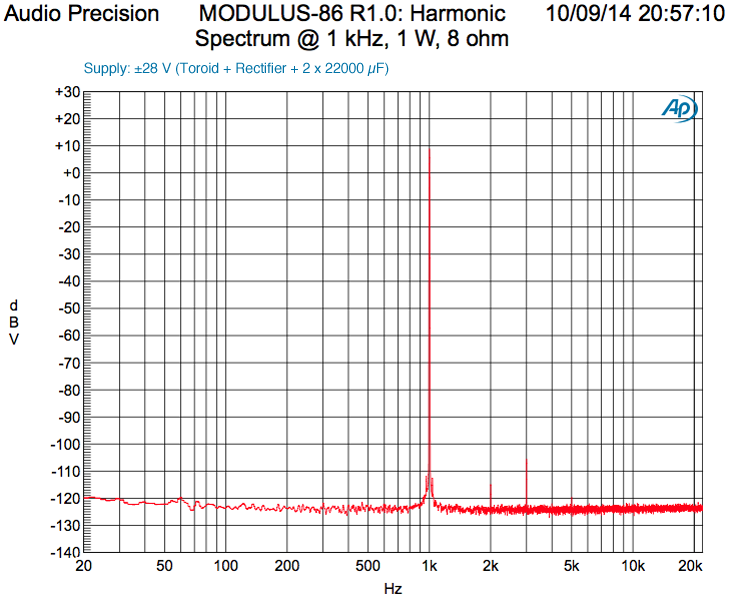

I decided to camp out in the lab tonight rather than tomorrow. I have SMPTE data as well as updated measurements of the THD+N vs power and at higher output powers. I now get 35+ W into 8 Ω. I took some measurements of the harmonic spectrum to get the THD rather than the THD+N.
The THD at 1 W output power comes in at 0.0002 % (-115 dB).

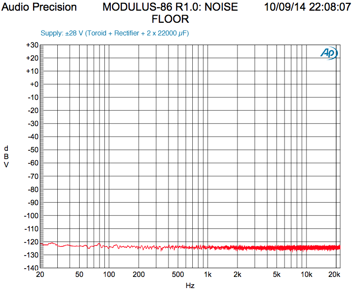

A measurement of the noise floor is attached. This is measured without any kind of shielding and using a real power supply (toroid + rectifier + 2x22000 µF).

And the 5th harmonic is the highest order that pops out of the noise floor. 4th order is long gone. Not too shabby! 🙂
Pretty darn good, if you ask me. But, of course, I may be "slightly" biased... 🙂
The all low-order (mostly 2nd and 3rd harmonic) distortion reminds me a lot of the distortion profile of a typical single-ended triode amp, except, the THD is much, much lower in case of the Modulus-86.
