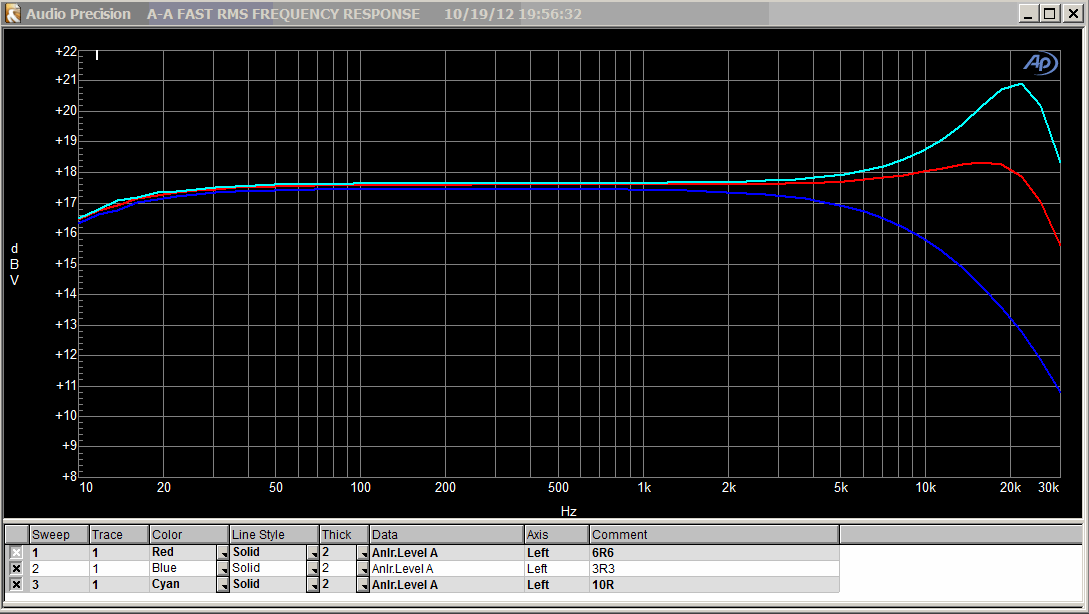

Not sure what you mean, measure in-room frequency response with the same speaker using different amps, after some sort of basic level matching?Hmm, how often do you do A/B SPL measurements between amps?
If so: No, I don't. That's way too indirect a measurement to me. I do measure amps with varying (resistive) loads, that's required to get full power specs anyway so I measure frequency response while I'm at it.
And as I said, unless we're talking Class-D with post-feedback output filter there's nothing to see, a fraction of a dB at most, normally very much less.
Attached find a plot from a rather cheap small commercial Class-D of the 'bad' kind which requires a certain resistive load to obtain flat response in the treble.
One can see both the influence of less or more than optimum high frequency damping (Q) of the 2nd-order LC filter as well as the influence of DC coil resistance (giving about 0.4dB wideband difference) which limits output resistance.
