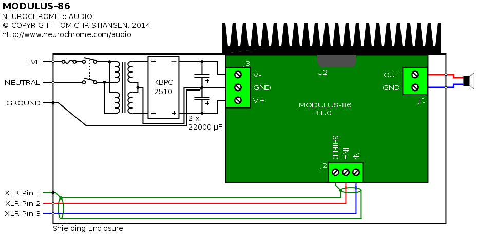

This is the schematic I posted in Post #125. This is what I'm using for the lab testing. Variac omitted for clarity.
In my final build, I'll use a Connex Electronic SMPS300RE.

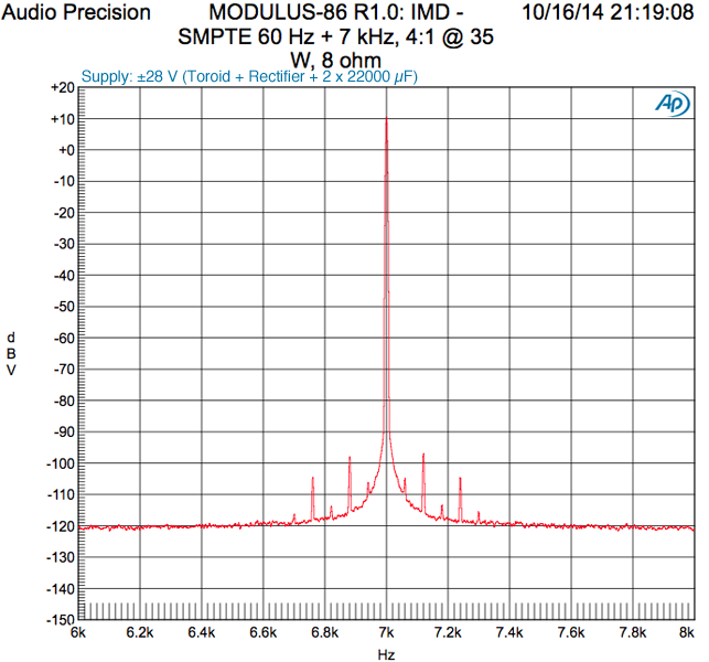

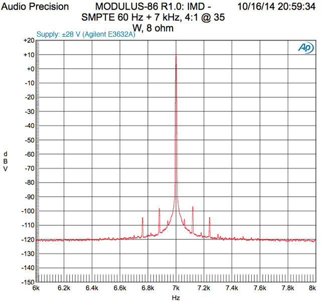

IMD measurements attached. This shows the SMPTE 60 Hz + 7 kHz at a 4:1 ratio. The 7 kHz fundamental and the IMD products are shown. This is quite possibly the only area where the Modulus-86 shows a teeny-tiny bit of difference between using a lab supply and an unregulated supply. The difference is small, however.

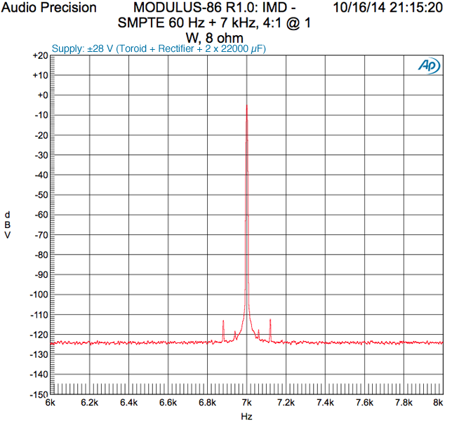

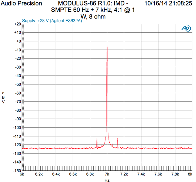

Measurements at full output power (35 W) and normal-high listening levels (1 W) for both unregulated and lab supply are shown.

The even harmonics of the 60Hz seem to be about the same for the two PSUs.
The odd harmonics are very slightly less with the agilent.
I have noticed this with mains harmonics attenuation in a conventional PSU.
The odds are often worse than the evens and 3rd is very often the worst.
Is there some correlation here between IMD and Capacitor input filter?
Could the 60Hz mains be confusing the 60Hz test signal?
What about 70Hz and 7.1kHz as the IMD test signal?

Well... Let's take a look. The IMD products at 180 and 300 Hz offset degrade by 2-3 dB when an unregulated supply is used. The remaining IMD products are from the amplifier itself.
The supply-induced IMD is 10+ dB below all the other spurs, which are 120 dB down from the 7 kHz stimulus and 132+ dB down from the 60 Hz stimulus to start with. There's no issue here, hence, no action is needed.
This measurement speaks volumes to the ultra-high performance of the Modulus-86 amp, both in terms of the IMD performance of the amp and the supply immunity of it.
The analyzer isn't getting confused. It just reports what's on the output of the amp. It's then up to the circuit designer to interpret the result, which is why I provided measurements using both regulated and unregulated supplies.
