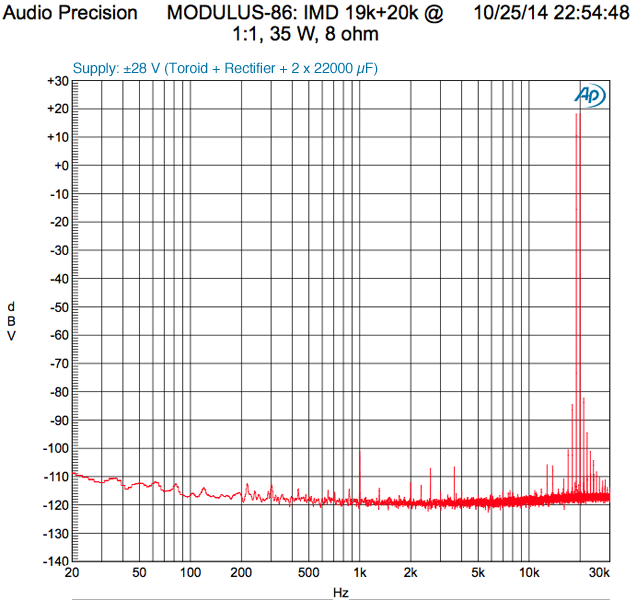

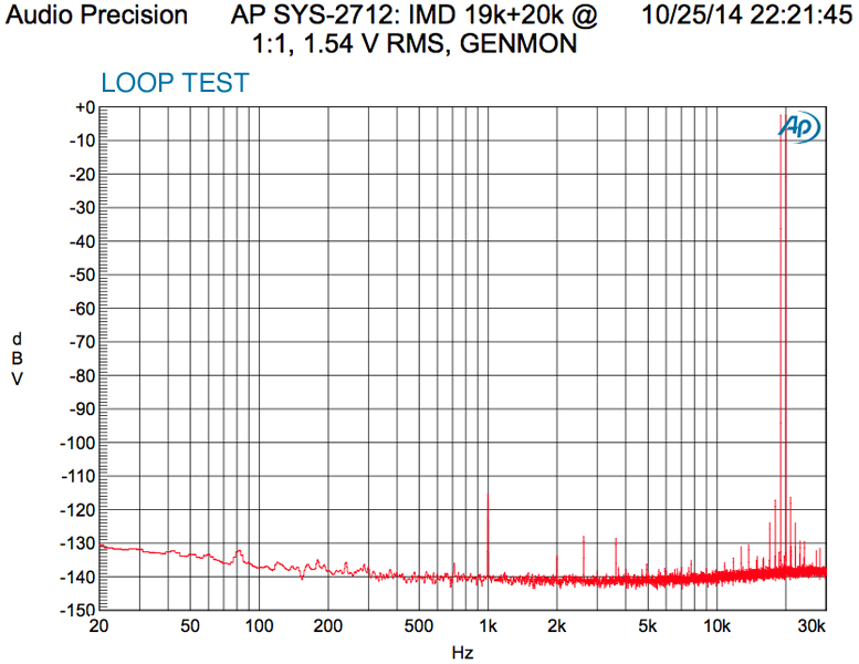

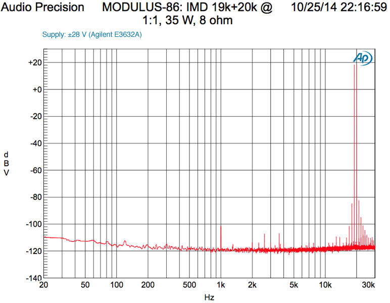

The long-awaited 19k+20k IMD measurements are done and attached to this post. Note that the IMD of the AP SYS-2712 itself is actually responsible for most of the IMD measured on the Modulus-86.
The first plot shows the IMD of the AP itself. I used the generator monitor to measure the IMD of the generator and analyzer combined. The two other plots show the IMD of the Modulus-86 (and the AP). Comparing the loopback test to the tests of the MOD86, by comparing the relative amplitudes of the two stimulus frequencies and the various IMD products, reveals that the 13k, 14k IMD components are up about 5 dB to 125 dB below the stimulus amplitude and the IMD components at 16k, 17k, 21k, and 22k are up about 10 dB. The worst offenders are around 105 dB below the stimulus signal. That's 0.00056 % IMD.
Aside from some 60 Hz related components, some 135 dB down from the stimulus at 19k+20k, I'm not noticing any meaningful difference between the performance of the Modulus-86 on the lab supply versus unregulated supply.
This is pretty darn good if you ask me.
