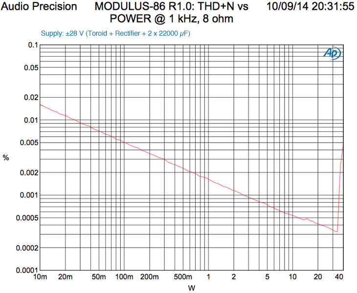

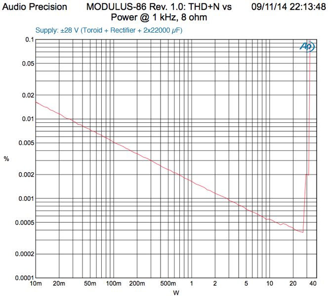

Attached to this post are two plots. Notice how the max output power in one plot is about 28 W, whereas the other goes to about 35 W.
In the first plot, I used a SilPad between the LM3886TF (isolated package) and the heat sink. I didn't want to deal with the mess of thermal grease and figured the SilPad should be good enough. The result is that the amp only provides about 28 W before the LM3886 overheats and the SPiKe kicks in.
In the second plot, I applied a thin coat of thermal grease between the LM3886TF and the heat sink. With the better thermal contact, I'm now able to drive the amp to clipping without overheating the IC.
I will encourage those who would like to understand the thermal design to take a look at my Taming the LM3886 - Thermal Design page.

When taking the plots I posted in Post #281, I measured the case temperature of the LM3886 while the AP performed the power sweep. The case temperature hit over 125 ºC near the end of the sweep. This while mounted on a 0.4 ºK/W heat sink (about 1 kg of aluminum, 10 mm thick with 25 mm fins 150 mm tall).

However, if "full blast" means peak power dissipation on ±25 V rails with a 4 Ω load, 34 W will be dissipated in the LM3886. The output power in this case is about 30 W. The temperature of the heat sink will be 25+1.7*34 = 83 ºC, assuming the heat sink is external and that the room temperature is 25 ºC. The die temperature will be 2*34+83 = 151 ºC - the SPiKe system will engage. 83 ºC is not safe for an external heat sink... It will result in instant burns if touched. You can move the heat sink inside the chassis, but without forced air cooling, the temperature inside the chassis will be considerably higher than the external air temperature, even with good ventilation. This results in an even higher die temperature.
Above math assumes 2 ºK/W thermal resistance from the heat sink to the die, which, based on my experiments with the isolated LM3886TF, is very optimistic to say the least.

"Full blast" means at least two quite different things and depends totally on the operating conditions.
Sinewave testing to maximum unclipped power is one operating condition.
This appears to be what the two graphs are showing when the distortion suddenly skyrockets @ ~28W or ~35W, post281
That is clearly "full blast" and shows that the chipamp is limited by the Rth c-s of the case to sink interface.
