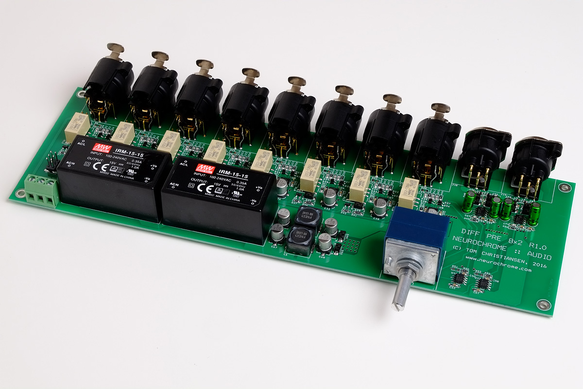

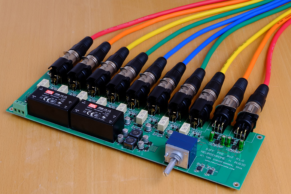

Hi Tom
I see you are listing a new pre-amp on your site.
Differential Preamp 8×2
Are you going to tell us a bit more about it?
Hi Tom

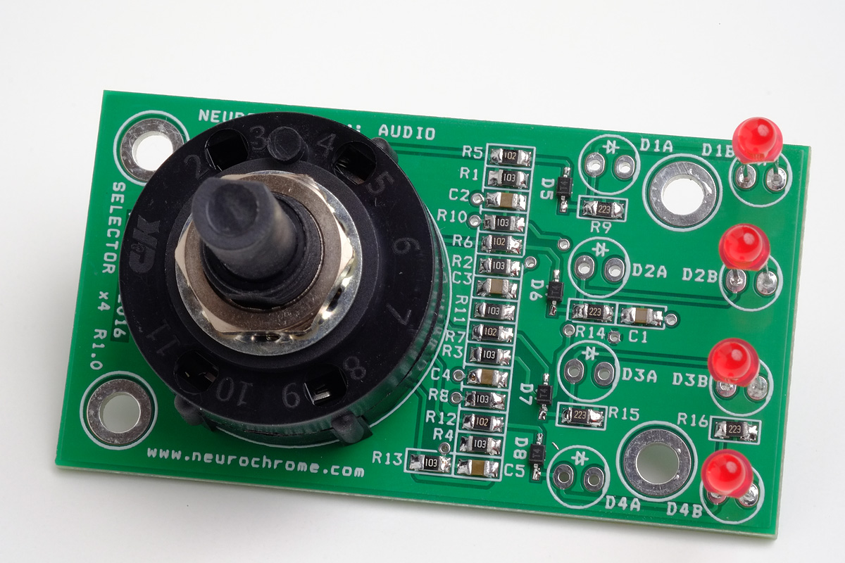

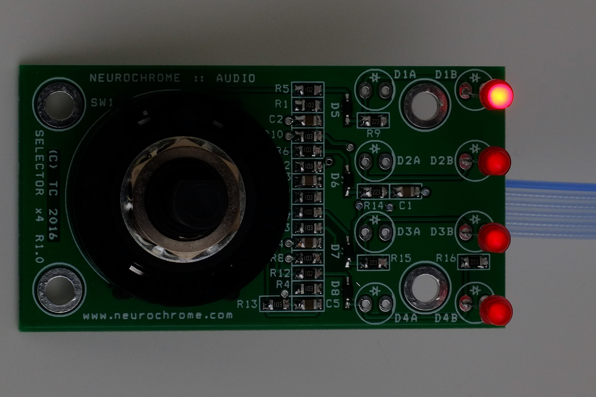

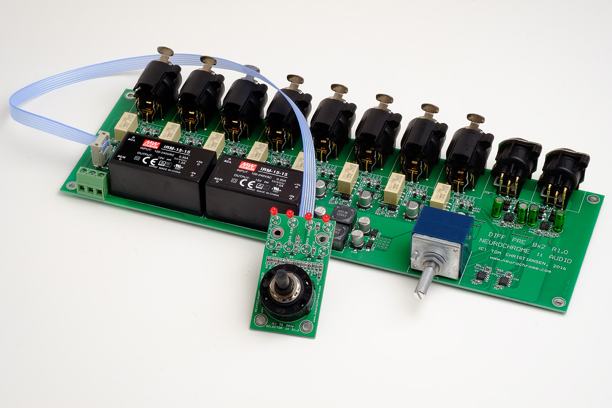

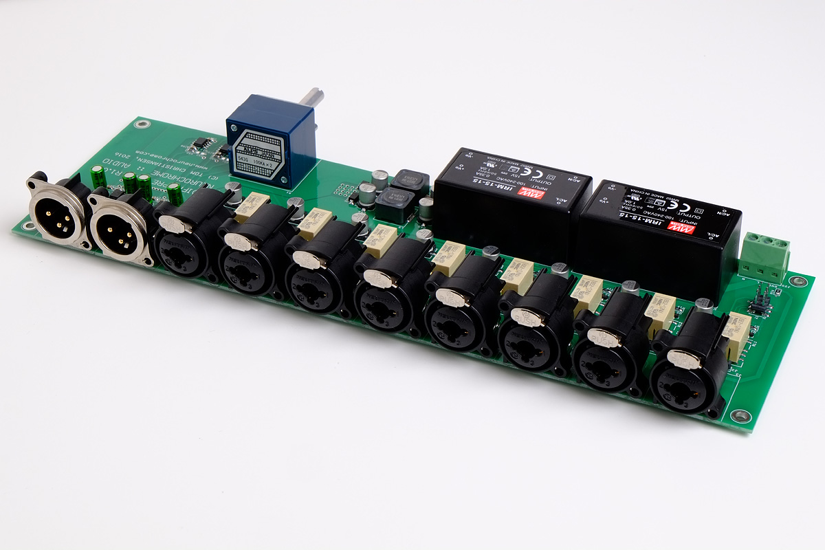

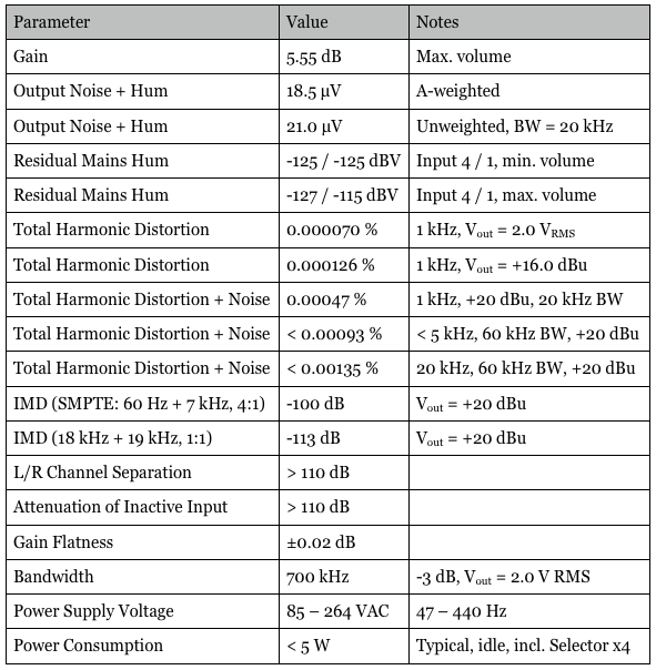

Nah... I figured I'd hide behind my smoke screen for a while...
Eight differential inputs, two differential outputs configured for four stereo in, one stereo out. Input selection by small-signal relays with gold plated contacts. Alps "Blue Velvet" volume pot. On-board regulated and filtered power supply that takes international mains voltage (85-264 VAC, 47-440 Hz) in. Board size: 10.800 x 3.500 inches.
The little selector board measures 1.300 x 2.400 inches and is designed to be able to fit in a 1U rack mount chassis. The LED for the active input glows brightly and the LEDs for the inactive LEDs glow subtly, creating a nice visual effect on the front panel.
Some quick measurements:
THD+N: Limited by the THAT chips
Noise floor (256K FFT, 16 averages): -140 dBV (give or take)
Channel separation, 1 kHz: Can’t measure (below the noise floor)
Output noise + hum, RMS, IN 1: 22.0 uV (unweighted)
Output noise + hum, RMS, IN 4: 21.5 uV (unweighted)
Output noise + hum, RMS, IN 1: 18.9 uV (A weighted)
Output noise + hum, RMS, IN 4: 18.5 uV (A weighted)
I expect to have some actual specs and description page on my website by the end of the coming week. I've attached some eye candy for you to drool over.

And suddenly the thread springs back to life. I was afraid my awesome preamp specs left everybody speechless. I added some more specs on my Differential Preamplifier 8x2 website.
