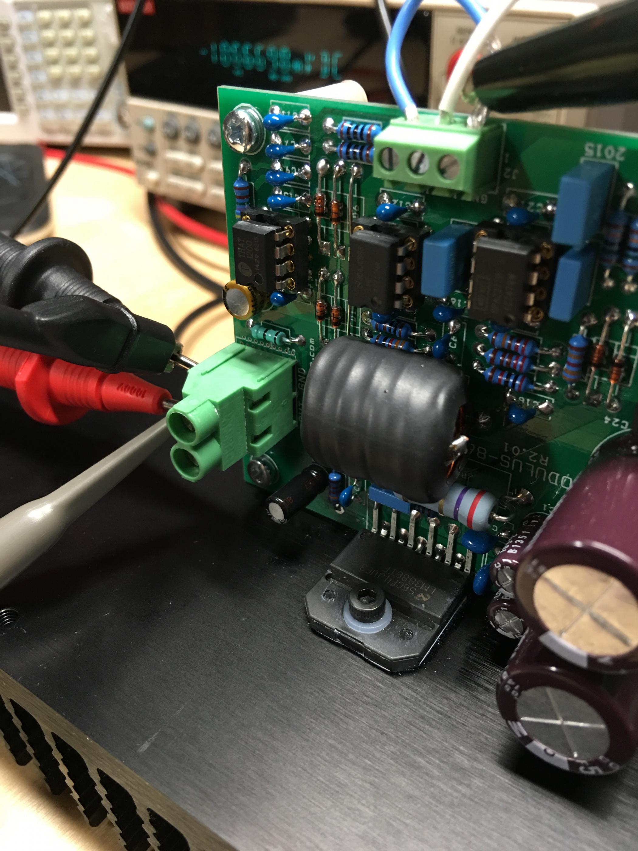

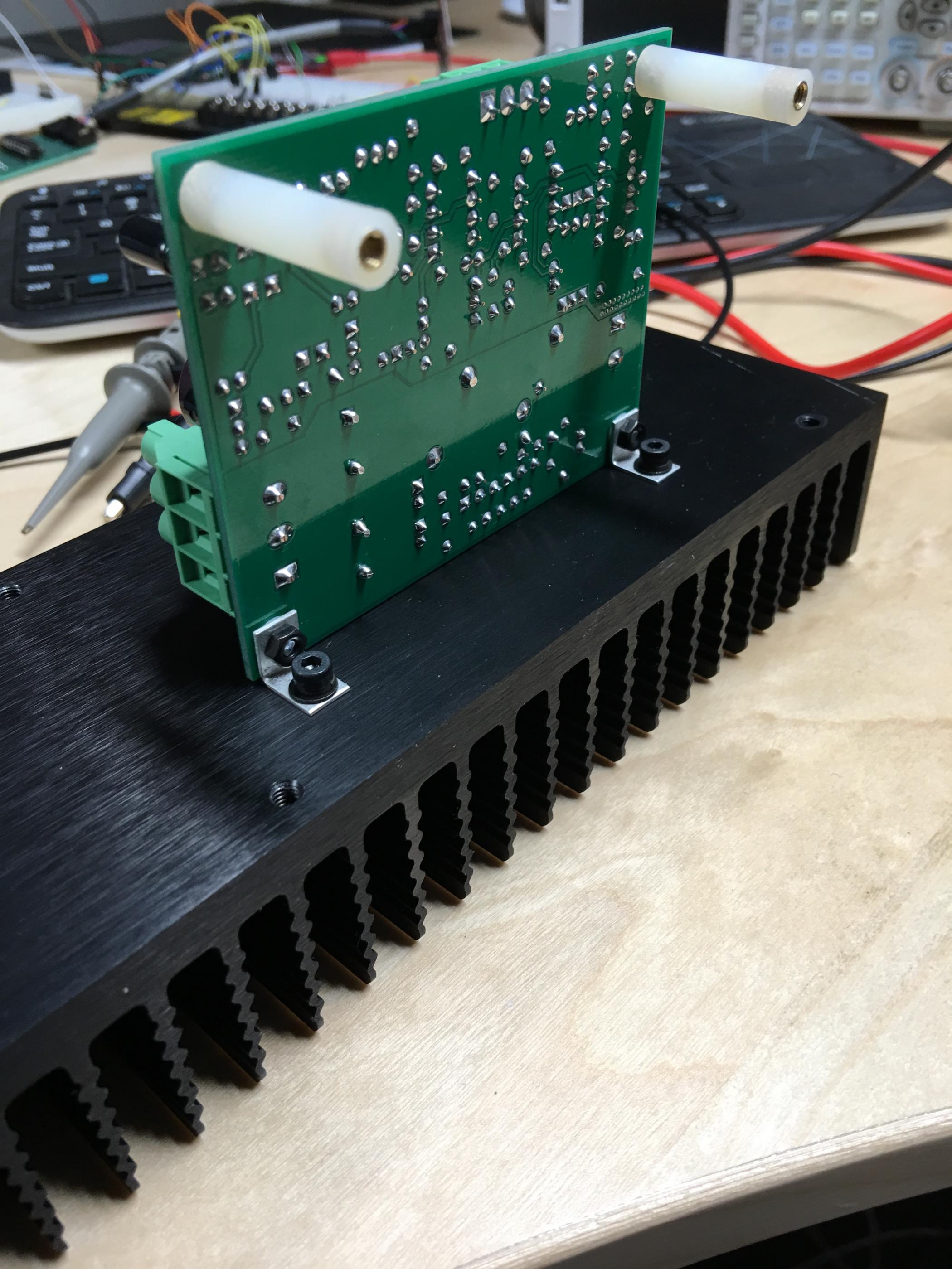

Since we are on the topic, I mounted the LM using 10mm M3 socket cap screws, 2.5mm tap drill, and tapped all the way through the heatsinks of a HiFi2000 Mini Dissipante. Used a drill press and Tap Magic to help out and I'm very satisfied with the result.
In addition, I added an M3 shoulder washer I threw in with a Digi-Key order. It fits perfectly with no wiggle and I feel better that I'm not bolting down directly on to the LM.
Finally, given the construction of my case, I could not place the PCB flush against the heatsink and use standoffs on the LM side of the board. The Mini Dissipante uses steel support frames to mount the heatsink and bottom and top plates and interferes with where the standoffs would be. To flush mount the PCB / LM, I bought some small angle brackets from Digi-Key. This allowed me to get everything mounted as needed.
