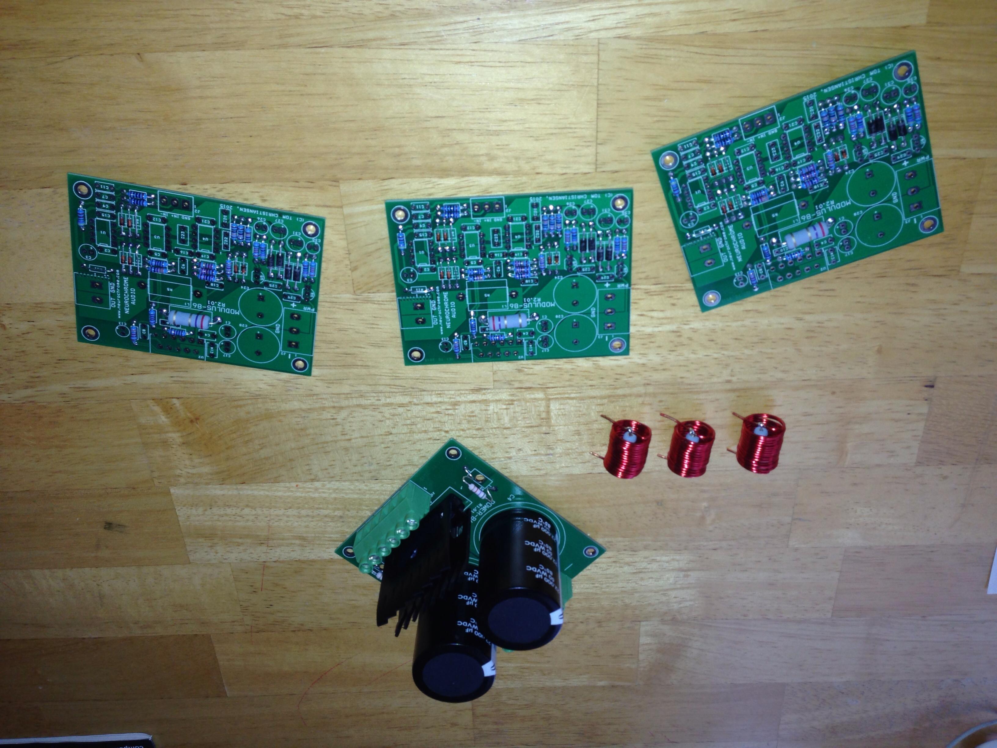

Building mod86 is taking a long time, but only because my schedule is so busy. I've really only spent a few hours so far, and I bet I only need a few more hours work. (Edit: well maybe I have closer to 8 hours into these. I think it's been a few times that I was able to sit down with it for a couple hours)
Originally I was going to build 6 amps, to triamp a pair of three ways. I've changed my mind on speakers though. 330 liter three ways are a little big for WAF. She likes the pictures of Frugal Horns though.
I have two heat sinks, two trafo's, so I'll get one more mod86 board from Tom, then I can decide if I want to run subs with FH, or split it into 2 stereos for 2 different rooms in the house.
I know what you mean about fast, it's a description I hear but it may mean different things to different people. I figured the 4" in FH3 would be faster because they're lighter, and can therefore start and stop speaker cone movement very precisely revealing every detail of the music signal. But that's only half the story, the amp must also operate with precision to have a tight control over the movement of the speaker cone. So that's my definition for what it's worth, sharp percussion, separation of instruments, etc. I'll be looking more at FHXL. I know there will be even less time smearing if I can do it without the need for sub, and it sounds to me like the transients are quick and accurate when Alpairs are paired up with Mod86. Good stuff

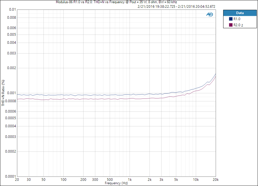

Modulus-86 Rev. 1.0 vs 2.0
One question that pops up on occasion is "how much better is the Rev. 2.0 than Rev. 1.0". I finally had time to dig out a Rev. 1.0 board and compare. The THD of Rev. 2.0 is a tad better than Rev. 1.0. You also get an additional 3-4 W of output power and 10 dB lower mains hum in Rev. 2.0. The most interesting plot is the THD vs Freq. which I've attached. The measurement was done at 35 W into 8 Ω to allow both revisions to be measured.
Tom

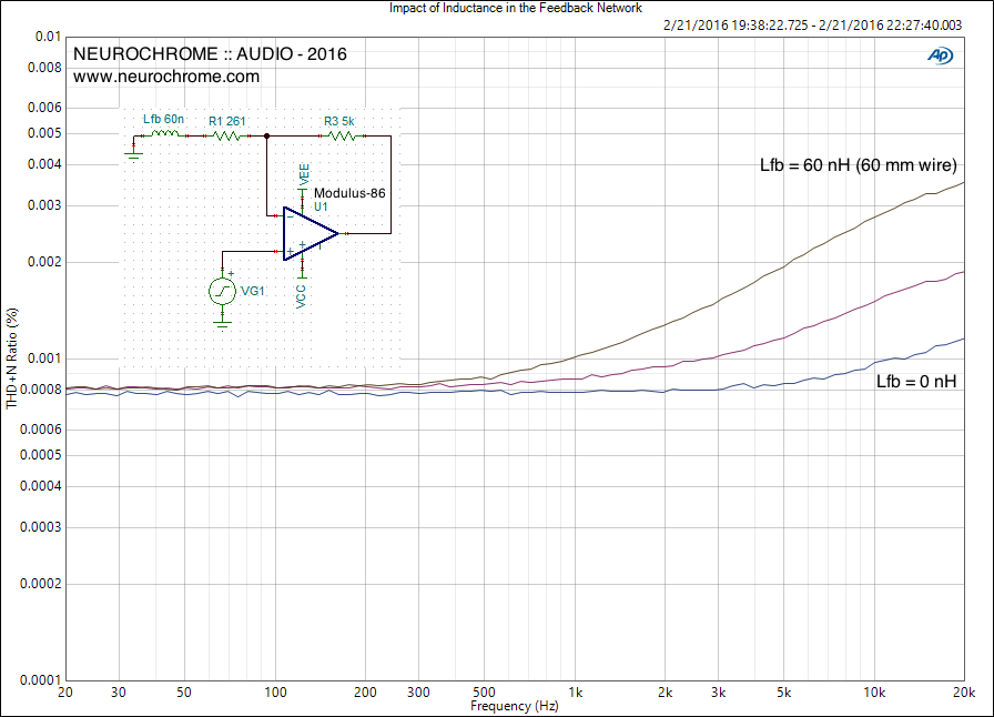

The Layout is the Circuit
Now that I was playing in the lab anyway, I decided to mess with the feedback network in the Modulus-86 Rev. 2.0.
For the few skeptics out there who doubt the impact of the PCB (or P2P) layout, here's some data. :)
The graph shows THD+N vs Frequency at 35 W, 8 Ω output. The bottom graph is the THD+N of the raw Modulus-86 Rev. 2.0 with the THAT1200 removed (as I said, I was messing around).
The dark magenta line in the middle shows the THD+N with a 1000 uF bipolar capacitor in series with the feedback resistor to ground. The cap was mounted with rather long leads and the added inductance causes the THD to rise at higher frequencies.
The top line shows the impact of 60 mm (a bit over 2") of AWG 20 wire in series with the feedback resistor to ground.
Layout inductance matters. Even at audio frequencies.
That's enough messing around for one sitting. Goodnight. :)
