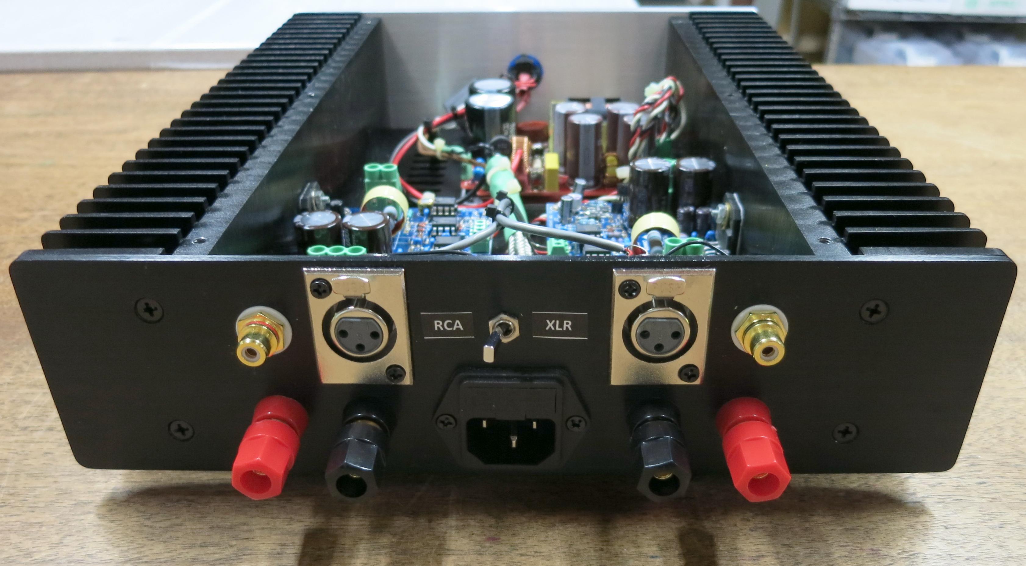

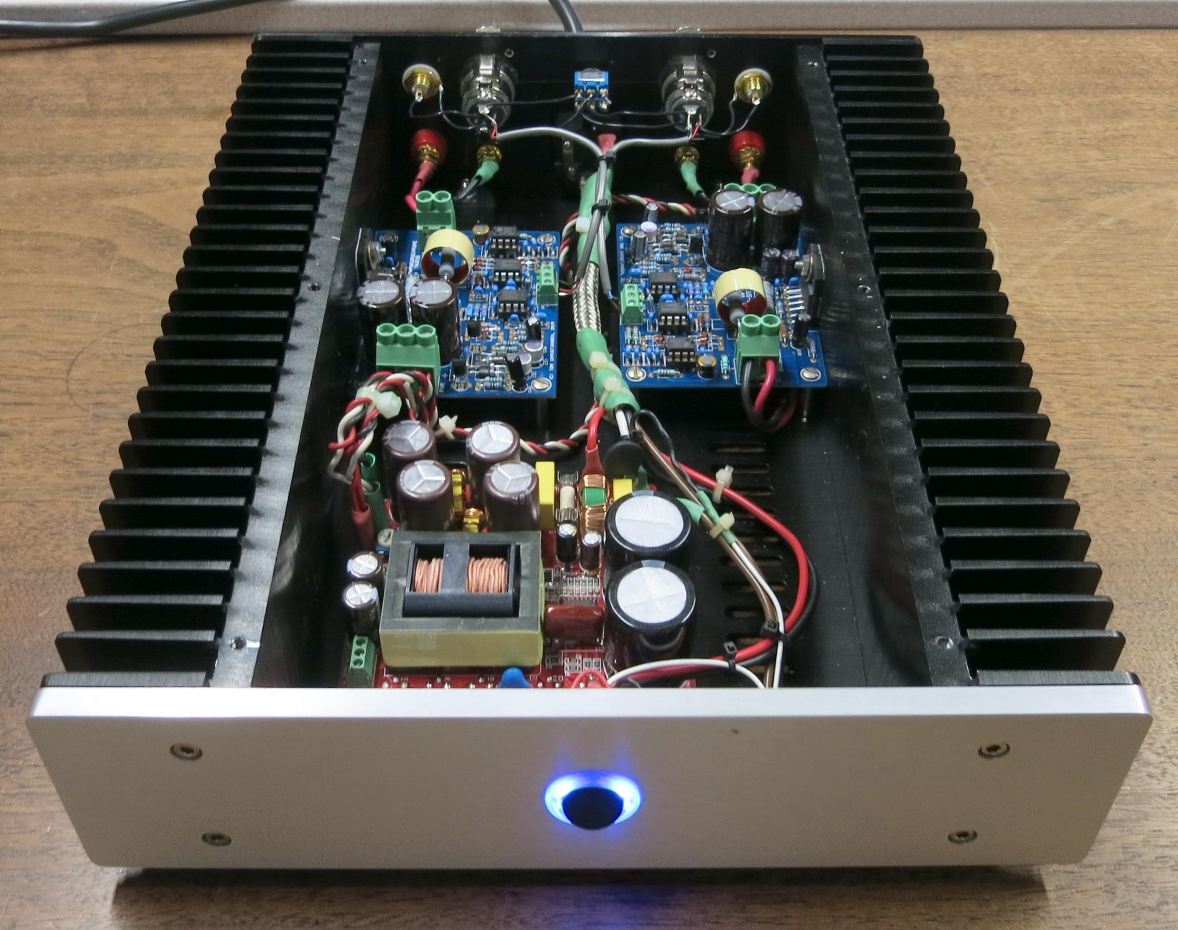

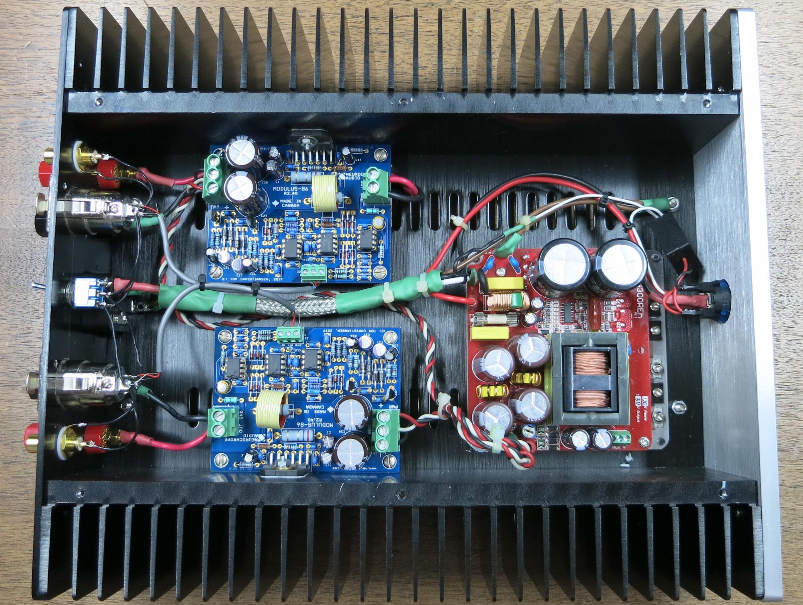

Well I finally finished my build!
Tom did a fantastic job with this amplifier design and DIYers who build and discover this amp are getting an end game build as long as it is powerful enough for their needs. What is surprising is how when the volume is increased, it does not start sounding compressed and "loud" due to distortion mechanisms. That will be the undoing of this amp because it sounds so good the desire to crank it up a little more is there.
Thank You Tom, best wishes in your future endeavours!

Thats a great build you have here, could you share some more pictures and focus on the connections rca, xlr ..
Im in the process of building mine and i'd like to have both chouce rca/xlr inputs, i just wonder how connections works.
What speakers do you fed? ,
Connection as per Tom
Modulus-86: Composite amplifier achieving <0.0004 % THD+N.
What I did was connect the RCA signal to the + on the XLR on the rear.
Then you connect RCA ground to the - on the XLR.
Then you place a switch connecting the Ground and - as the selection. I believe this is the way most commercial offering do it as well.
NOTE the caveat is that you MUST only connect one input connection at any given time.
Right now, they are driving some Polk Audio LSIM707s. A speaker that is known to dip into 3 ohms. I also turned down the SMPS300ReH to output 27.6 volts, the lowest available. That should minimize the SPIKE kicking in at low impedances.

What kind of wires are recommended for connecting the transformer inputs and outputs, the power module and the amplifier modules?
I sourced some AWG20 and AWG18 cables from an old tower PC but I don't know if the gauge is big enough and if solid core is preferred over stranded.
Also, from what I understand the transformer input and output should be twisted and preferably shielded.
Thanks!
Stranded vs solid: Meh. The electrons won't care, so use what you have handy. I prefer stranded because I find it easier to work with.
20 AWG would be perfect for the input, but is a bit skinny for the power supply and speaker connections. Some (me included) would prefer shielded cable on the input, though. I generally use microphone cable for this, though in my most recent build I used star quad cable.
I generally use AWG 16 for the speaker connections. Some may prefer heavier gauges. You can always use 2-3 18 AWG in parallel and just zip tie them together.
The wires on the transformer itself are generally long enough to reach. They need to be tightly coupled. I run them parallel and zip tie them together. I doubt you'd be able to get a tighter coupling if you twisted or braided them together.
