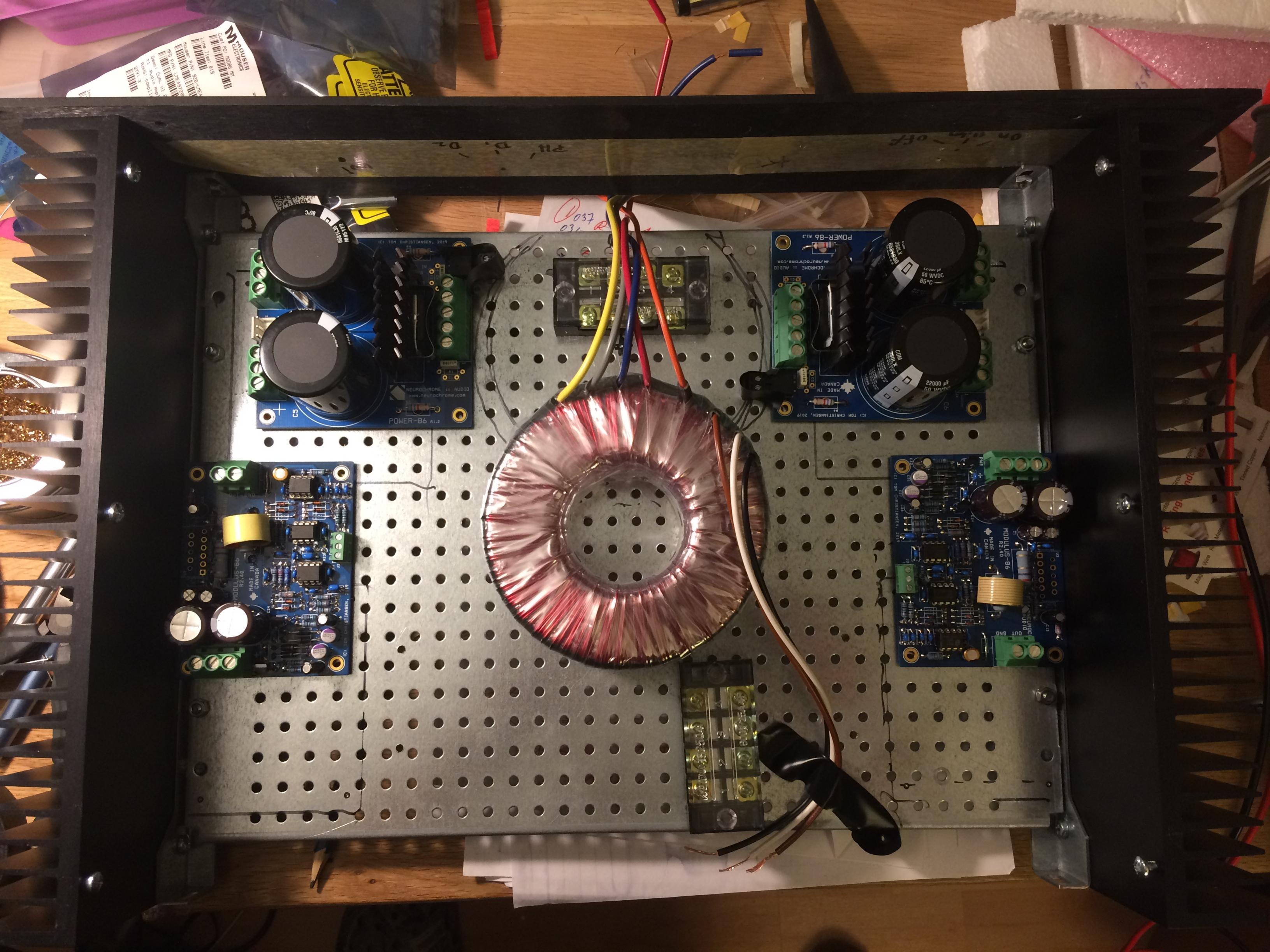

Hi Tom, Im on the last leg of my build, need some standoffs at minor items. Would this be an ok layout? Transformer primaries and seconaries will be short an in the middle of the cassis and amps placed almost in the middle for good cooling.
I would probably scoot the transformer closer to the front panel so the two Power-86es can come together behind it. That will keep all the AC wiring together. You can then run the input connections to the amp along the heat sinks.
Make sure you leave enough room in the back for the IEC inlet. They tend to take up a lot of space.
Looks good otherwise, though.
