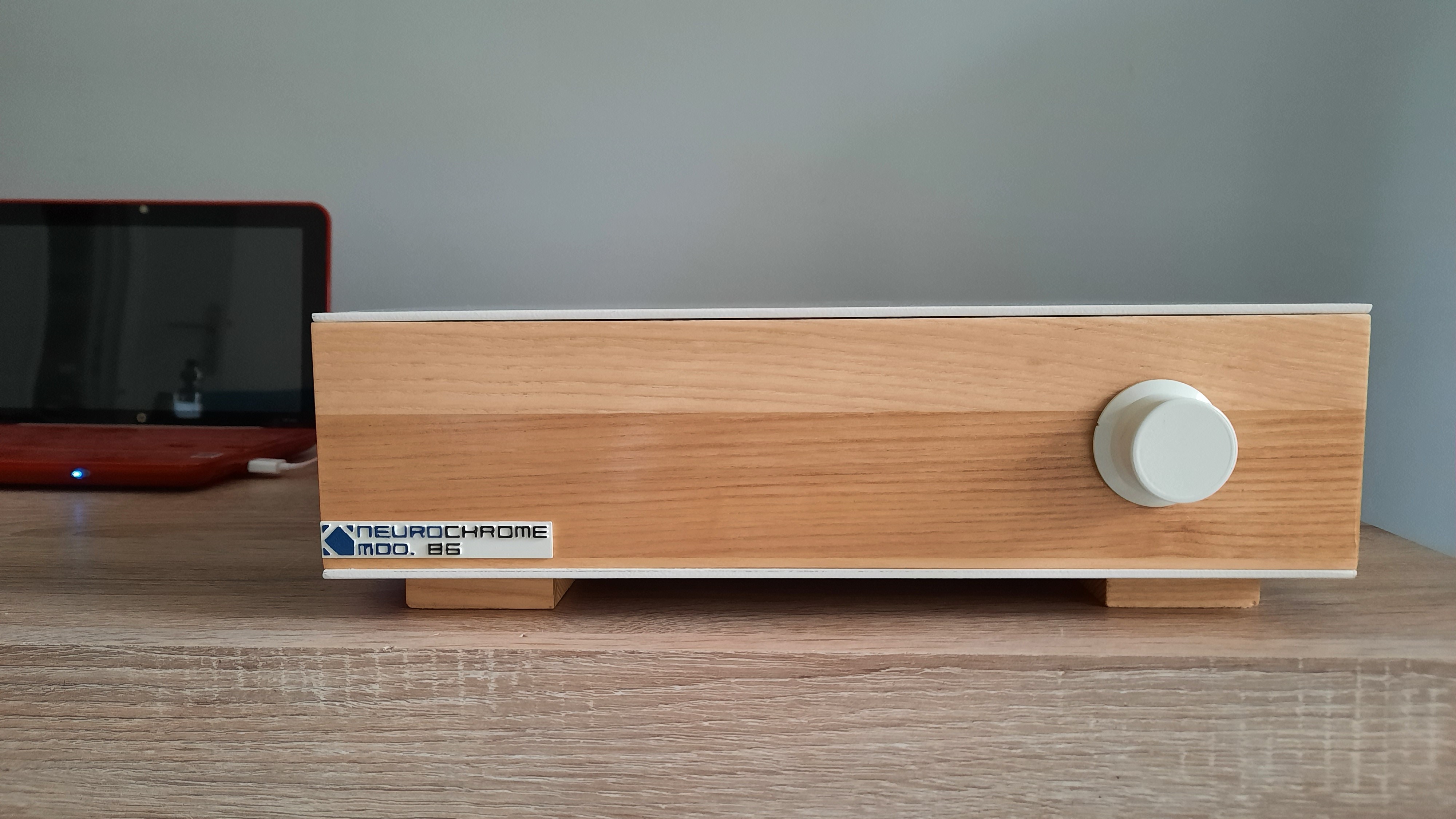

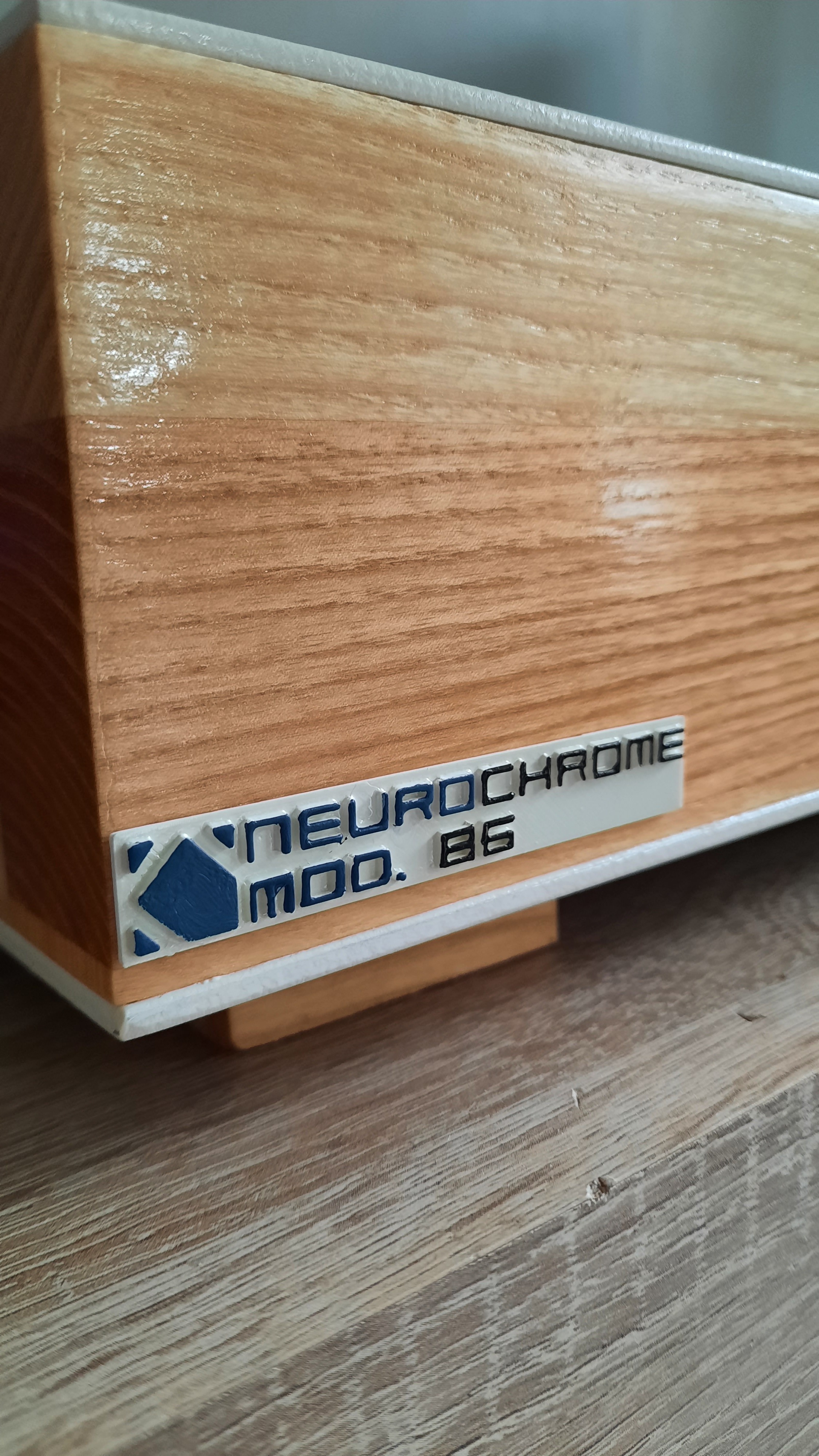

Regarding heat sinks on mod86, i can feedback my personal expenrience. I use some heatsink predrill from audiophnics 14cm x 6cm high, 1 cm thick ..these are more than enough in my opinion, it doesn't get hot after 3 hours use a normal listening volume .. i would say 30 degrees celcius... nothing to worry about or get stressed
Wooden case is simple and cheap if you alreday have on hand the wood as i did . I had aluminium plates too, that i nicely painted
Its dead silent, no interferences at home, i could improve on laying aluminium thin plates inwall though..
For my first ever build, i'm happy with end result and happy with sound it throw out
