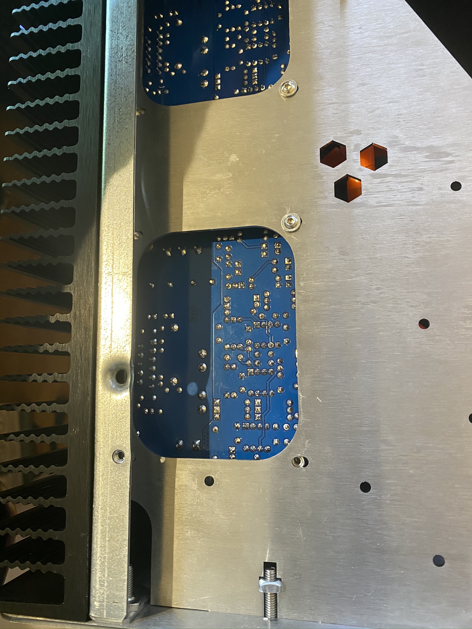

I've built all 4 amps now, and am getting ready to finish everything off, but have a quick question on testing. I did the first test, using 24V on Power+ and 0 on Power-, and everything dropped to 0mV after a few seconds.
Then applied the sine wave to the inputs, but got 0mV output on all 4 amps. I didn't have the final set of IC's inserted - should I? Will test again when I'm more caffeinated.
I also have a new laser cut base, and also did the back panel this time. It's all coming together nicely. Slotted the mounting holes for amps, so the LM-3886's are flat on the heatsinks.

That would explain it. All 4 modules worked.
Sweet!

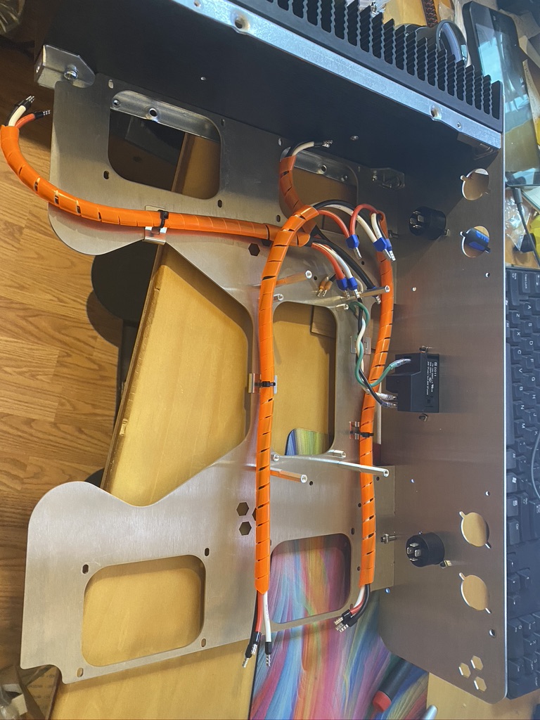

I'm building a 6-channel amp based on Modulus-86 amps. This is my first amp build, but I do have experience with electronics in general, including construction of modular analog synths from bare PCBs until the final product. So I just need a little bit of hand-holding for this amp because the world of home audio and some of the technical bits are just unknown to me and I have no idea what to search for on Google. I have gone through and read lots and lots of previous threads, but I still have questions because everyone's amp builds are all so different.
I put together a PDF diagram showing the basic layout of my system. It should be attached to this message -- it's only 86k so take a look before reading the remainder of this post. It's a functional diagram only, to make sure I'm accounting for all of the internal connections and connector parts. I do not show the entirety of the wiring between the Power-86 and Modulus-86 boards because this is basically "plug and play" and Tom's instructions are very clear.
I need help with three main parts of the build:
1) I'm looking at a Dissipante 3U with external dimensions of 440W x 313D x 126H. Is this a good choice? My amp shelf has 400mm from the front edge to the wall behind it, about 450mm of possible width, and 170mm of height available. This should give me plenty of space behind it for XLR connections and such. Based on some quick calculations of the sizes of the 9 PCBs and the trafo, it should all squeeze in there.
Disspante 3U 300mm / 10mm front / 3mm aluminum panels
1A) For chassis holes, I've got 6 XLR connectors, 12 speaker terminals, and 1 switched IEC connector on the rear, and 6 LEDs on the front. Is that it? I need to be certain before I order the chassis because I'll have it drilled by the Dissipante folks.
1B) How are all of the various PCBs and such mounted to the inside of the chassis? The Dissipante product page doesn't show any internal pics so I'm kinda confused. Is it just a flat metal bottom that I'd have to drill holes into? If so, what are the recommended tricks to mounting PCBs and other parts to it?
2) Help educate me on some of the more important aspects of the internal wiring. Right now I'm stuck on a few things:
2A) Grounding. It's about 50/50 whether or not an apartment here in Japan will have grounded outlets. I need to do the wiring to account for plugging it into grounded or un-grounded outlets. Is there anything special about it? I guess I'm still a tiny bit mystified by the internal chassis grounding too... if someone could show some clear pics of how this is ideally done in a chassis that has multiple power distribution boards that'd really help. It's my basic understanding that all the grounding should go to a common point on the chassis via individual wires, and not be daisy chained, and not depend solely on the chassis itself as the only ground path. Is that about right?
2B) How to split the output of the transformer to 3 of the Power-86 boards. Is there some common terminal block that's used for DIY amps to make this easy for 4-in / 12-out? Can anyone link me to a specific product? I can't find anything on Google.
2C) What wiring should go from the XLR inputs to the Modulus-86 boards? Would something like Canare L-4E6S 2-core shielded cable be okay? What about the wire from the Modulus-86 outputs to the speaker terminals?
2D) The IEC Connector has a switch on it, but is there any advantage to also including a switch (which I'd put on the front panel of the enclosure) between the output of the transformer and the inputs of the Power-86 boards and flip that one on a couple seconds after the transformer? Basically a switch immediately before the power distribution block.
Any other tips are appreciated, especially if it's along the lines of "things you wish you knew when you built your first amp" etc. Recommendations for which brand of "banana" speaker terminals to use? Types of internal connectors and other wiring tricks that make everything nice and clean?
Thanks a lot!
Do you have all the Neurochrome boards yet? I would use a power-686 instead of the 3 power-86 especially since you only have one transformer. I only have 2-way speakers so I am using speakons on my 4 channel Mod-86 amp. Simplifies the connections and wiring. Mogami and Belden make XLR cable which is a 2 conductor with shield. To mount the boards you have to drill some holes in the bottom cover or get the baseplate that Modushop sells to mount the boards to.
I'll start with the question in your .pdf file:
I generally recommend 16 AWG stranded wire internally in the chassis. If you'd like to use fancier speaker cable, go ahead, but it's really not necessary. If I was completing the build, I would probably use some 14 AWG generic speaker cable that I just happen to have a spool of.
You mention you're in Japan where no protective earth is provided by the mains outlet. I would still take the earth terminal of the IEC inlet to the chassis. The terminal is there, you might as well connect it. Your mains cable will, unfortunately, not include this earth terminal. Such is life.
This does mean that you are relying on the insulation in the transformer to protect you from the mains voltage, however. So you do want a Class II transformer (electrical safety Class II that is). With your 100 V nominal mains voltage, a Hammond 1182S24 2x24 VAC (at 117 V mains, so more like ±21 VAC with 100 V mains) 500 VA transformer would be perfect. That should get you pretty darn close to ±30 V rectified under load at the output of the Power-86.
I think that's an excellent choice. The MOD86 boards are 90 mm wide, so you'll have to stagger them on the heat sink. That should be manageable even though it is a bit more involved mechanically. You could also entertain the thought of mounting the boards vertically on the heat sink.
The main challenge there is that you'll need to fashion a bracket of sorts to hold the boards. Personally, I would take a piece of sheet aluminum and bend it in a vice to form a 90º angle bracket. I'd then drill holes in the bracket such that it could mount to the heat sink and hold the board. Someone here fashioned brackets out of a piece of aluminum channel. You should be able to dig out the pictures within the past 20-or-so pages of this thread.
Another thought is that with the 3U tall chassis, you have some room vertically so you could entertain the thought of making a mezzanine (shelf in the middle of the chassis). Just be careful that you don't make a shorted turn around the transformer (see the Power-86 doc for more information on that).
I'm not sure where you'll get the six LEDs from. Each Power-86 has an LED output, so I'm thinking you'll have three LEDs. The MOD86 does not have an LED output. You could connect an LED to the power supply of each MOD86 if you want. You'll need a 5.6 kΩ, 2-3 W series resistor with each LED.
There are basically two approaches: 1) Use the "holey" internal plate provided by ModuShop or 2) drill into the aluminum bottom panel.
I prefer option 2). The holes in the MOD86 and PWR86 were not designed for the internal plate, so you'll be drilling holes into it anyway. That's complicated by the holes already there and the fact that the inner plate is made of steel which is harder to drill into than aluminum. The advantage of the inner plate is that it hides all the mounting screws. But ModuShop uses panhead screws anyway, so that's not much of an advantage for me. It would be nice to hide the head of the transformer mounting bolt, though.
You could use a barrier terminal block (ex. Mouser P/N: 538-38780-0109) or a euro-style terminal block (Mouser P/N: 651-3240172 for example). You'll want to split each wire of the transformer's secondary three ways.
The L-4E6S would be awesome. That's actually fancier than the cable I normally use. There are four wires and a shield in the L-4E6S. You connect the two white wires to XLR pin 2 and the two coloured wires to XLR pin 3. Then connect them the same way at the input to the MOD86. The shield goes from XLR pin 1 to input pin 1. Also ground the XLR pin 1 to the chassis right at the connector. The XLR connector has a tab located by pin 1 for this exact purpose. Just solder a wire to it. See attached image.
A rear panel switch is easy from a mechanical standpoint, but not so great from a usability standpoint. Adding a switch on the transformer secondary side would mean that you drag the noisiest wires all through the chassis. That's not my cup of tea.
If you're going for a fancier front-panel switch, I would suggest using my Intelligent Soft Start (ISS). That circuit is currently undergoing a significant design change. I'll make the board smaller and the circuit will have a richer feature set. It will be available only as a pre-assembled module, hopefully for about the cost of the current ISS board + parts (so $150ish).

Thanks wcwc and Tom for the advice and the corrections. I'm much more confident about how to proceed with this build now -- at least enough to order the Dissipante with the correct holes and an appropriate transformer. The Neurochrome PCBs arrive today, and the Mouser parts on Monday... so depending on how long it takes for the Dissipante to arrive, I could have this built within the next couple weeks.
I think once I get all of the parts on my workbench, it'll be much clearer how it all comes together. I'll report back sometime next week with pics of the actual proposed layout for a final check before I do anything stupidly permanent 😎
I suggest drawing the internal dimensions of the Dissipante of choice to scale on a sheet of paper. Then move the boards around within that shape until you find a configuration that works. It'll be a bit crowded with the three supply boards.
You can also be all 21st century fancy and do the same in a CAD tool.
Do this before ordering the chassis... They're hard to make larger. 🙂
