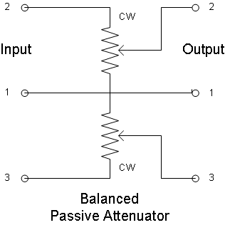

ALPS makes a 4-gang version of the RK271. Though, if you're building a mono amp, all you need is the regular 2-gang version. Just wire it as a differential volume control.

For a mono amp, like this,
Basically, like a left/right as you would in would in a stereo amp with unbalanced inputs and using a common ground?
Yep.

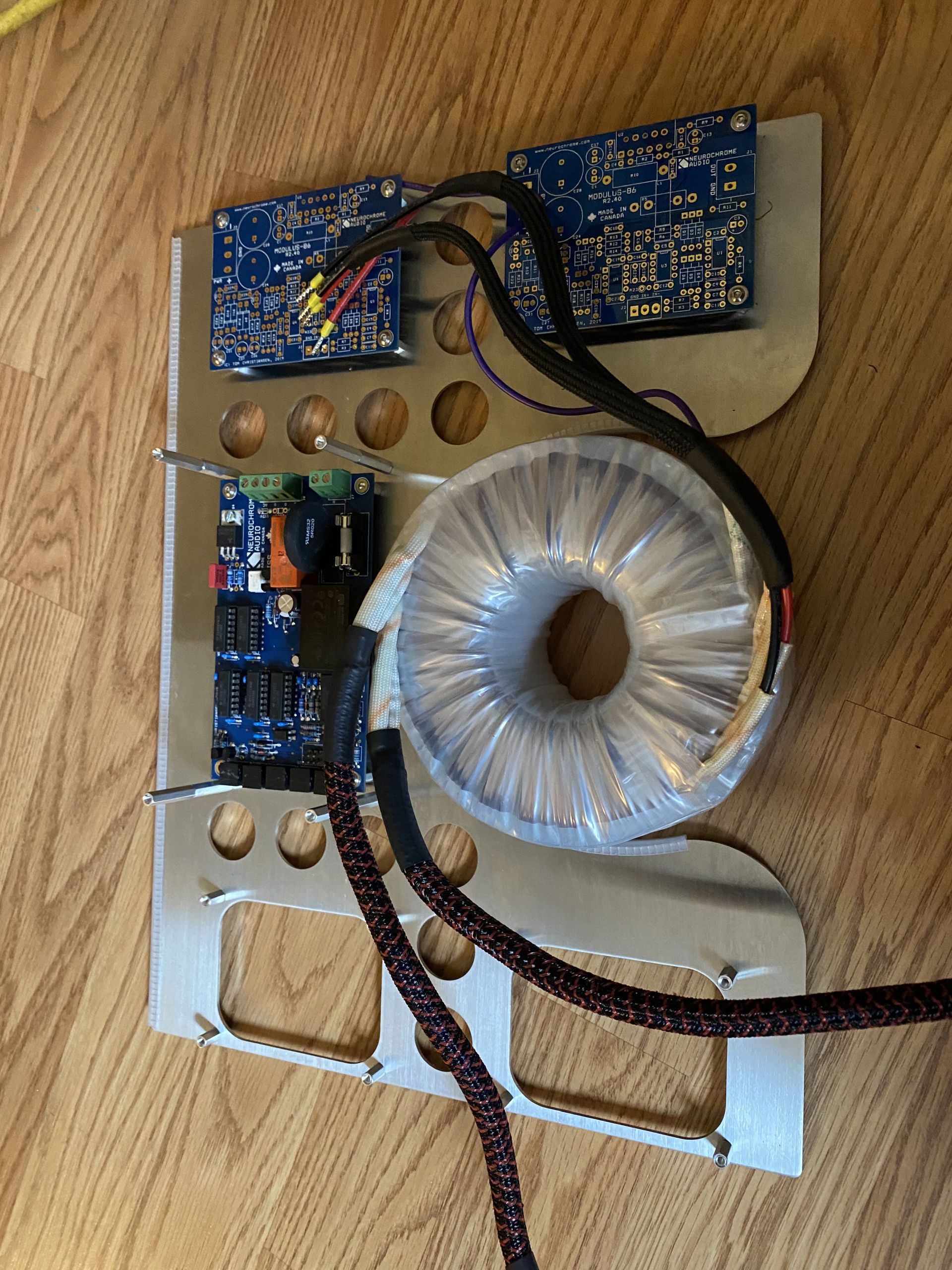

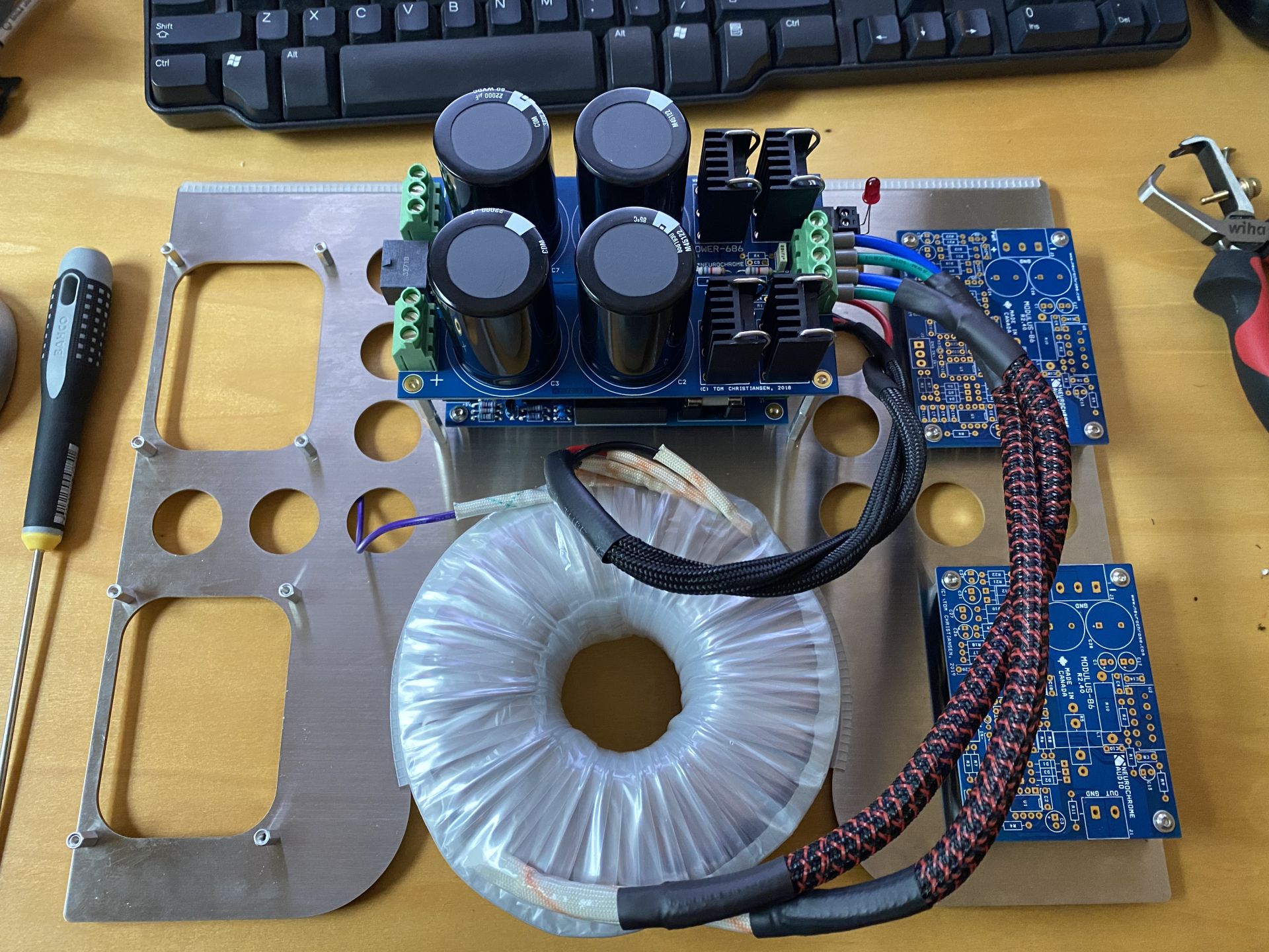

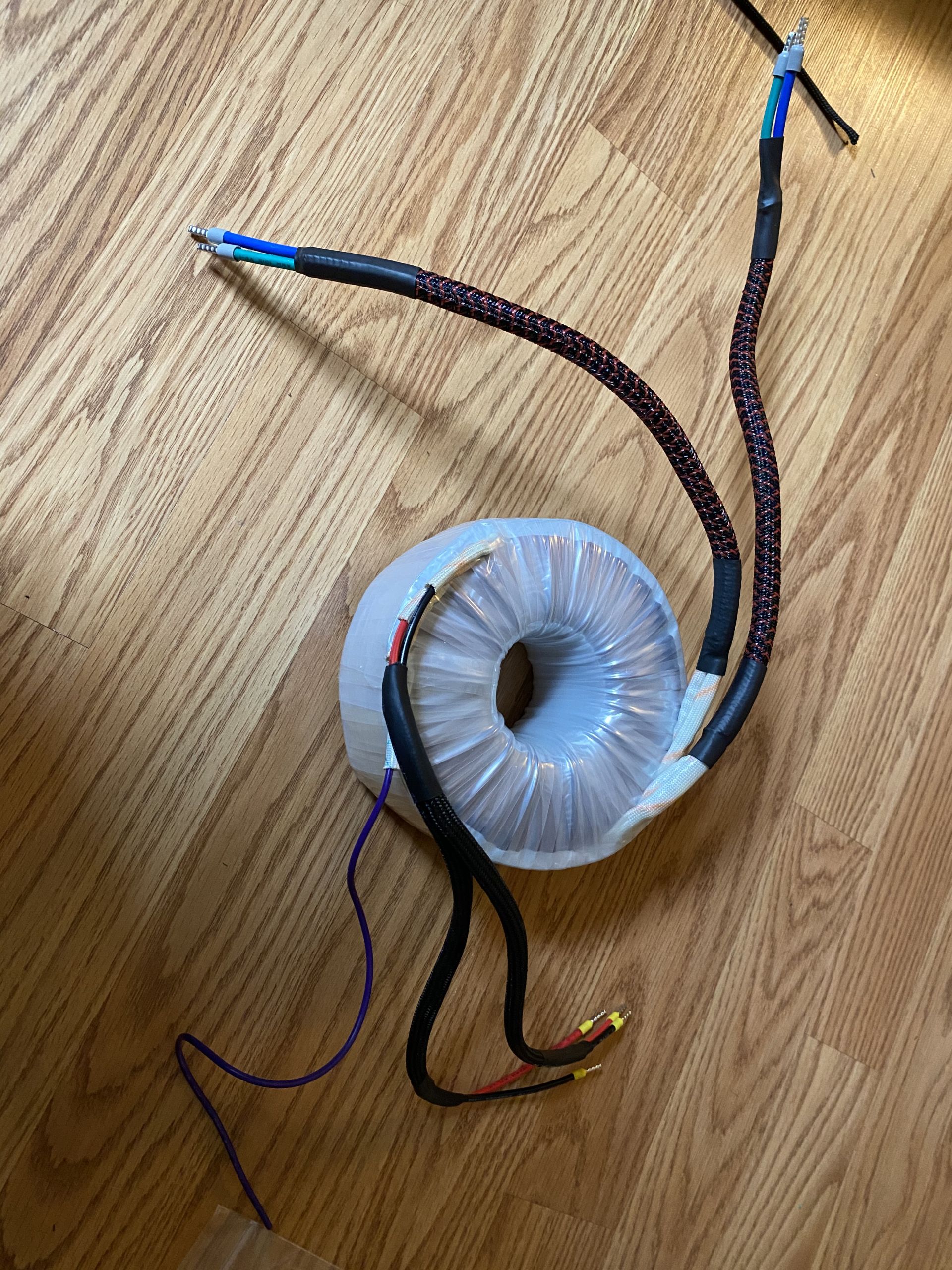

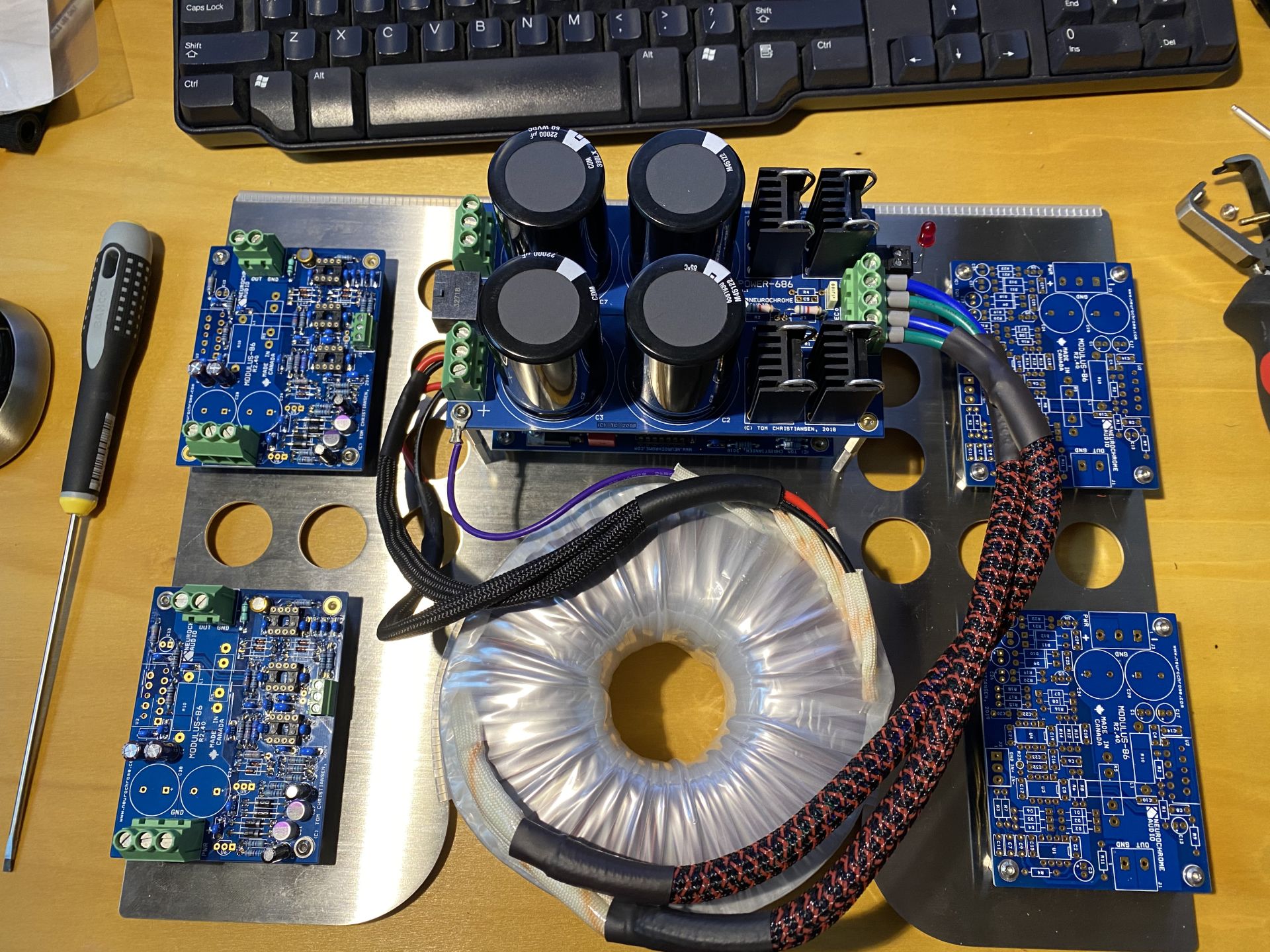

Another Modulus-86 Build

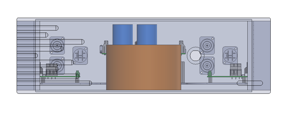

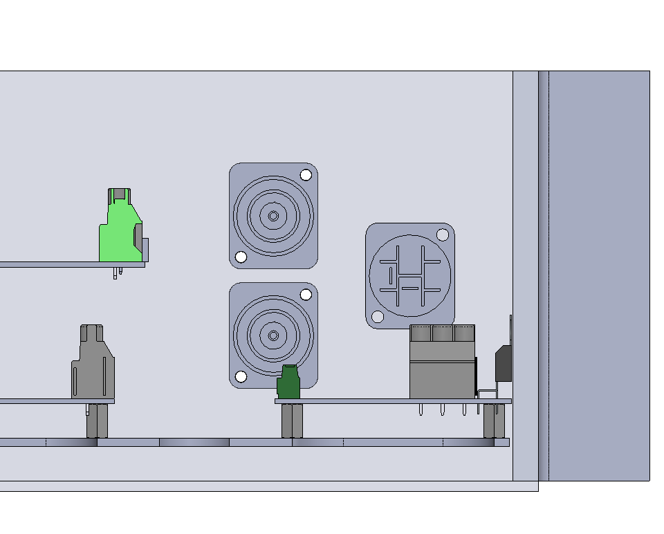

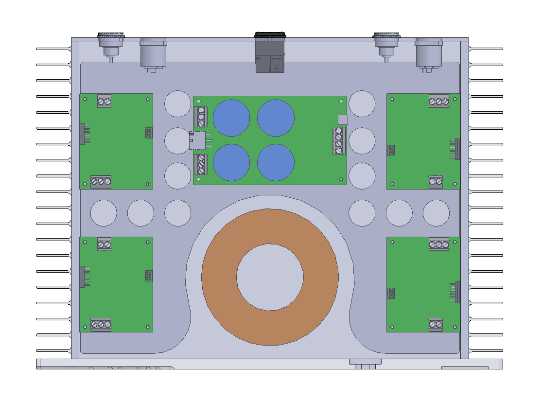

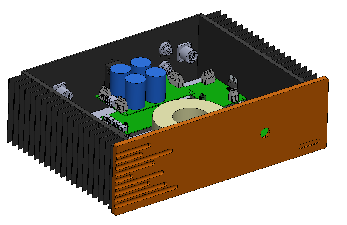

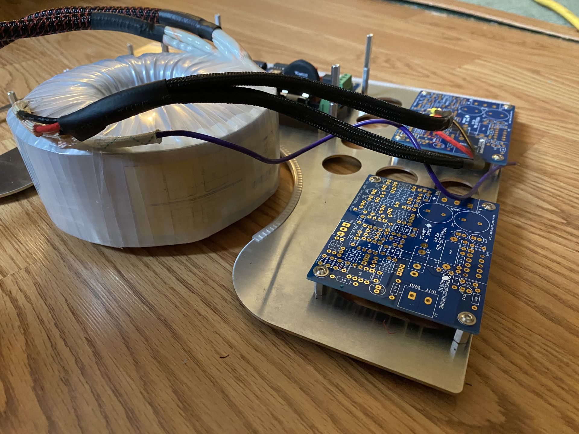

Hi there, thought I would share some pictures of my first amplifier build. Still lots more work to do, but it's coming together thanks to all of you, and help from Tom.
I'm building a set of LXMini speakers and needed a 4 channel amp to power them. Not finding one I liked, and seeing the review of the Modulus amp on AudioScience I decided to go this route.
I'm using 4 x Modulus-86 amps, an Intelligent Soft Start, and Power-686. All powered by an AS-4222 toroidal transformer from Antek.
Connections will be XLR in, and SpeakOn out.
I designed everything in Solidworks to check everything would fit, and ended up going with a 3U Dissapante case (which should arrive on Tuesday).
To make assembly easier I got a shelf to mount everything laser cut from Stainless Steel (shout out to Send-Cut-Send). The nice thing this means is I only need to drill three holes in the base plate and can mount the shelf easily. It also gives me a great ground plane for making everything safe.
Currently working out how I want to route all the wires. They're twisted inside nylon sleeves. All wires end in boot lace ferrules for safety.

Very cool build! What's the protective plastic stuff you have on the edges of that laser cut shelf?
Tom
Tom
E
Looks like what electricians call "caterpillar grommet".. Don't know the technical name.
caterpillar grommet - Google Search
Tom
It's an edge protector - McMaster-Carr
When I get aluminum laser cut there is a burr left. It's not much, but can be sharp, so I use this. The stainless has lovely edges but I put that on around the transformer and along the back edge just to keep things safe. Same with the sleeve for the cables, keeping things safe.
