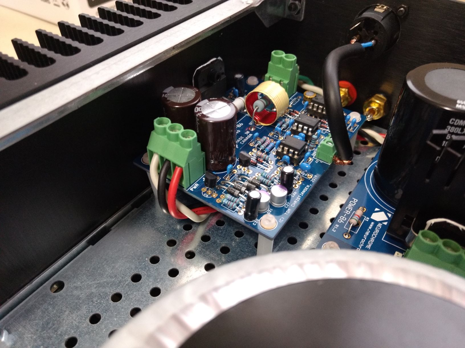

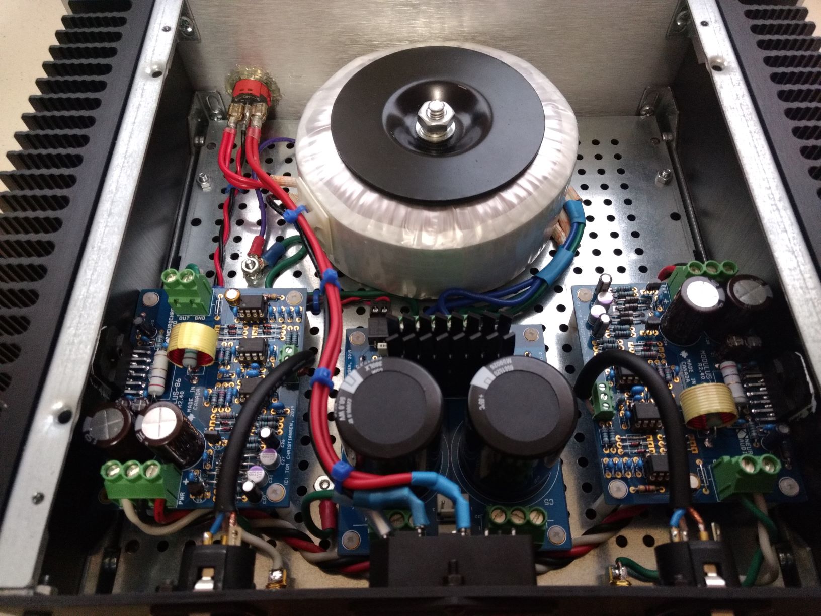

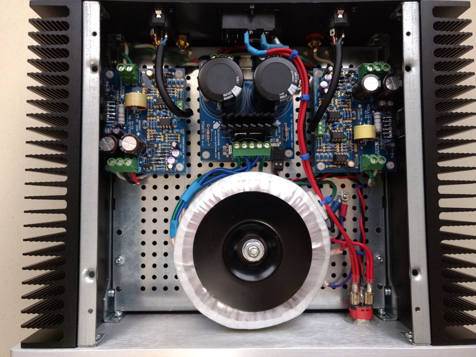

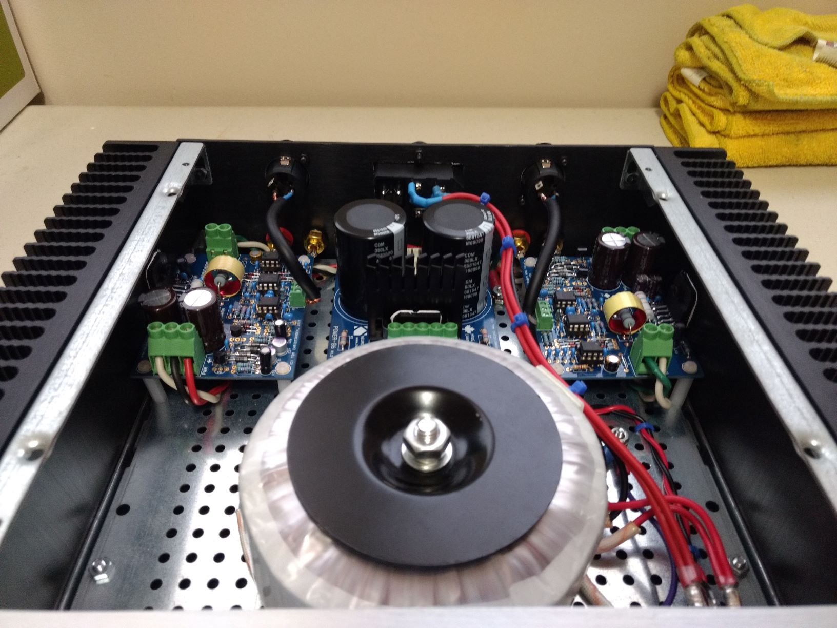

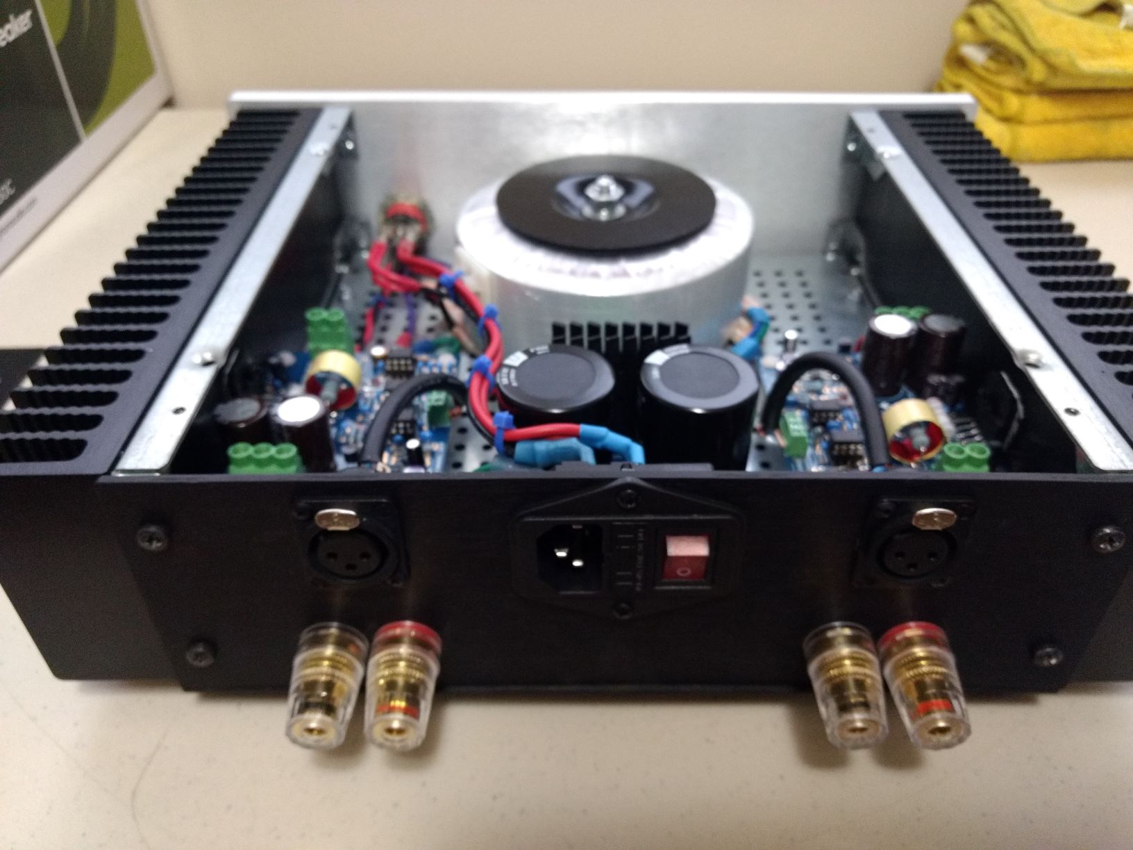

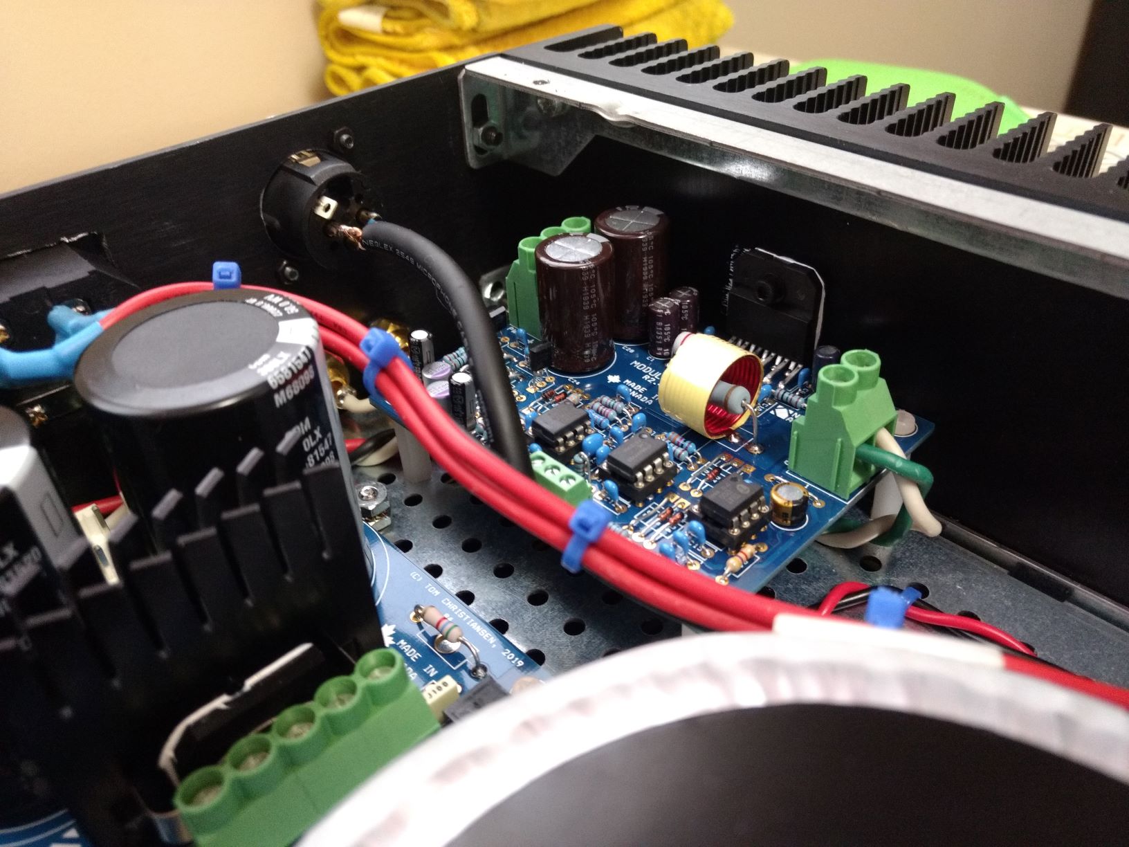

This is my Modulus-86 build into a Mini Dissipante 2U 330mm x 250mm chassis.
It utilizes an Antek AS-2222 and a Power-86.
Even with the modules mounted at one end of the HS, it still runs cool and rarely gets above ambient temp at moderate volume levels.
Do you have a shot of the front of the amp?
What wire did you use for power?
