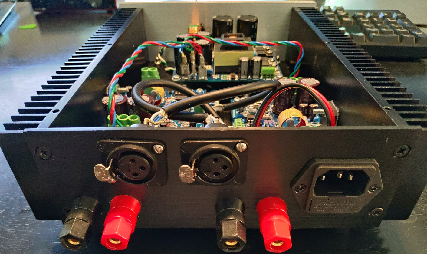

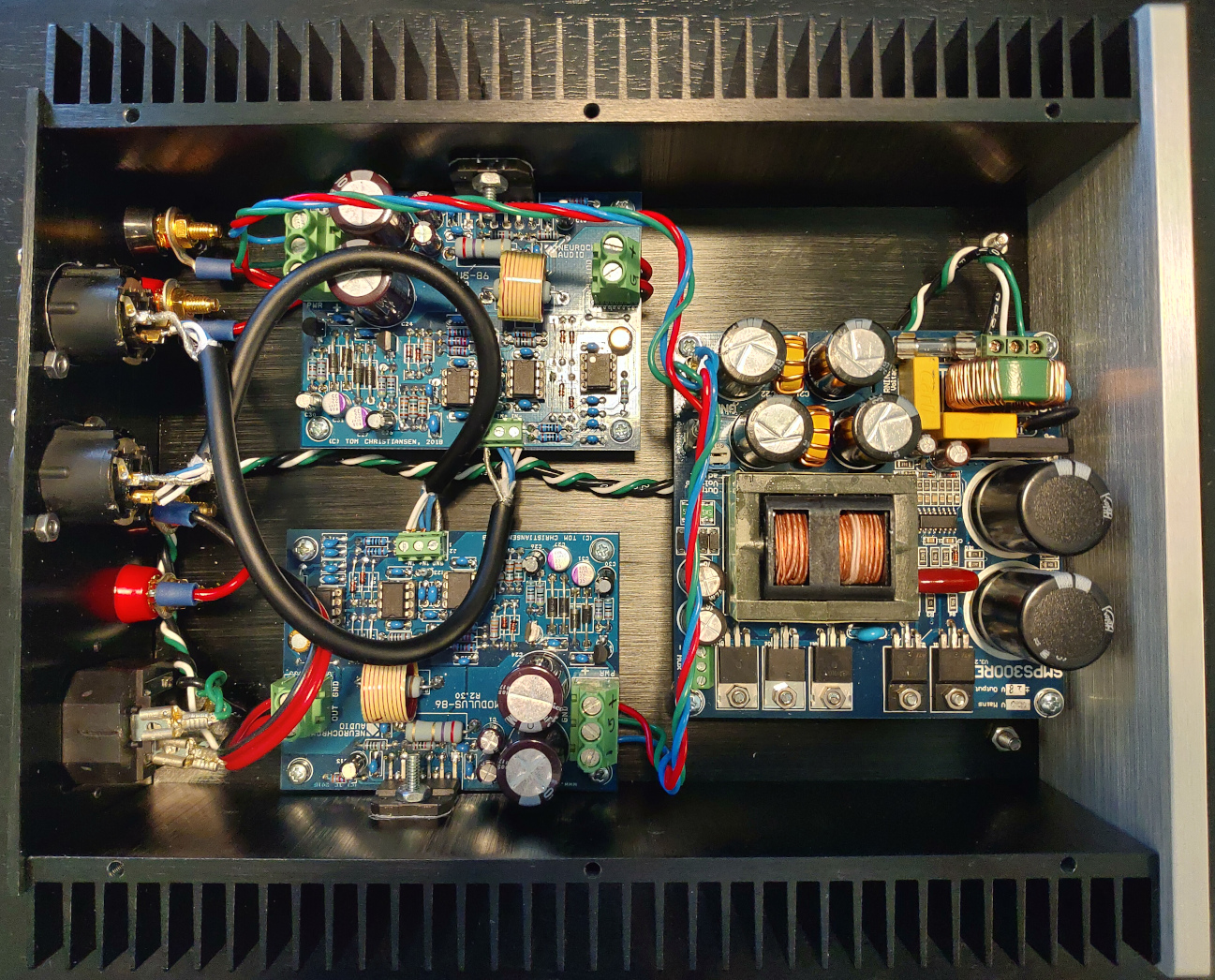

Would this layout work for 2 x Mod86 + SMPS300RAh? This Mini Dissipante costs the same as the "big" 300 Dissipante, but if possible I'd prefer the smaller case. This has 150x300 mm internal dimensions.
Mini Dissipante 2U 300mm frontale 10mm NERO coperchi in alluminio 2mm e retro 3mm
What would be the advantages of going with the big Dissipante?
What you have will work, but I think it can be improved. Specifically, I would avoid dragging the mains voltage all the way through the chassis. So I'd put the SMPS300RAh towards the back and slide the Modulus-86 modules forward.
I do realize that doing so will put the Modulus-86 off-centre on the heat sink. With only one module per heat sink, that should be fine.
I also recommend keeping the mains rectifier section of the SMPS (so the upper right corner of it in your drawing) away from the input of the amp. That rectifier emits quite a bit of switching noise, so give a good 30-40 mm of separation from anything sensitive (such as the amp inputs).
Tom
Tom

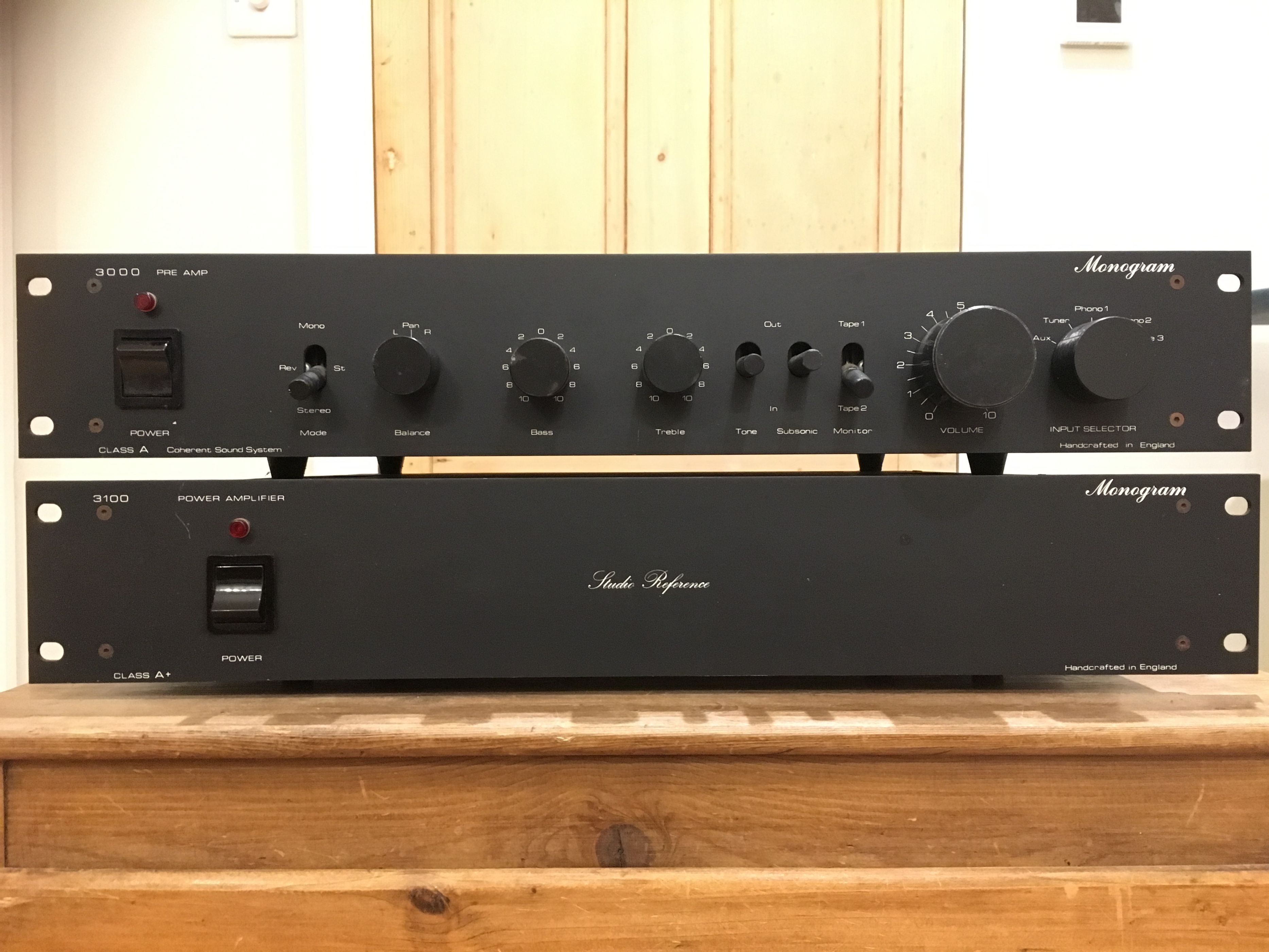

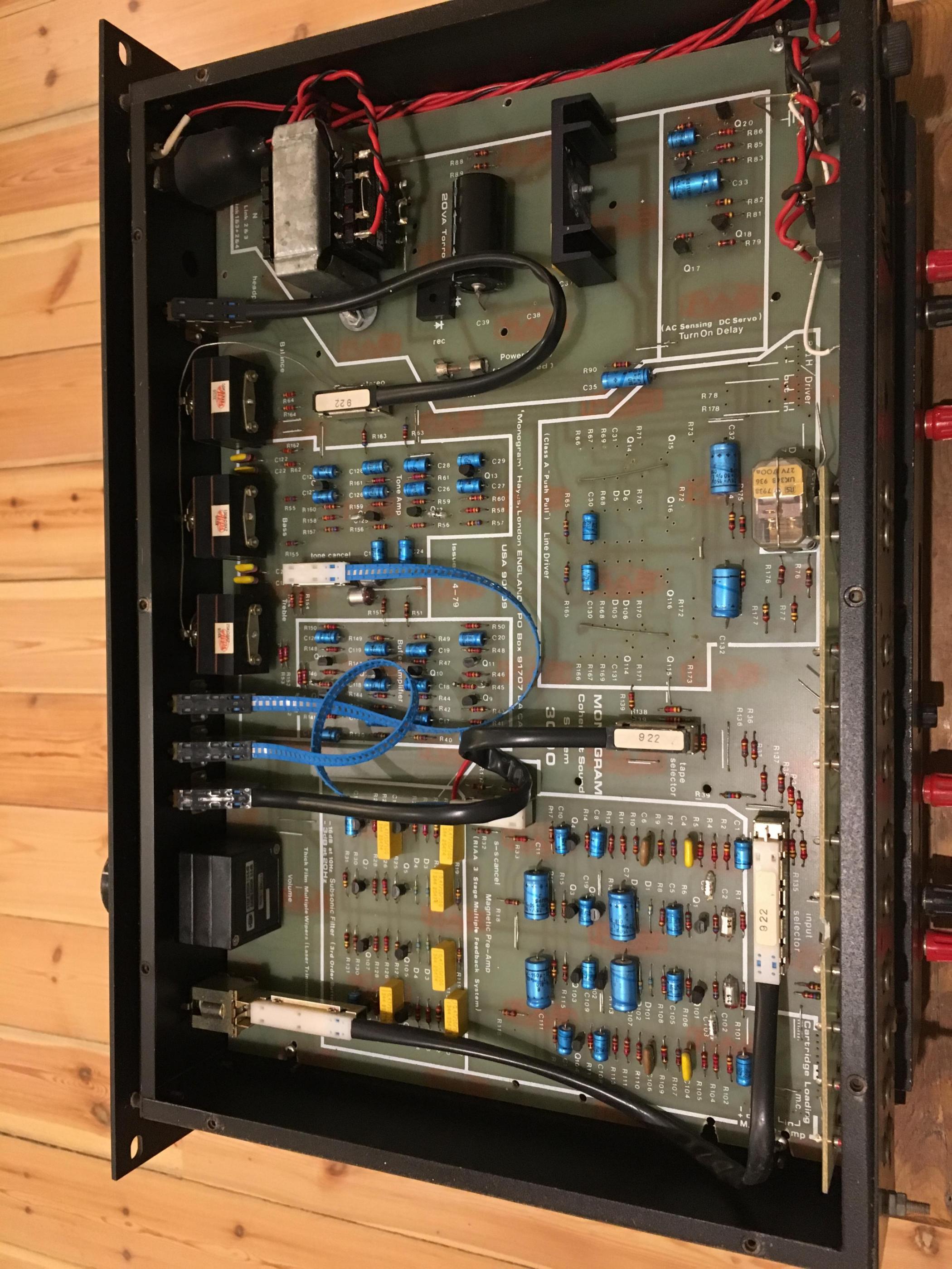

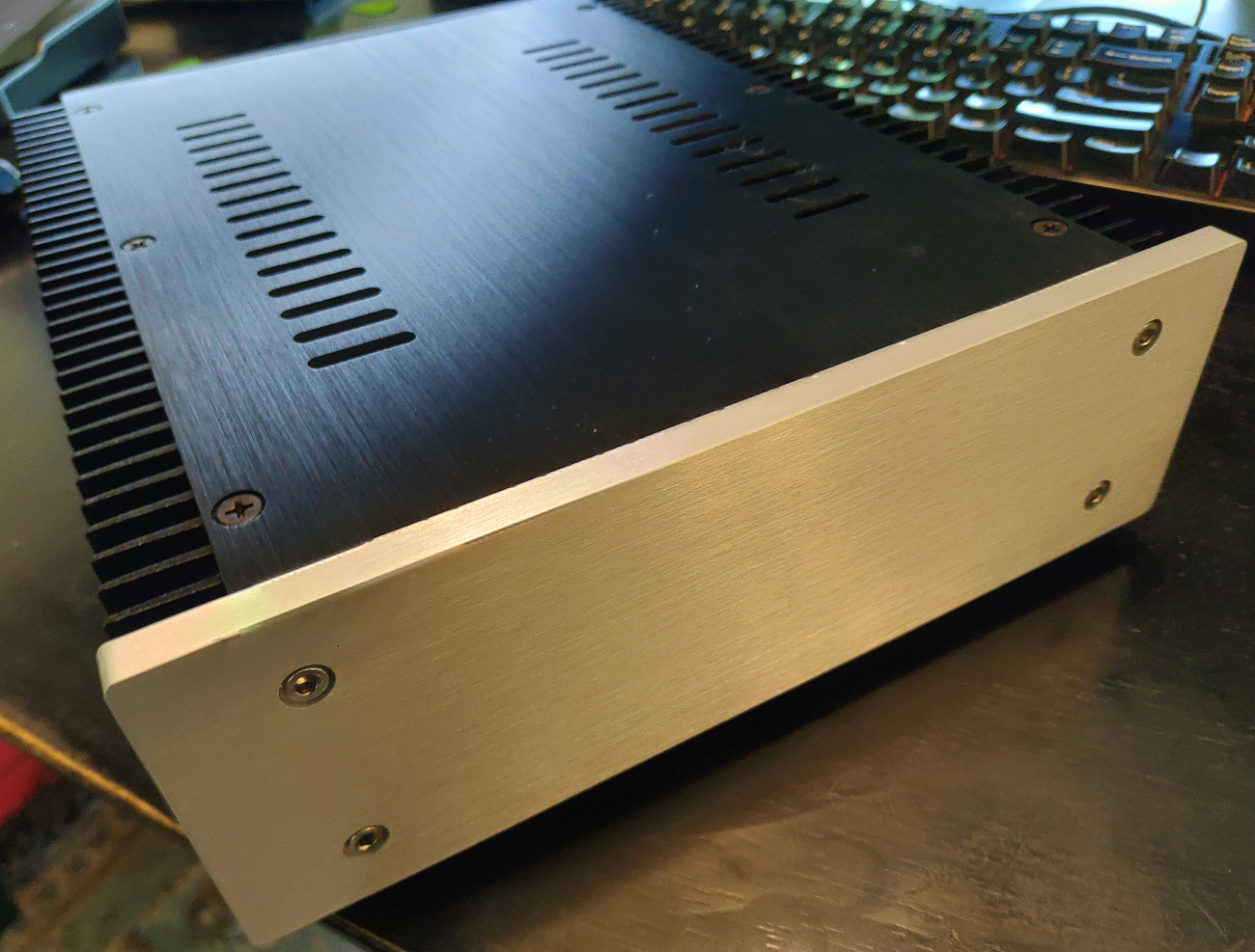

A little while ago I acquired some (as it turns out) fairly rare 70’s cottage industry HiFi kit from Monogram, a Pre-amp and a power amp. Little is documented about this stuff yet reportedly pretty pricey in it’s day it appears well made. The power amp doesn’t work and I’m slowly working on getting that resolved, part of the problem is getting over the claim that Monogram Professional Audio made in their blurb- a “New” and “Exciting” circuit due to its ‘Class A+’ operation, it says it on the front- so it must be true! I gather this is reportedly Class A operation up to a given threshold then AB after that. Bless. …rubbish of course but not understanding the thing or indeed how to bias it, it’s a project for another time…
What surprised me was how well built, and good sounding the preamp was; looking inside there’s lots of quality components, big stepped Alps pots and Philips 015 caps- the phono stages (MM and MC) aren’t half bad either. (…is this a Modulus amp build thread? –Ed.) Endearingly we also have fruity text on the front, “Coherent Sound System” “Handcrafted in England” and in italics on the power amp “Studio Reference”… I didn’t just want to leave it at the back of the cupboard somewhere.
Furthermore, and here might be where the astute reader might see where this is going, they come packaged in (nearly) 2U rack enclosures in black- much like the Dissipante line favoured by many of those on this now epic thread.

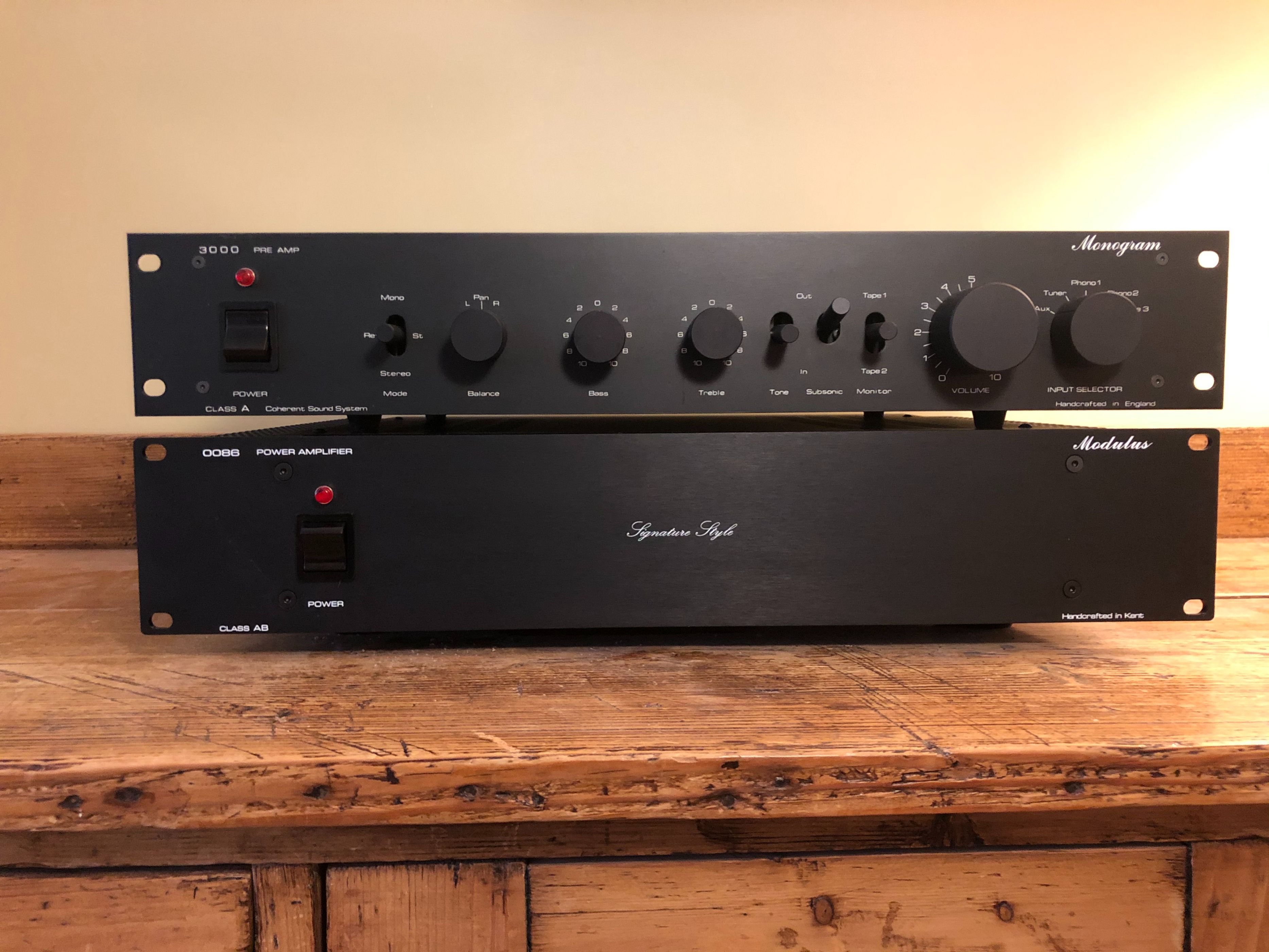

It’s the lockdown in the UK and I fancied a little handcrafting of my own and wanted to build something to match the pre- amp and keep this thing alive- so I’ve re-created the Monogram power amp with Modulus 86 innards after having followed this forum for a while. Front panel layout was to be as similar as possible, though I couldn’t bring myself to write “Studio Reference” on the front… I kept it whimsical and opted for an in-joke with my friends instead, “Signature Style” and “Handcrafted in Kent” where we live.
I’ve had great fun doing it- first amplifier build- and credit should be given (of course) to Tom at Neurochrome and also Gianluca at Modushop for quality products, reasonably priced and speedily dispatched, thank you both. Followed Tom’s excellent documentation exactly and everything thankfully went very smoothly. Should also mention I stole the idea for the amp board brackets from a recent build from user Klas- neat…
Sounds great… Thanks again Tom!
You're welcome. I'm glad it came together nicely for you. Nice work with the front panel. You matched the Monogram style nicely.
I don't envy the task of poking holes in that steel rear panel. I did that once. That steel is rather hard... It looks like the hole punch worked nicely, though.
That preamp is insane. It looks like the switches are connected to the levers on the front panel by a flexible mechanical link. That's pretty darn cool!
Tom

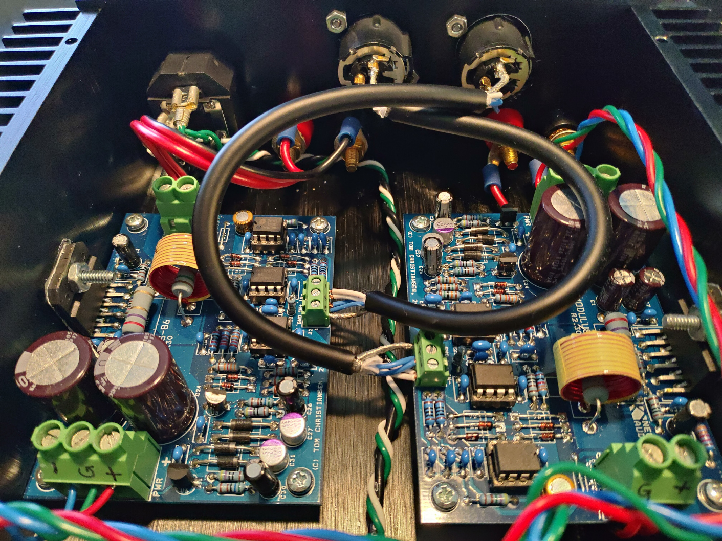

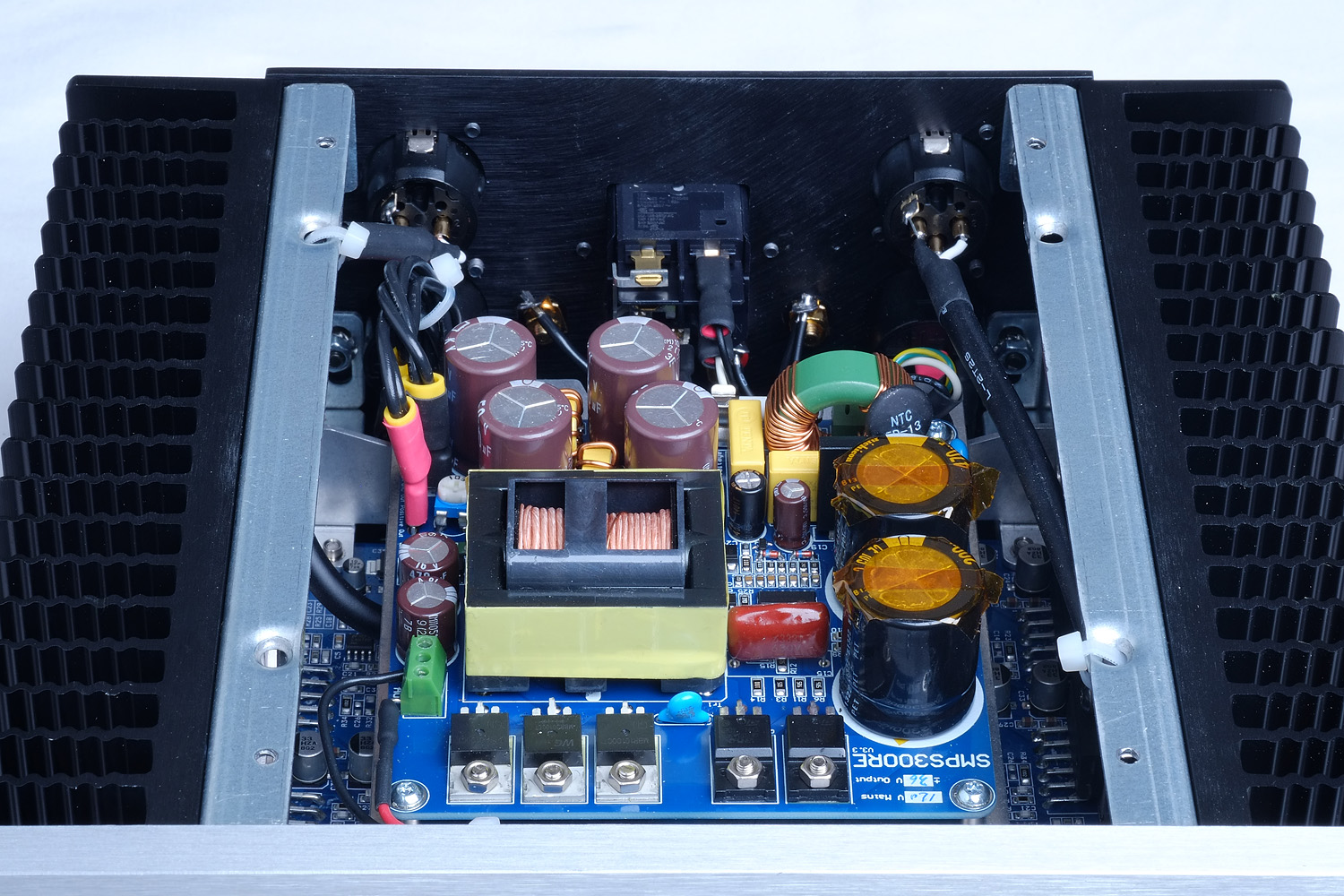

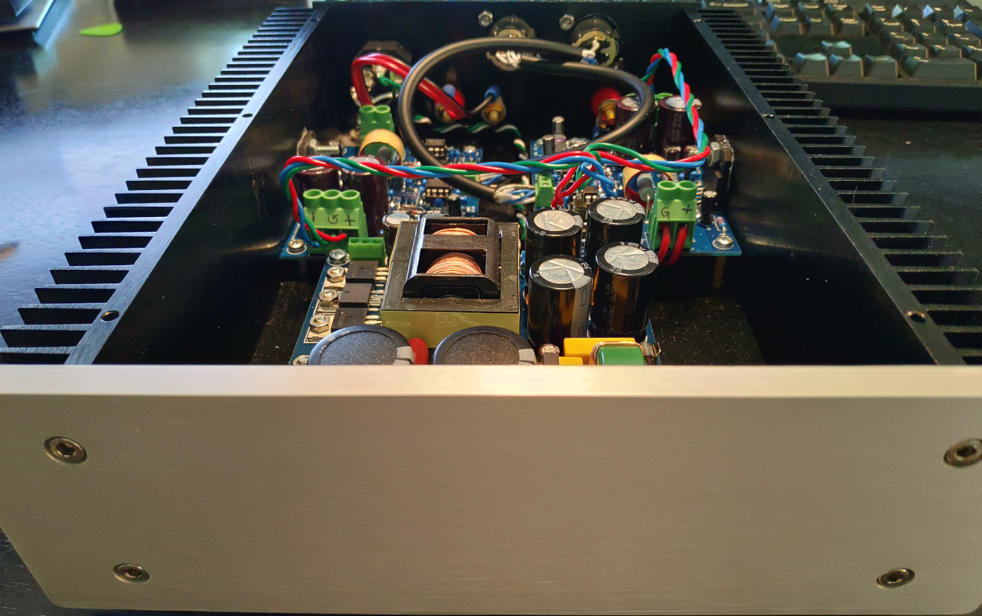

Mod86 Rebuild
I've been enjoying my Modulus-86 for well over a year. It's actually been running 24/7 since I built it. In post #4510 (Feb 2, 2019) I posted pictures of my completed build. My only complaint was the case was too big. So I stole the SMPS300RE from my LM3886DR build, and found a smaller case on ebay. The smaller ebay case has external dimensions 212mm (w) 70mm (h) x 257mm (d) and internal dimensions 162 (w) x 60 (h) x 246 (d). Much smaller than the Mini Dissipante 2U 300x330 I was previously using.
I actually rebuilt this a few months ago, and am only now getting around to posting pics. And when I came here to post, I see Tom's reply to erozsolt in post #5166 asking about a layout that's essentially the same as what I used:
So, my rebuild is probably a sub-optimal layout. I can't remember exactly why I went with that layout; but I think it's because I thought it would be ideal to try and center the LM3886 chips on the heatsinks. If I pushed the PSU to the back of the case, then the amp chips would definitely not be centered on the heatsinks. Either way, if the layout actually makes a performance difference, I certainly can't hear it.
The other kind of ghetto aspect is that I don't have a tapping bit, so I just drilled a hole in the heatsinks, and used a screw and bolt to mate the LM3886 to the heatsinks. The space between heatsink fins is a little too small for the bolt head, so I had to kind of hack at the heatsinks a bit. I had to use a little bit of Aluminum Black to sorta cover up the resulting ugliness. Next time I do something like this, I'll follow Tom's recommendation and actually tap the heatsinks for a nice, neat chip mount.

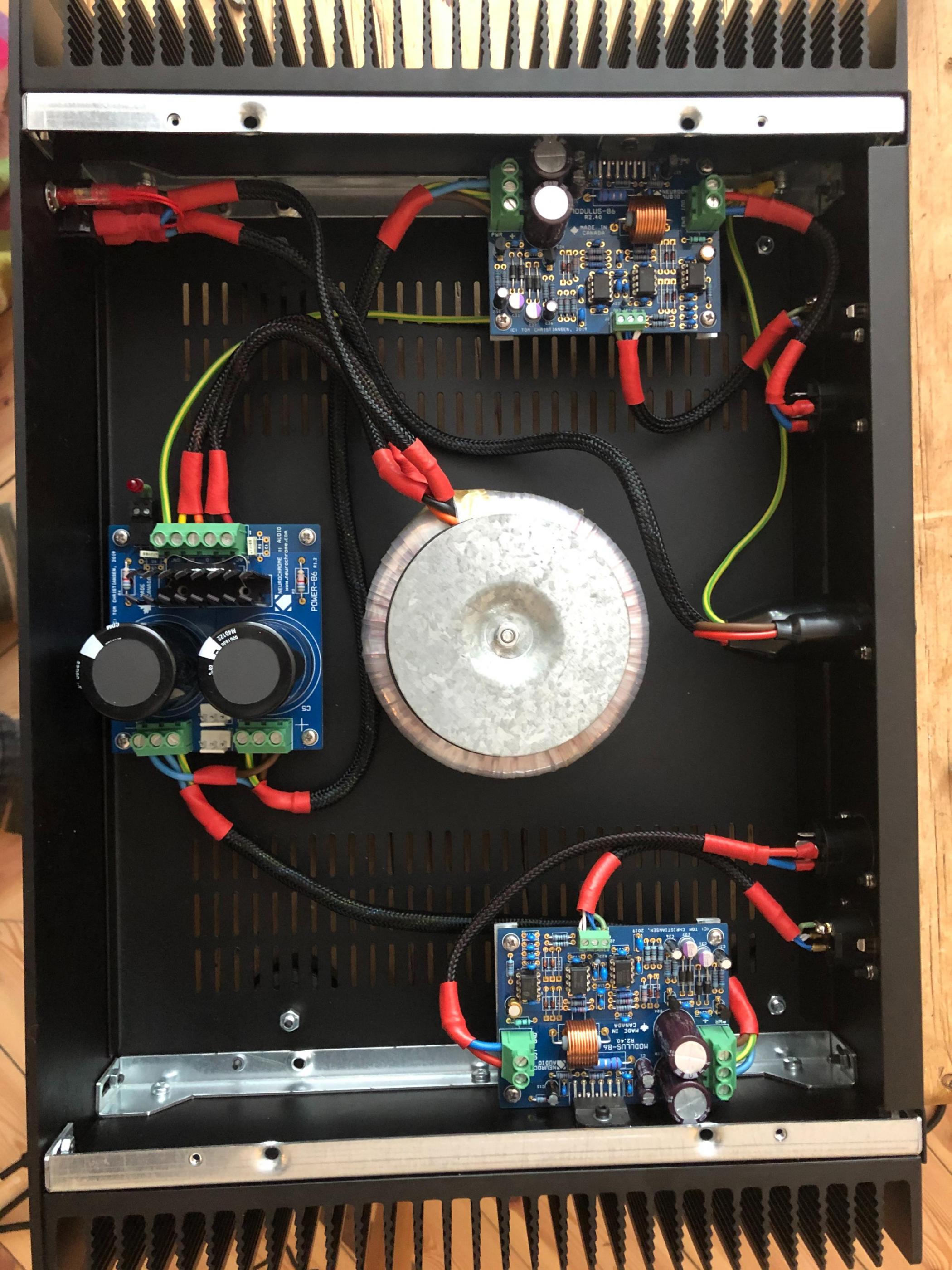

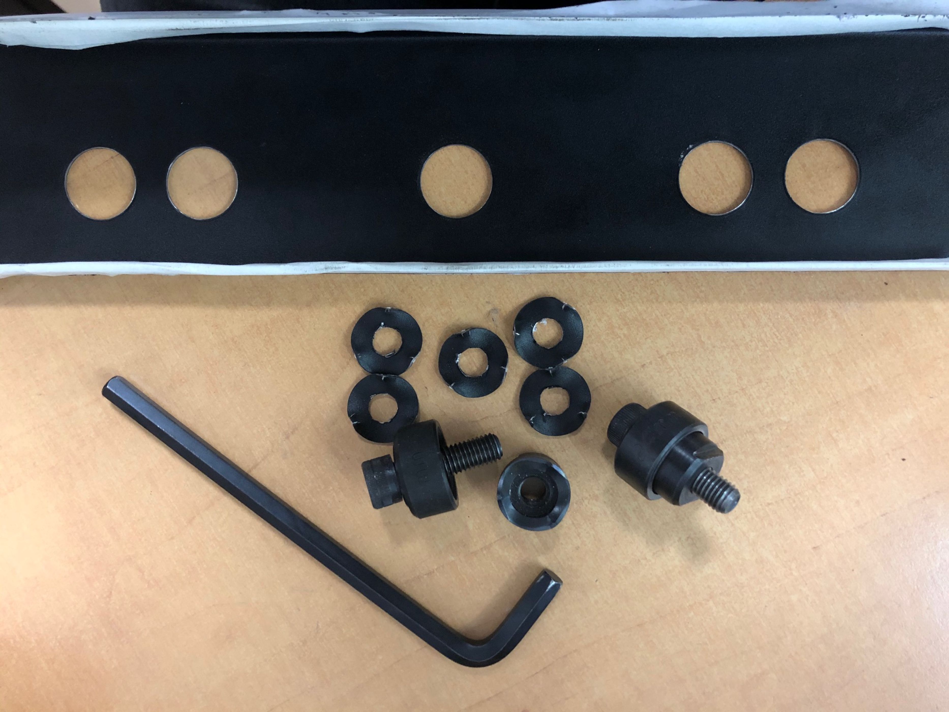

I've got essentially the same case. Mine however came predrilled with holes for the speaker binding posts and rca and an IEC socket. I however ordered the SMPS300RAh and was sent an SMPS300REh. Difference? Tom was checking that out. I am looking at how I was going to make a hole large enough for the XLRs with the rca socket in the way.
My case also has vent slots on the bottom plate as well similar to the top plate.
Waiting to put everything together and start soldering.
BTW, where is the on off switch?
It's that right-most receptacle in the picture of the back of the amp.
I got lazy many years ago and stopped putting power switches on most of my DIY projects, and just use the power plug for turning off and on.
Thank you for sharing your build pictures. It looks like your build came together nicely. I like the compact chassis too.
Life doesn't have to be optimal all the time. In fact, setting those expectations is probably a recipe for insanity.
As you point out, there are many optimization variables, two being the placement of the LM3886 and the placement of the power supply.
If you have to have the power supply towards the front of the chassis, the placement you have, with the rectifier of the SMPS (the black rectangle sandwiched between a yellow cap and the rightmost of the two black electrolytic caps) as far away from the analog circuitry as possible, is optimal. What I don't like about that placement is that the AC gets strung all the way through the chassis. Tradeoffs, tradeoffs. You can deal with that by keeping the AC wiring away from the inputs to the amps.
That said, I'm also not a fan of putting the LM3886 all the way at the end of the heat sink. I try to stay within the middle third of the heat sink length at least. With the chassis you have, you'd have had one LM3886 almost at the end of the heat sink. That's not such as hot idea either.
Another option would be a mezzanine plate like I did in the Modulus-286 Kit (LE). That adds a lot of complexity on the mechanical side. The Kit was in the 2U x 230 x 200 mm Mini Dissipante.
So... Honestly... I think you picked the lesser evil. Put the lid on it and enjoy the music.
Tom
