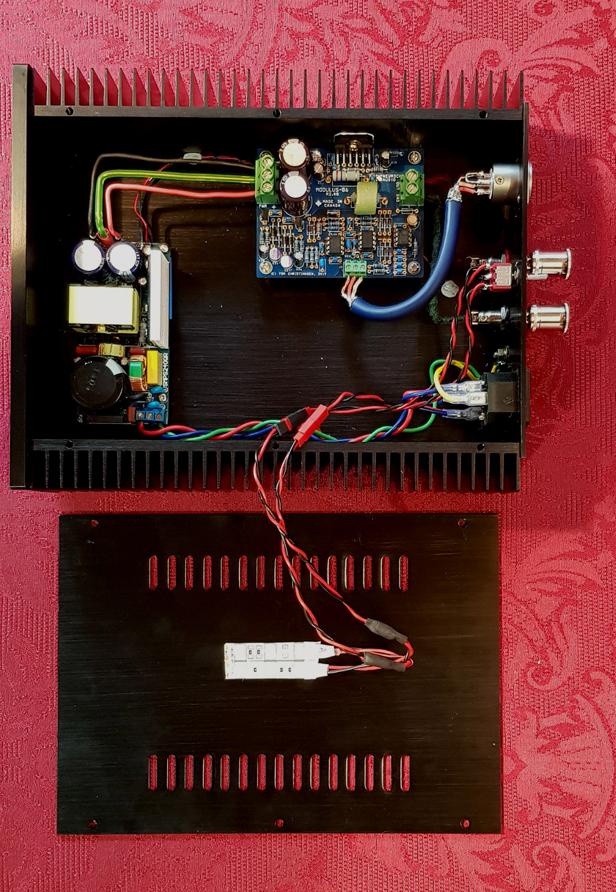

First time posting on any forum but here is my build of the Modulus 86.

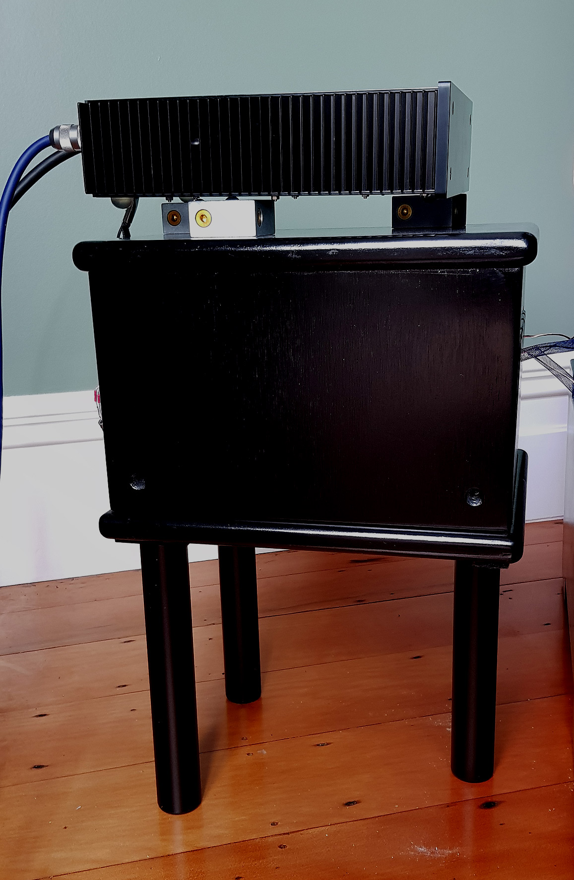

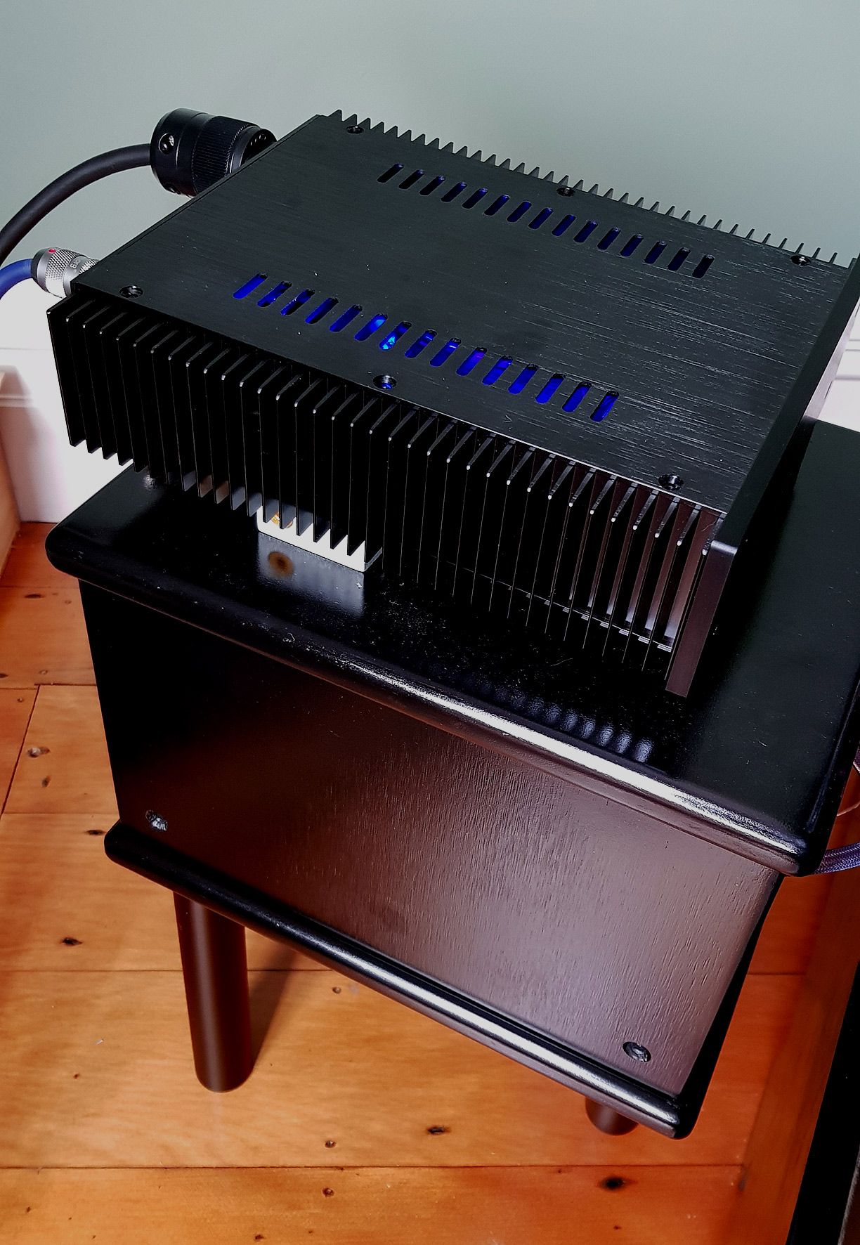

Built them as small monoblocks to sit directly on the external xovers meaning I don't need any extra speaker cables - YAY! The xovers have short 'tails' straight up to the binding posts of the amps.

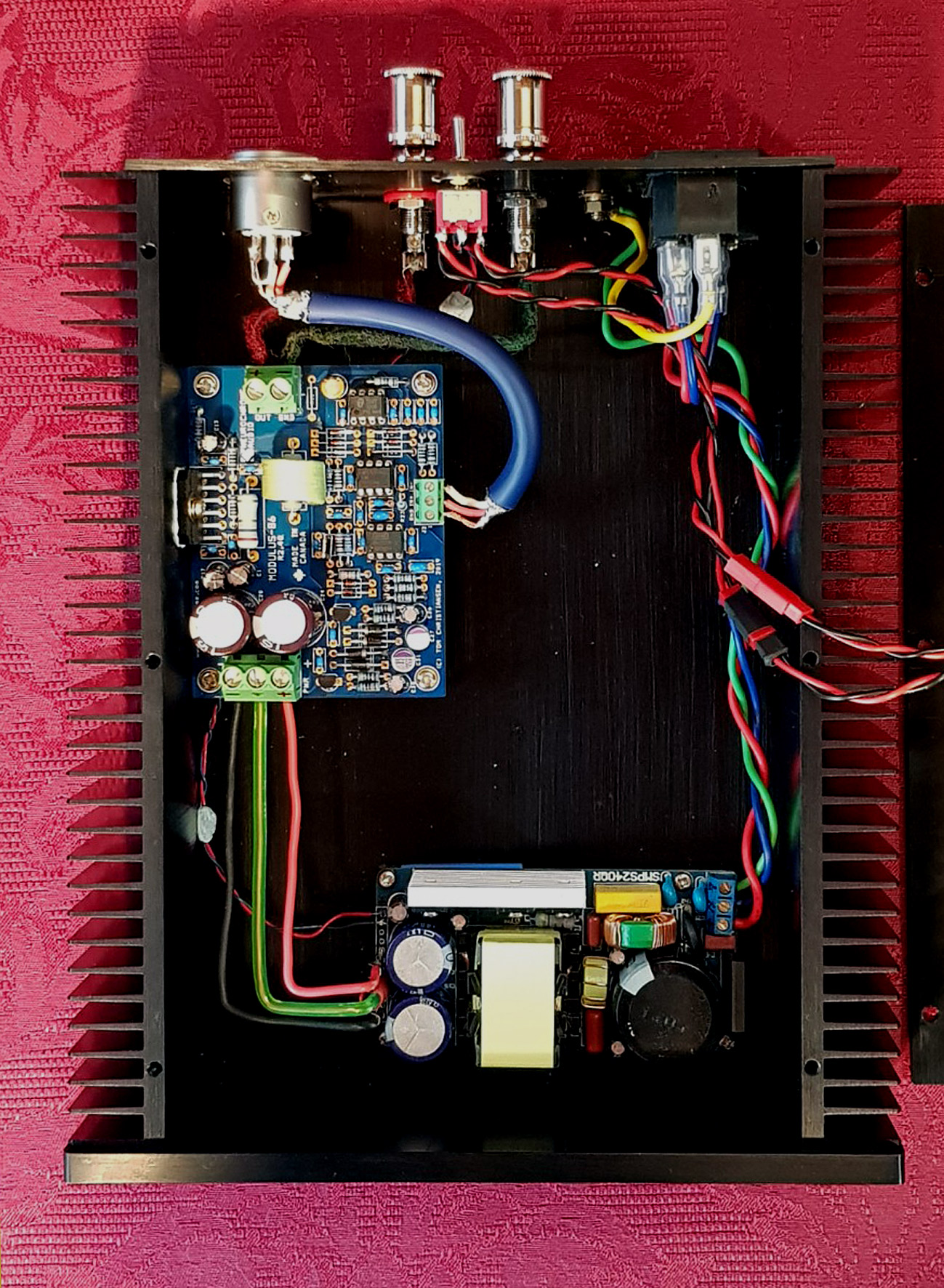

For those (all?) of you who like construction details I used the Connex SMPS240QR power supplies as easy and seem more than capable and absolutely dead quiet with my high 90's sensitivity speakers.
Amps run at only just above ambient with only a slight temp rise when playing loud. Of course my 8 ohm speakers don't need much power though......
Only variation was replacing the 20k feedback resistors with Charcroft Z-foils - just liked the idea.

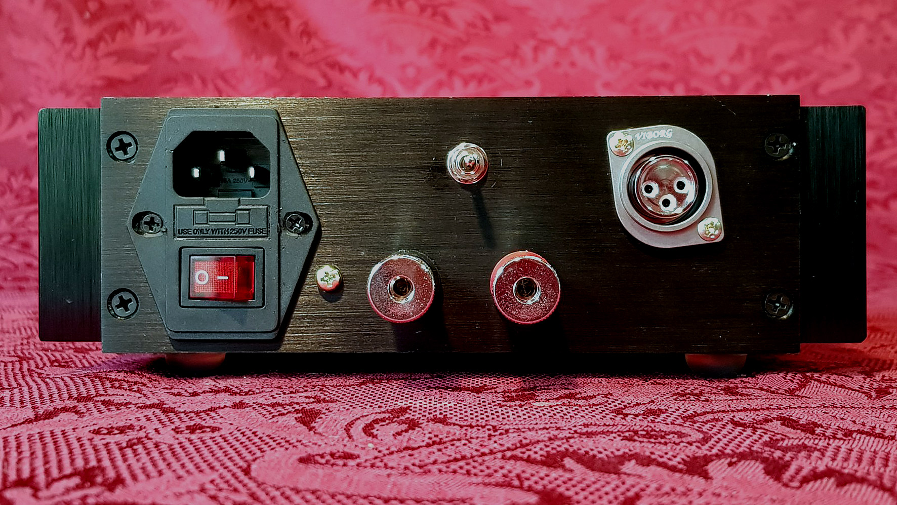

Connectors chosen were Viborg because I like rhodium plating and the teflon XLRs seem well made. Certainly can't fault them but there are lots of other choices out there!
Internal IC wiring is the Swiss Gotham top reussen bal cable. Fiddly to use but gets top comments in the pro world. Very reasonably priced too.
Short output cable is Duelund silver foil.
Because the amps are directly behind the speakers I decided to place LEDs under the lid to 'wash' colour through the ventilation slots. Amber + blue + off - completely silly I know but colour selection depending on mood and a good reminder the amps are on.
The monos meant a complete change in direction for me as I could go balanced for the first time from my DAC. Of course that meant new ICs (3.5m Gotham mentioned above) and new power cables (decided to go with Gothams top reussen screened PC too). I have absolutely no idea how the Gothams stack up against my traditional 'audiofoolery' stuff as I don't have ready access to such long lengths. All I can say is the system is performing considerably better than it has ever done - amazing 3D imaging, super detailed and tonally very nice. Excellent, actually far superior bass control and dynamic contrasts in spite of its low power rating against my other 125W highly regarded amp. Certainly wouldn't be embarrassed by some of the exotica I have heard at RMAF and the Munich shows IMHO.

The 240W Connex supply worked out well in the case although could have gone with the 300W version - better, who knows!? The mono amps are perfect for me too as am over speaker cable dramas..... My wife is happy as less clutter.
Case is the BRZHIFI BZ2107 series double radiator aluminum case for DIY on Aliexpress and very reasonably priced from Weiliang Audio. Am sure it is available from other sites too.

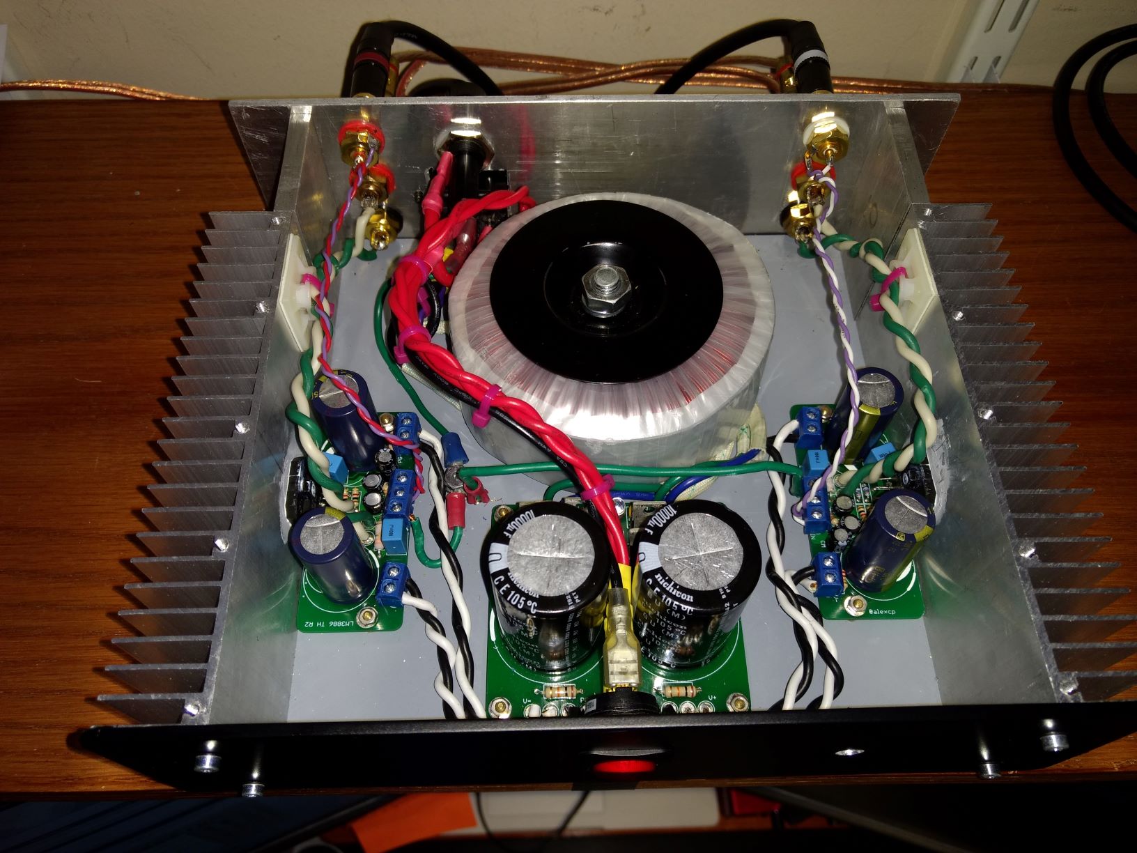

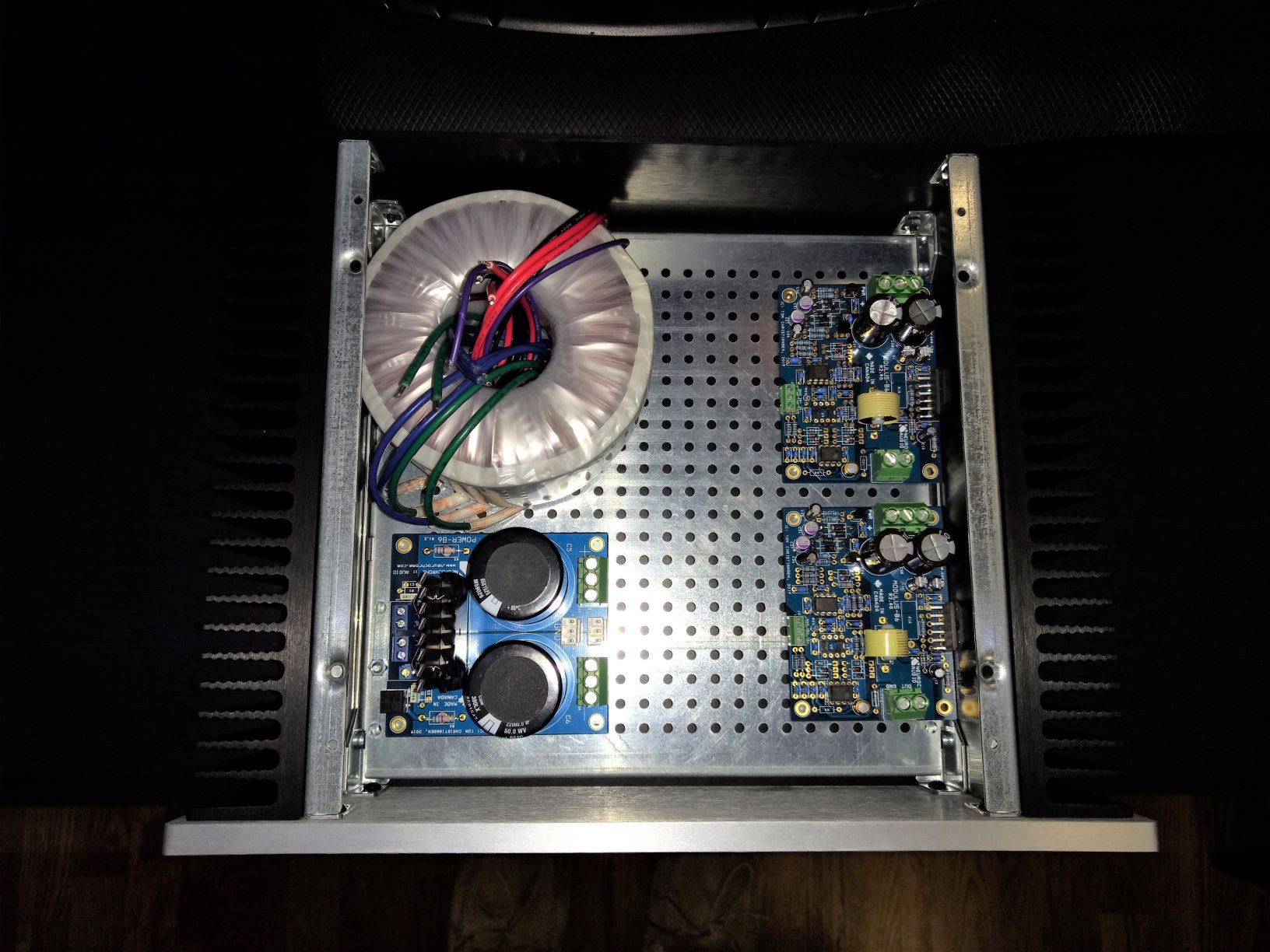

Howdy All,

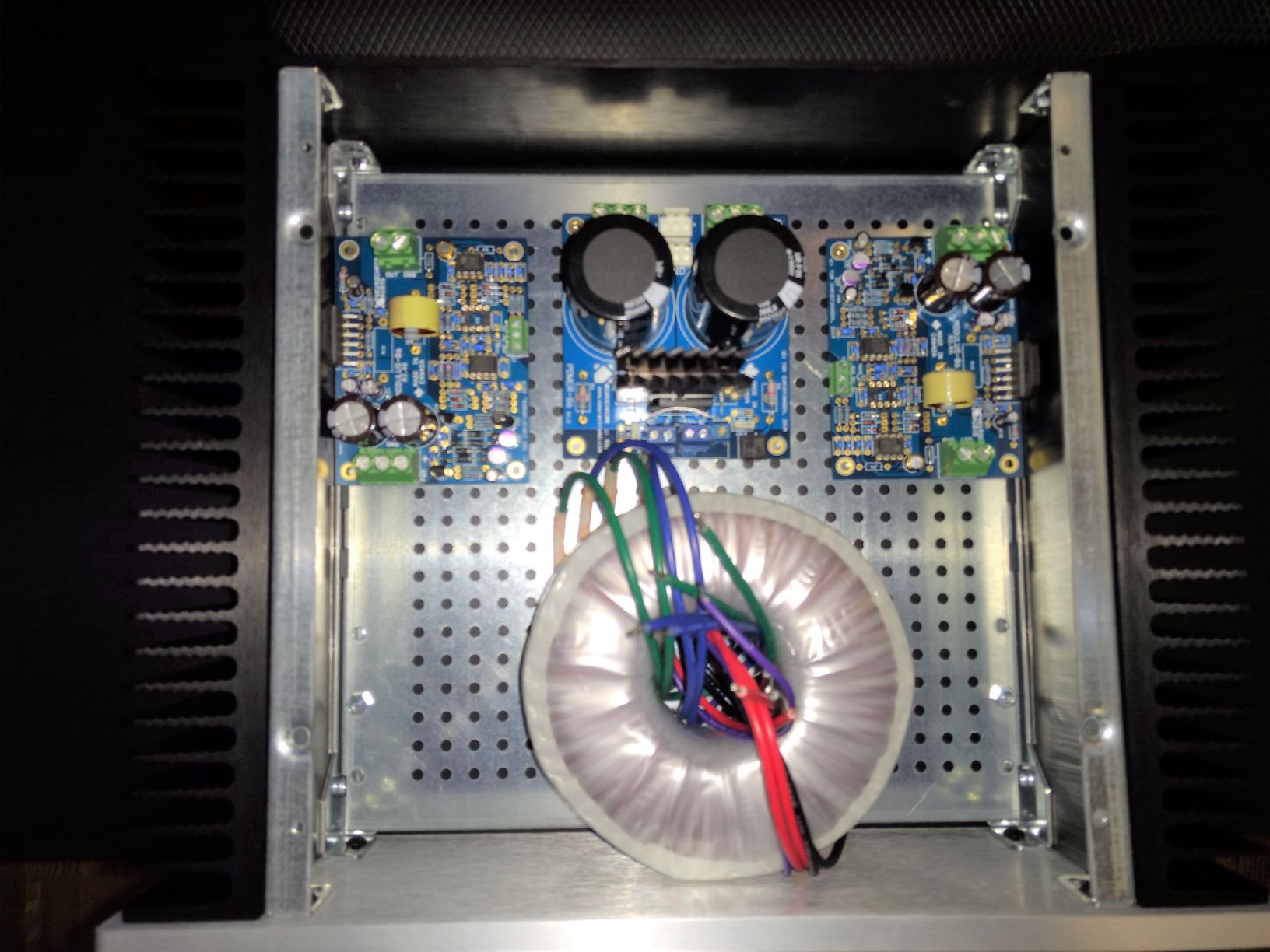

What would be considered the better component layout for a stereo Modulus-86 build in Mini Dissapante 2U 330x200?
AS2222 Toroid in front with symmetric board placement or asymmetric with both driver boards on one side? Those heatsinks are 200x80x40mm.
I am not too worried about heat since this is a near-field desktop setup driving Micca RB42 speakers (~6 ohms).
My existing stereo LM3886 amp (AS2210) is symmetric and the heatsinks are 150x60x25mm and is barely above room temp after running all day in a 75f room.
Great. Now I'm getting chassis envy again. I really like that chassis and the compact builds that can be had with it.
Are you sure it's not the 330 x 250 mm chassis you have? The useful internal dimensions look to be 250x250 mm based on the board sizes.
Personally, I prefer the arrangement with one MOD86 per side for better heat distribution.
That said, for casual use it doesn't matter much. Even for sine wave operation into a 4 Ω load, the 0.47 K/W of the Mini Dissipante 2Ux250 mm heat sinks will provide enough cooling for the amp to survive continuous operation with both channels going.

I like configuration in the first picture. At least this is how my amps are payed out. But have thought about trying the layout in the last picture.
Reasons why;
The layout shown in the first picture minimizes the length of the input and output cables. Less antenna effects.
The layout in the third picture minimizes the length of the input AC leads. Less field generated.
Almost all commercial amps look like first picture. Assume people have built all three and found this measures better.

Not Tom, but isn't using equally-rated amplifiers on every driver of an active three-way highly unusual?Any other obvious implementation issues / problems that I'm missing?
If you were to minimize the cost then that is the case. In commercial applications of active systems, one of their requirements is to not supply too much amplification for sections that don't need it only for amplifier cost reasons. They can use multiple smaller amps to supply the total power required.Not Tom, but isn't using equally-rated amplifiers on every driver of an active three-way highly unusual?
In this implementation, I can see the convenience of just using the same transformer and let the amps share it. The MOD86 can tolerate that without detrimental effects as long as there is sufficient VA available.
My belief there is never excess headroom.
