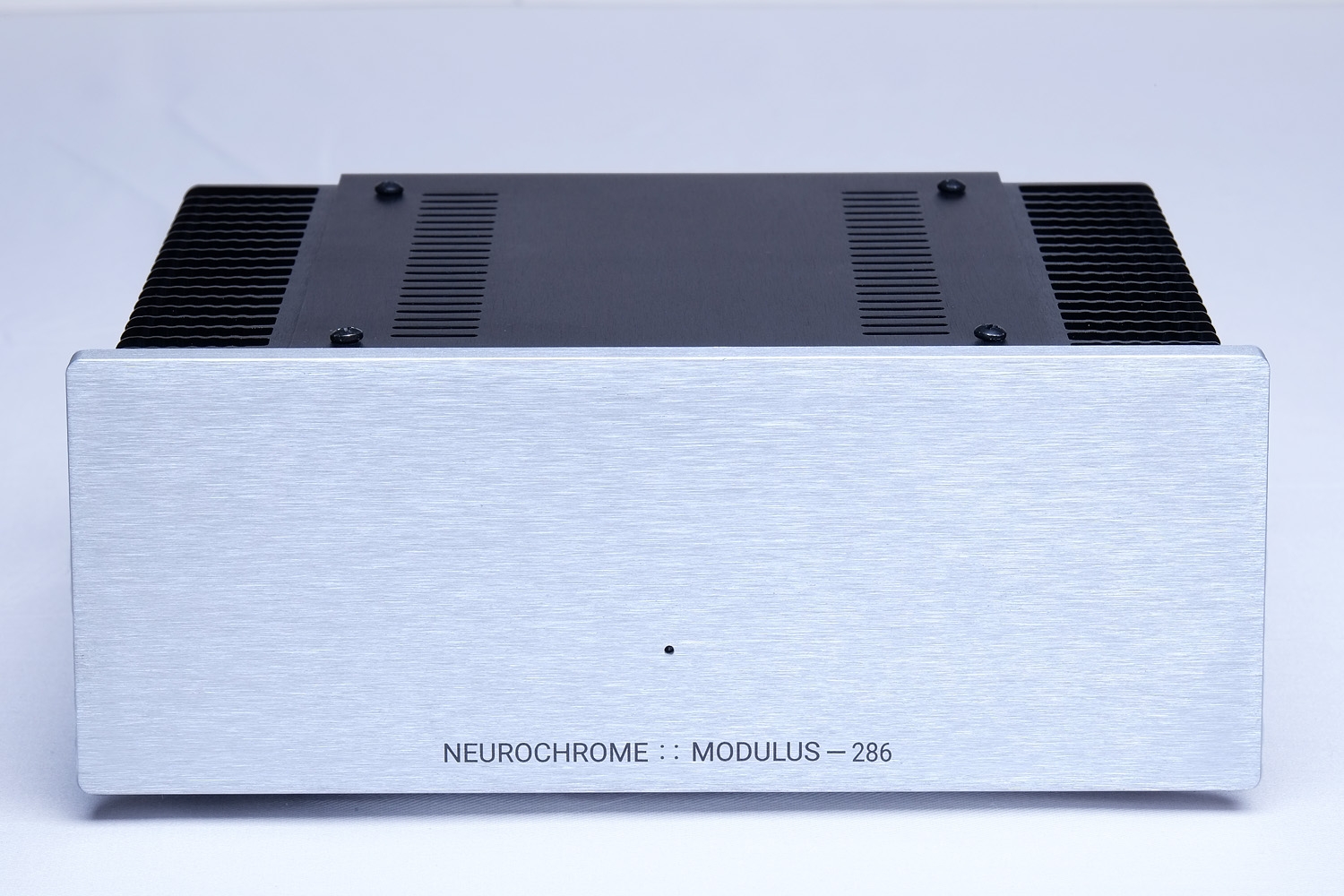

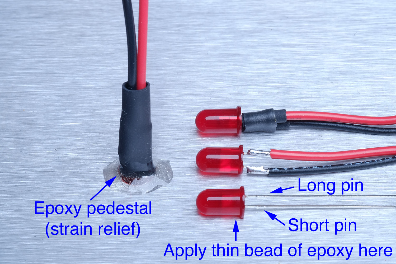

What is the voltage range that can be used for the power LED?
I know the one spec'd is 1.8 volt, but the choices in that voltage are rather limited.
Trying to find a nice panel mount LED power indicator to use there.
Any LED indicator that does not already contain a series resistor can be used. You'll find many in the 1.7-4 V range (different emitted wavelength -> different voltage drop). About 5 mA flows through the LED.
An alternative to an actual indicator is to just use a 'naked' LED. This is pretty easy if you use a chassis with a thick front panel. Drill a 2 mm hole through the panel and make a 5 mm diameter counterbore on the inside, centred on that 2 mm hole. Then epoxy the LED in place. That's what I did on the Modulus-286 Kit (LE).
