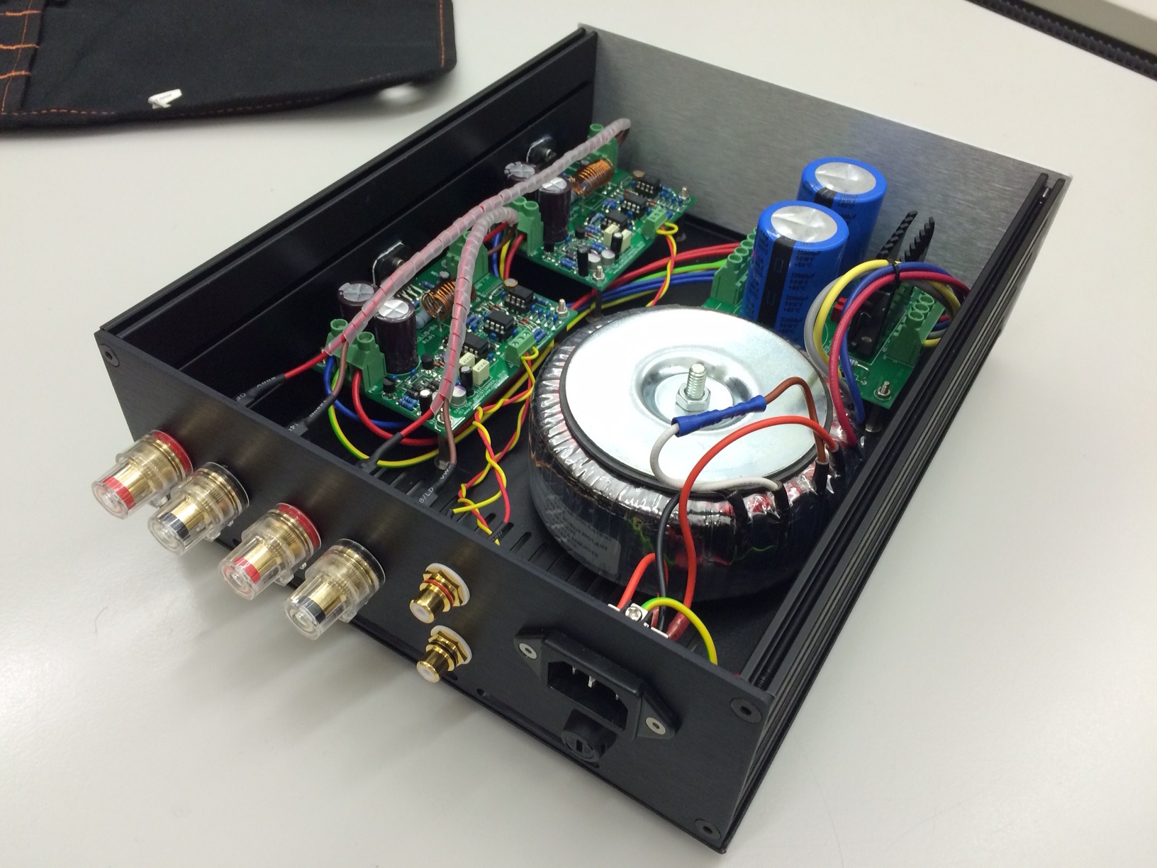

I am about to fit my two Mod-86 boards, power supply and transformer in my chassis and I was wondering what the best layout is.
Keep the wiring to the transformer as short as possible and keep the primary wires and secondary wires tightly coupled. You don't need to twist them together, but at least wire tie them tightly to minimize the loop area. This will minimize the inductive coupling from those wires. Keep the transformer and its wires away from the inputs of the amp if possible.
The Modulus-86 is rather immune to mains hum. Even in my lab setup with a rats nest point-to-point power supply, the largest mains hum residual measures -120 dBV. I wouldn't lose sleep over the chassis layout, as long as you follow the guidelines above.

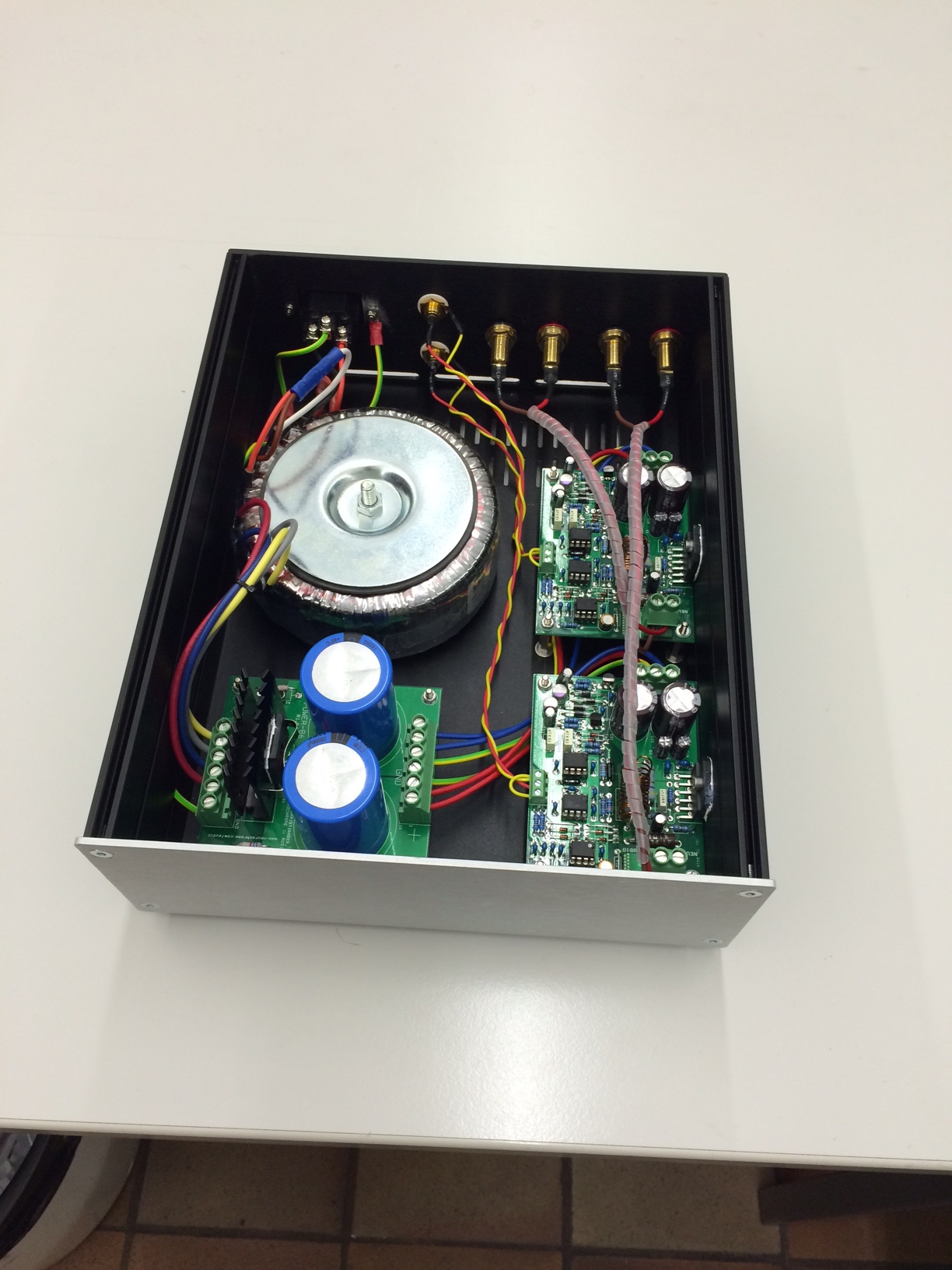

It is born...

I'm also considering placing a metal plate between the transformer and the Mod-86 boards to act as a shield.
Unless the plate is made of mu-metal, you won't see any benefit of a metal shield between the transformer and the rest of the circuit.
The leakage field from a toroid is pretty small to begin with. Just couple the wires in and out of the transformer tightly (wire tie in a tight bundle) to minimize the loop area of that "antenna" and you'll be fine.
In the measurements of the noise floor I show on my website, I did absolutely nothing to shield the transformer from the amp.
I do share the concerns about the sides of the chassis being enough heat sink. It won't be for the full dissipation of the LM3886, but it's probably good enough for music reproduction at reasonable volume levels.
In the measurements of the noise floor I show on my website, I did absolutely nothing to shield the transformer from the amp...
Do not we need any type of shield?

No. There are two reasons for this:
1) It's not needed.
2) It's prohibitively expensive. To provide any meaningful attenuation of the 50/60 Hz field around the transformer, mu-metal is needed. If you're curious, you can run a google search to find out what makes mu-metal so expensive to deal with.

Talking about shielding, I think shielding the circuit makes more sense. At least I found that if I place the circuit in an iron casing, the measured 60hz ac is reduced. This was done with lots of equipment around the bench and looking at the amp output on a scope with lots of other equipment and lighting around. Opened and closed the chassis showed a significant change on the scope.
