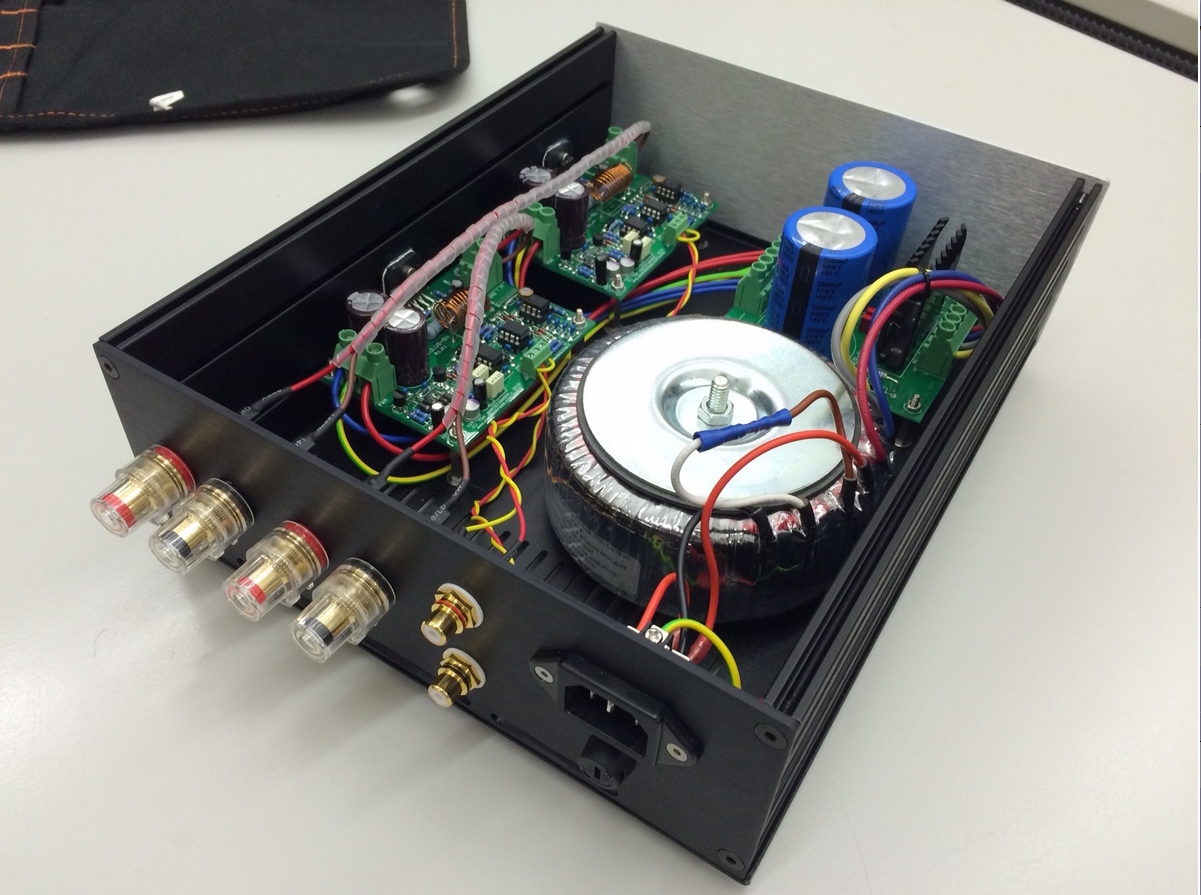

Hi sebbesen and Tom
I do share the concerns about the sides of the chassis being enough heat sink. It won't be for the full dissipation of the LM3886, but it's probably good enough for music reproduction at reasonable volume levels.~Tom
I see that ebbesen used the case as mine. At home level listening, the aluminium sides remain absolutely cold. At louder level listening they just become a little warmer (~30°C).
As my amp is mounted (see right photo) and using "Voice of The Theater" very high efficiency loudspeakers (103 dB/W/m), I cannot hear any hum or any other noise at all with my ear in the horn neither from the horn of the TAD TD4001 compression driver.
As Tom said this amp has become my daily amp, by replacing a AN 300B SE.
I have made some listening comparisons with a Nelson Pass Labs X150.5 and a 8W "Le Monstre" by Hiraga.
- I tell you soon...

Hi sebbesen and Tom
In your case you are not going to dissipate much at all!. Most of the time you will be tickling along at a few mW. Hope you have a lot of fun with the new Amp.

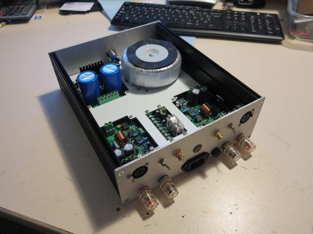

Good point. The wiring is still subject to modification. I'm also considering placing a metal plate between the transformer and the Mod-86 boards to act as a shield.
That kind of shielding isn't needed with a very low gain power amplifier. But, you could shield the signal cables.
At post#1430 on the Honey Badger build thread, OStripper shares some ideas on shielding the signal cables.
http://www.diyaudio.com/forums/soli...honey-badger-build-thread-29.html#post4251857
Audio signal is on every cable that connects to the amplifier board. Even so, I think that the small signal cable can be a priority.
However, what I said earlier may be more effective than shielding attempts, and that was:
"I suggest to move the small signal input cables, slightly farther away from the transformer. "

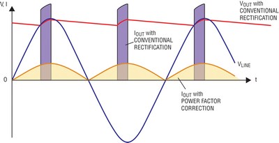

The most critical part in Power amplifiers are wires/traces from transformer to diode bridge and to bulk capacitors because the pick current values are about 6x larger than nominal current.
Those large current are prone to emit strong EMI from wires and for that reason we need to take care on that. Also that is a reason why we usually need much higher current rated diode bridge than nominal expected current.
