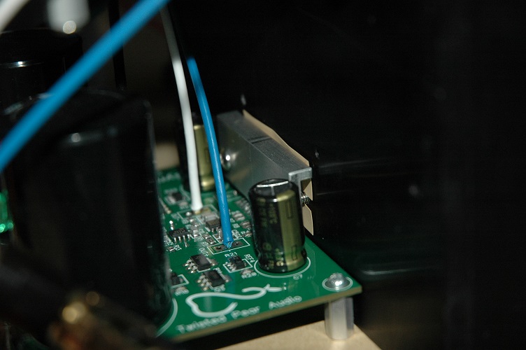

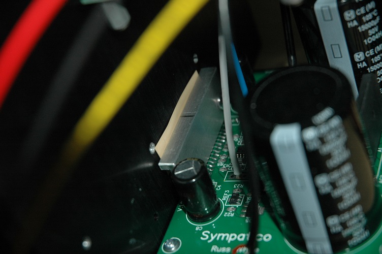

TPA Sympatico kit comes with a thick aluminum extrusion, cut to length and with screw thru holes drilled. It does not appear to be a commercial product intended as a heatsink clamp, but a custom part from a simple standard extrusion. It works great with a film insulator. Note the "L" which increases the stiffness to keep it flat when the screws tighten.
