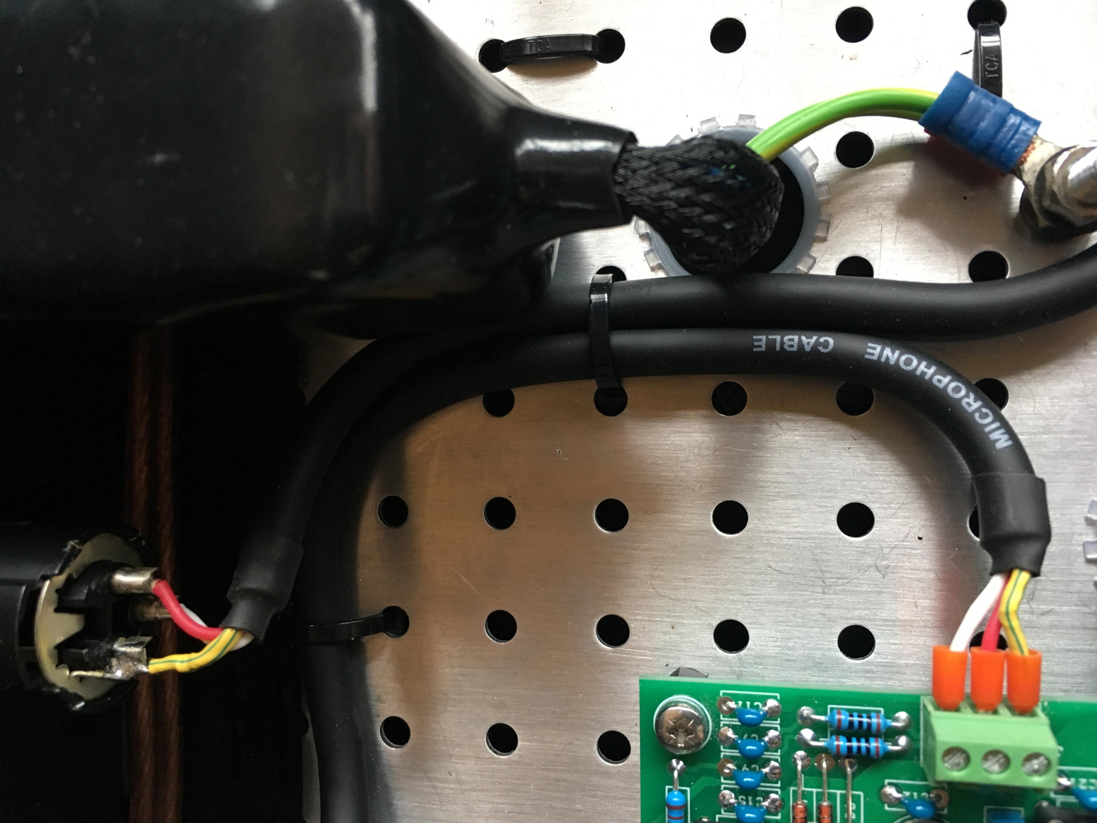

With the pseudo cable connect and the RCA floating as you describe at power up I intermittanly get a audible pop. And the cone can move forward or back slowly by quite an amount as the servo kicks in I guess. Nothing happens with the XLR unplugged.
Could this be caused by some interaction with the chssis and grounding? The chassis is all ali and so saftey earthed. The XLR socket is metal and bolted to the chassis. The XLR socket has a earth tab in the rear that I have connected to the screen of mic cable to the amp.

The XLR cable screen/shield goes to PIN1 and that gets connected to Chassis at the entry exit sockets.
Pin1 does not get connected to the audio. Pin1 is there solely to interconnect the chassis.

Thanks Andrew, so if I understand you correctly
I disconnect the internal sheild connection going from pin 1 to the MOD86 pcb such that the shield is only connected at the MOD86 end.
The chassis mounted XLR has pin 1 connected to the chassis, in my case I think the extra tab located by pin 1 is provided for this purpose.
The pseudo-differential cable takes the RCA ring to both pin 3 via the - cable and to the chassis via the shield to pin 1.
If so that is not how I understood Tom's documentation on page 20 of the design documentation.
Figure 13 of the THAT1200 datasheet is exactly how Tom suggests the Mod86 is wired except that the chassis connection shown in the RFI section is taken back to the chassis via the Mod86 PCB and that the gnd connection of the input is also. So as you say taking the Mod86 input ground to the chassis is not needed?

I have countered this as many times as you've brought it up. I am amazed that you still bring it up, in particular as in case of the MOD86 your "advice" is WRONG. I guess some people learn slower than others, but man... This is getting extreme.
The connection from Pin 1 of the board connector on the MOD86 to Pin 1 of the XLR >>IS NEEDED<<. Without this connection the input RFI filter does not work. Also without this connection the input common-mode voltage is undefined.
The plop on startup is >>NOT<< caused by the Pin 1 connection.
I hope I have expressed myself clearly this time. I'm sick of having to explain this every time you regurgitate AES48-2005 without putting it into the proper context or even contemplating the consequences or validity of your "advice". I know you mean well, but you're creating a lot of extra work for me here. I have enough stressors in my life. Thanks.

Please connect it as shown in the design documentation (which you already have done, so no changes needed).
As I mentioned earlier, I firmly believe that a little bit of DC is to blame for your turn-on plops. I am not able to reproduce your issue with a single-ended source connected to my MOD86 using a pseudo-differential cable. My source is AC coupled.

So would the advice be that for a single ended source to AC couple it? If so what size polypropylene cap would you suggest?

Disconnected the shield at pin 1 of the chassis of the amp. Made up a pseudo cable as per no 17 of the 1985 Rane doc. Leads picked up hum immediately as I touched the outer of the RCA. Connecting them to my passive preamp and was overwhelmed with hum. So now in the process of reconfiguring back to the masters suggestions

2.2 uF or greater polypropylene would work.

Yeah. That's what happens when the common-mode voltage is being decided through the mains wiring between the preamp and power amp. Thanks for confirming.

As it happens I have a pair of these from another project. They are huge mainly cos of their 630V spec but I have hooked them inline as a test. And with everything back to Mod86 manual wiring I still see it happpening when connected to the pre-amp or with the pseudo-differential cable RCAs disconnedcted and floating. See this video.
So it suggests I have wired something wrong in the chassis or made the same mistake with component population on both the Mod86 PCBs. I'll do some checking tomorrow in daylight
