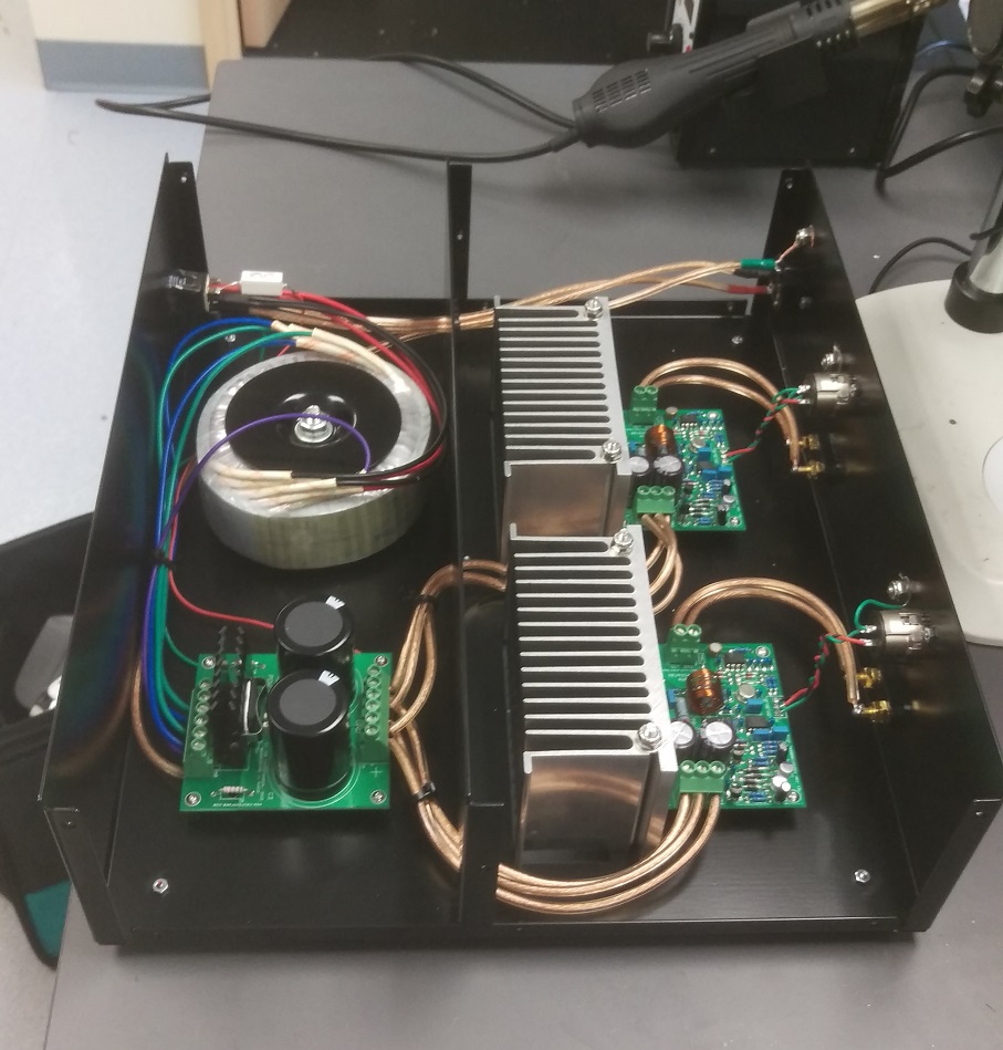

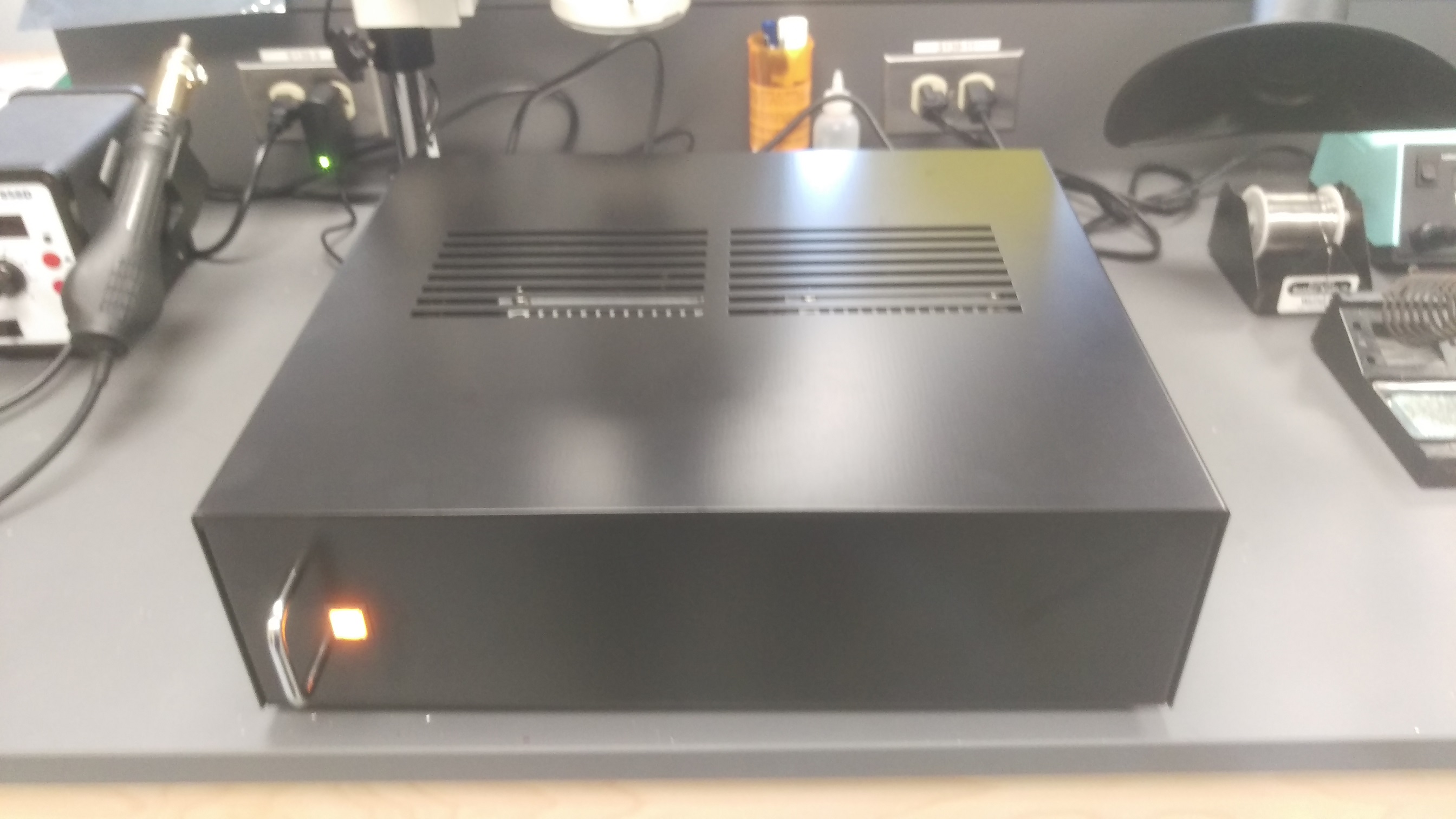

First post at DIY Audio. I finished my Modulus 86 build and sent Tom an e-mail to let him know how great it sounds. He asked if could share here, and I'm happy to do it.
Hi Tom,
I finally got around to putting your amp into use and I just wanted to write to let you know how great it sounds. I'm using a Benchmark DAC1 HDR as source and ATC SCM11s as speakers. Great depth and imaging, really articulate bass.
I ended up taking a while to do the assembly, then even longer to design an enclosure (I had this made at Protocase, another Canadian company). The last few months of waiting were on getting a phono stage, as I had been using the one in my previous integrated (an old Sansui, restored and recapped to sound pretty good).
I've attached a few photos in case you're interested to see how some of these turn out.
Thanks again for the great amp.
- Jeff

The photos are quite impressive!
I was fascinated for quite a while on just counting the number of things that were done on purpose. Initially, I was just checking to see if that neat looking amp had both a hot air output and a cool air intake.
Oh it does.
The feet are tall enough to make the cool air intake work well (Sony forgot? that on their HD radio).
And, your amplifier is positioned near floor level, which is cooler.
The amp is also on the side of the shelf away from the Electromode linear convector, which is cleverly sized to most comfortably stabilize the room temp (that costs a fraction as much as freeze-n-burn), and it was ever so neatly installed. I've seen a lot of those, but it is the first time seeing one that made the room look better. I get curious, so is the thermostat at doorknob height and near the seating (so it is never necessary to move the knob)?
Looking beyond the excellent care of the thermals, I also spotted a neat soldering area (other photo).
My own soldering area looks like a small plane full of electronic parts had crash-landed onto large bin of entirely different electronic parts. It isn't that they weren't put away, but they tend to escape if I do more than one project at a time.
And then back to your photos. . . Since there's no TV hooked up to your audio system, it is far more likely to play music. Excellent!
I've had the misadventure of putting a fine sounding system in the same room as a TV, even though yet more TV sound wasn't what I was after. Your photo shows sure cure for it: A nice, quiet, albeit weird, painting; that cannot block off the music like a TV does. Kudos!
One more look at the amp. . . It is built like a tuner in that the power and signal are well separated. That amp didn't require so much care, but it is good to see it built like that.
jrl,
the pigtail connecting Pin1 to enclosure is far too long.
Is the shell of the socket electrically connected to the enclosure?
If not, then make it so. The more electrical connections you can ensure around the perimeter of the hole it pokes through the better.
Then you can connect Pin 1 direct to the shell of the XLR socket with a few strands of wire just 3mm long. 4 strands of 0.15mm diameter cooper 3mm long is far lower impedance than 42 strands of 0.15mm copper that are 30mm long.
Pre-solder the shell with a very hot soldering iron before you solder on the short wires.
You can also attach 10pF to 47pF ceramic capacitors of NP0 type from pin2 to pin3 and from pin1 to pin2 and from pin 1 to pin3. These provide a bit extra RF attenuation before it enters the enclosure. The leads of the caps MUST be very short, 1mm to 2mm maximum.
I find it funny how you choose to worry about a short pigtail while ignoring all the RF that will enter through the long slots in the top plate. #perspective
Actually, by definition, they wouldn't. If you want to keep the RF outside the chassis, you'd need ferrite beads on the outside of the enclosure and feed-through capacitors as the various wires enter the enclosure. You'd also need an RF seal along all edges and no slots in the chassis would be allowed. These measures would be completely appropriate if you were building a satellite, space shuttle, or avionics but would be total overkill and completely unnecessary for residential audio applications.
While I do agree that the RFI filter could work more effectively if placed right on the connector, that complicates assembly unnecessarily. That's why the RFI filter is on the PCB.

Thanks everyone for the feedback. I did spend way too long working out details, so it's nice to hear I caught most of them.
I agree the little pigtails aren't ideal for RF, but I had wanted to use a heavier bolt to make a really strong chassis connection. I noticed the XLR connector does have a pin to the shell, so I could make a direct connection by removing a some of the epoxy finish.
Otherwise, I was a bit careless about RF, as I had seen in Tom's notes there is a filter on the input. The long slots in the enclosure were the biggest compromise; using lots of little circular perforations does a better job, but adds a lot to the enclosure cost.
