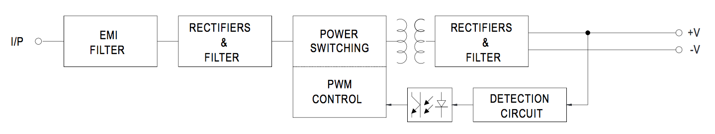

Really? How's the output voltage controlled then?
Every SMPS I've built and all I've seen schematics of, including the Connex Electronic supplies, have been regulated. They have a feedback loop from the output back to the switching regulator IC. That's the definition of a regulated supply right there.
The block diagram for the IRM-series from Mean Well (attached) shows a feedback loop as well. That is also regulated!
Tom
regulated is very common. That's because most of them drive digital circuits that are sensitive to significant changes in supply voltage.
But smps is simply a switching power supply. It does not by definition include a regulation stage.
Tom

Bruno set out to make transformer replacements and designed a supply where the output voltage is proportional to the input voltage. First off, that doesn't mean the supply isn't regulated. Secondly, it also doesn't mean that all SMPSes are made this way. In fact, the Hypex supplies are the only ones I've come across that are made this way.

If its sold as a smps what's the chance it doesn't have some way of setting a target voltage? Anyone ever seen one that doesn't include regulation?
Regulation doesn't need be obvious i.e an opto to allow directly sensed feedback to be applied to the primary switcher, it can also rely on primary derived voltages to apply basic load/voltage regulation.
Can't recall any running open loop... how could they when most cope with 90 to 265 vac input.
