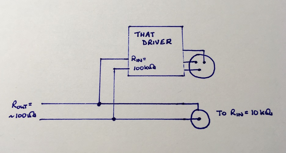

Is it possible to install a THAT Driver parallel to single-ended outputs?
In my case, I want to add a balanced connection to go to my Mod-86 amp, but I want to retain the single-ended output to connect to a second device (preamp).
The source output impedance would be 100 ohm. The input impedance for single-ended preamp would be 10k, and the input impedance of the THAT Driver is 100k. I am thinking that the source would see ~9k if the preamp is connected in parallel with the THAT Driver.
Any issues with this?
Cheers, Curtis
I'm confused. The Modulus-86 has a differential/balanced input. If your source is also differential all you have to do is to connect the source to the amp and be done.
The THAT Driver takes a single ended source as input and provides a differential output. Think RCA -> XLR.
The THAT Receiver taxes a differential input and provides a single ended output. Think XLR -> RCA.
Single ended is the same as unbalanced.
Differential is the same as balanced.
Hope this helps.
Tom
The source does not have differential output. It only has one set of single-ended outputs. I want to create a set of single-ended outputs and a set of differential outputs.
The way that I read the THAT Driver description suggests that it replaces the single-ended source: SE output -> THAT Driver input. However, I want to install the THAT Driver parallel to the single-ended outputs.
I have attached a sketch that will hopefully clarify things.
Cheers, Curtis
