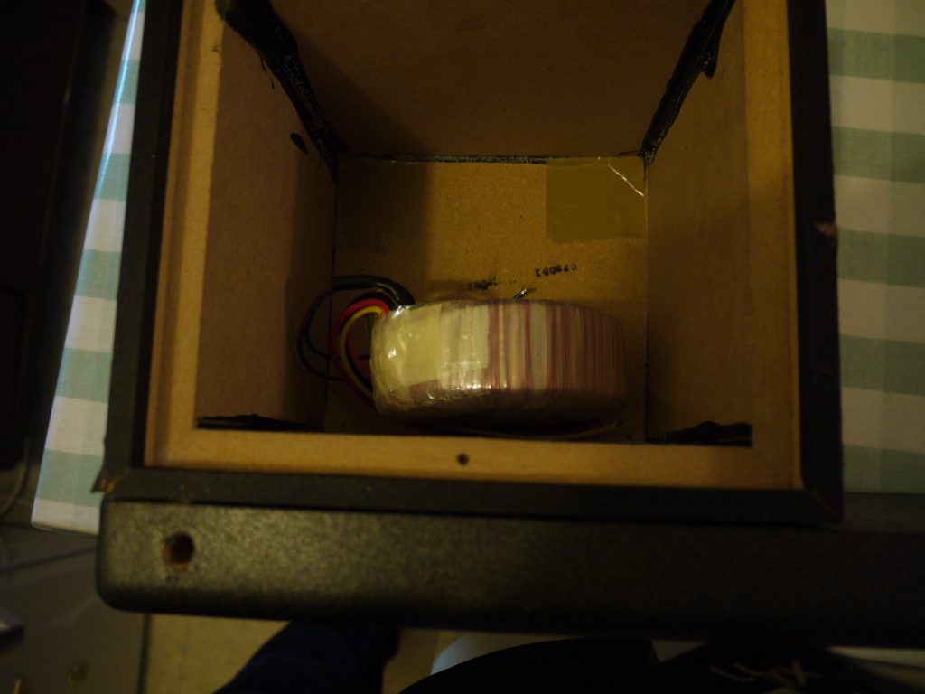

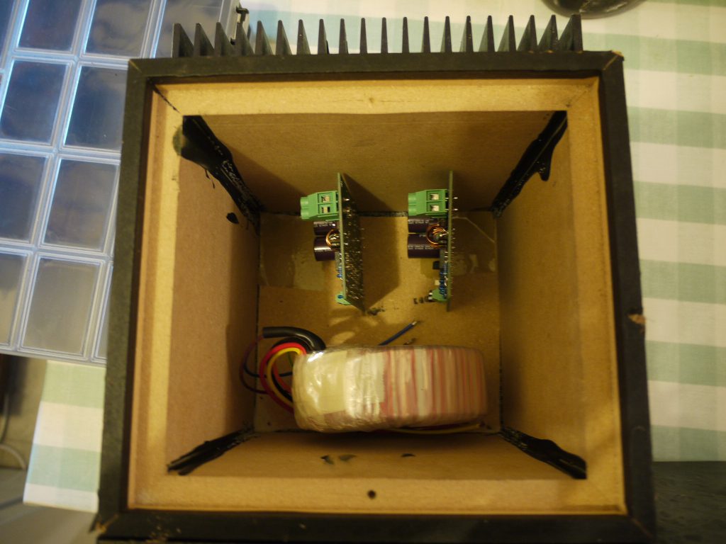

Right Finally remembered to extract the camera before the living room was taken out of action for the night (just don't ask) and here is the collection of bits I have to work with. Hey MrT managed with 4x2, gaffer tape and nails and he was blowing sh*t up
First pic is the speaker stand, with its sand removed. First issue is that the front part is glued on and being over 20 years old the vinyl is it glued to is peeling off. Needs to be screwed on properly. Second is that space is limited so will need to cut a hole front and back. Front so the transformer bolts to the nice thick front piece and back for the transformer.
Second pic is my £9 ebay heatsink with bits machined out in just the wrong places
Third pic shows how the heatsink will fit on. It will be screwed to the outside of the box and a hole cut so I can mount the 2 mod 86 on the inside.
Last two pics are a very rough trial fit to show where things will go. Not got the PSU board out yet, but once the transformer is in its cut out there should just be room. I'll need to drill holes in base and top for air circulation. IO will be on the right hand side (IEC, 5 pin DIN and speakon). Ought to work out where an indicator LED goes as well.
Access will be limited so will make sure leads are long enough to be able to drop the heatsink off to access things.
A tad bonkers, But If I don't c*ck it up will be a nicely packed active setup.

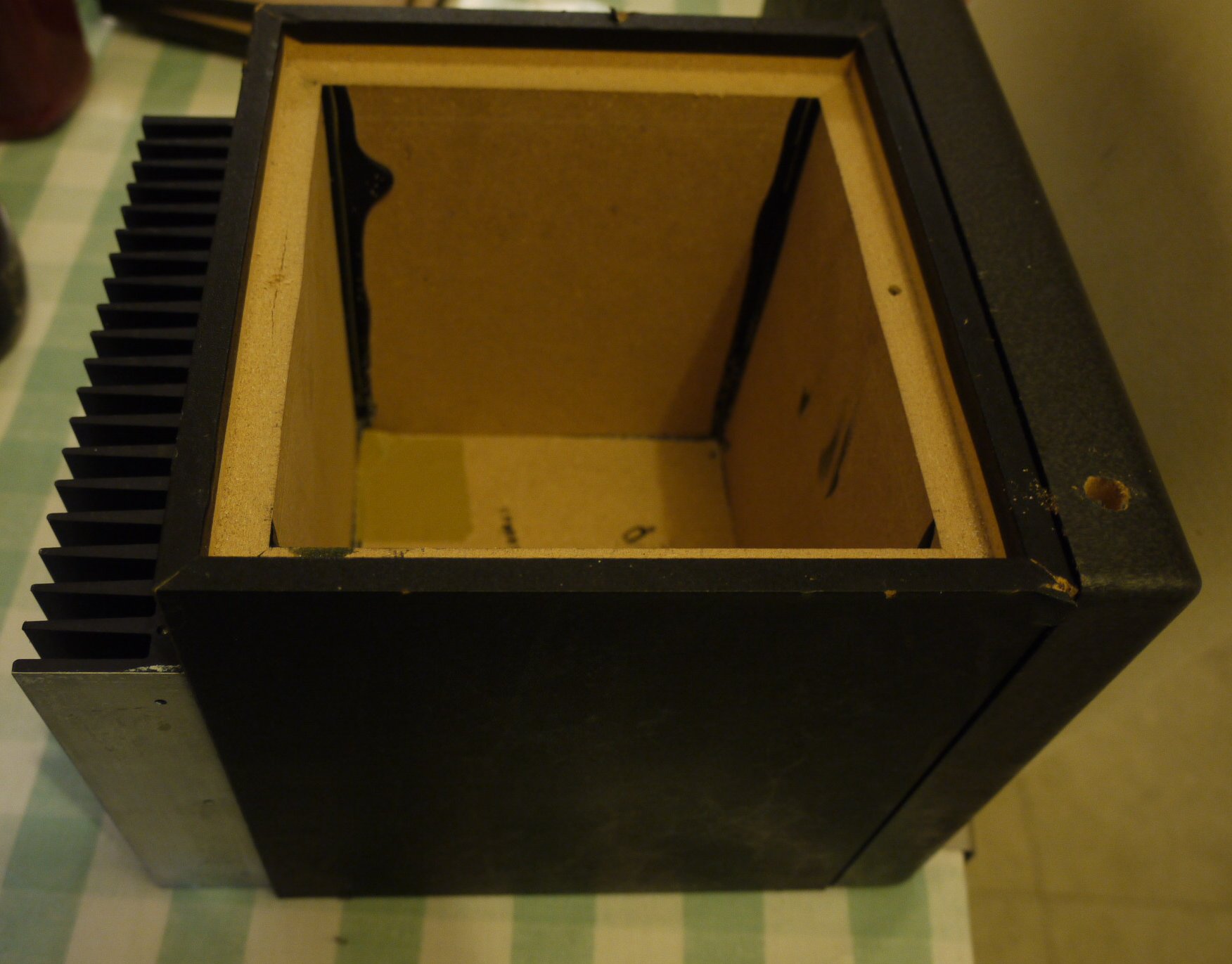

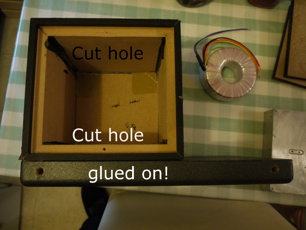

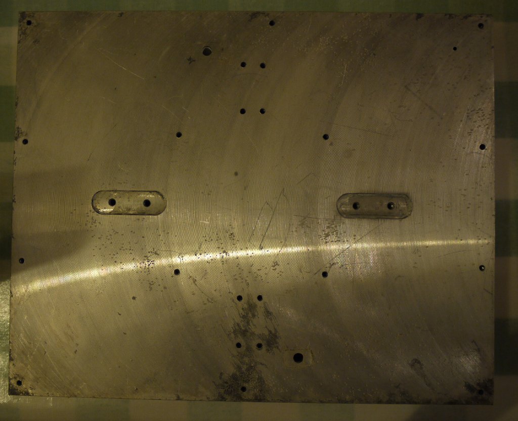

There won't be flames but there will be fumes if the cabinet MDF gets appreciably warm.That will be nice and cosy. And hot! Transformers are not 100% efficient as you know. There is also stuff on the board that will warm the air up. I do hope you and your kids have a good escape plan for when this thing bursts out in flames.
Best to contain those glue fumes by sealing all MDF in a good layer of paint/enamel etc to keep such fumes from releasing into the living room environment.
