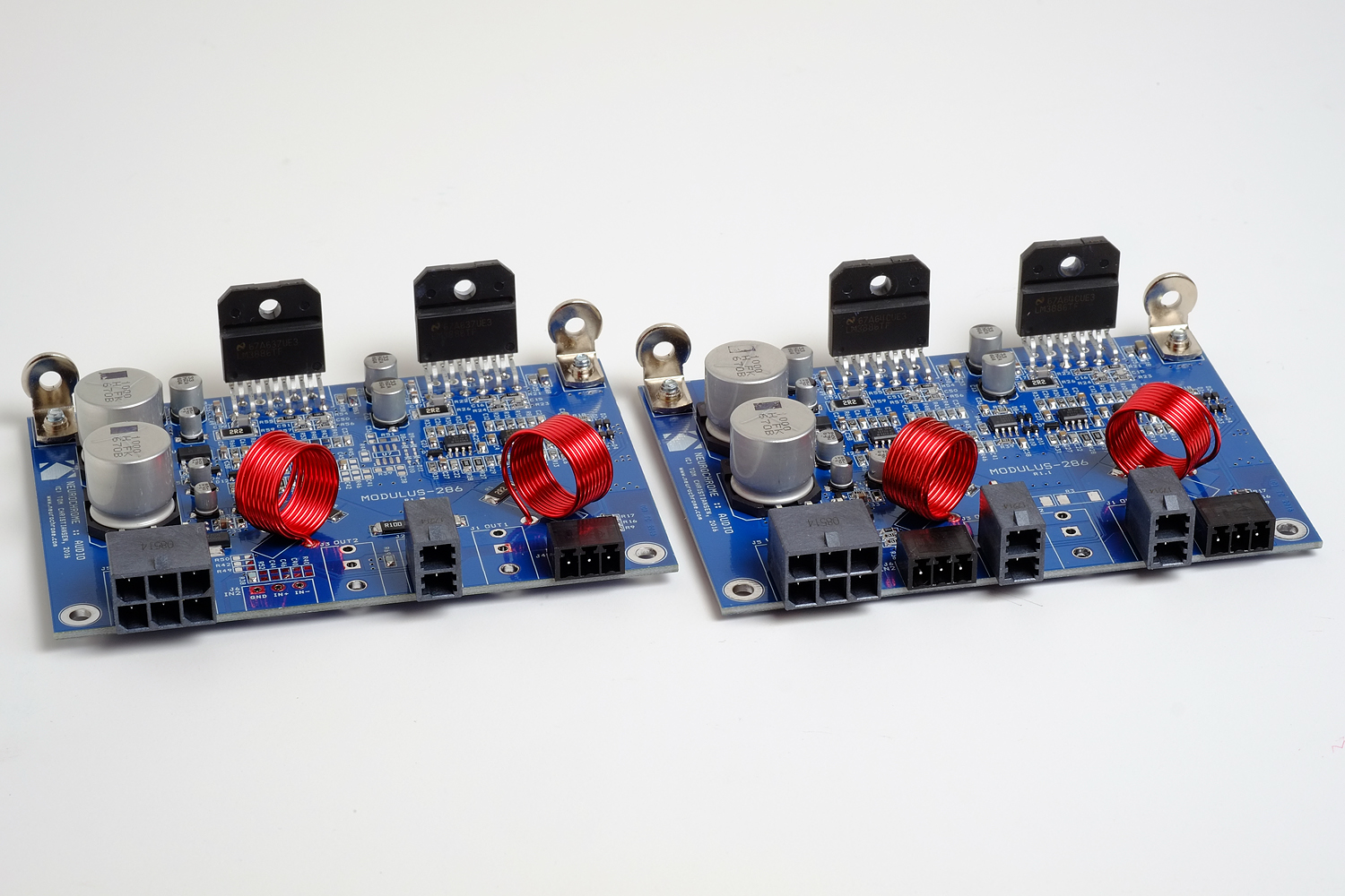

Twins! Dizygotic, of course. :)
Mono MOD286 and Stereo MOD286.
Tom
