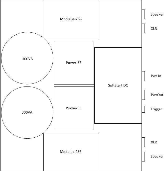

This made me wonder about my proposed layout. Obviously, I'll try this before buying the Dissipante case.

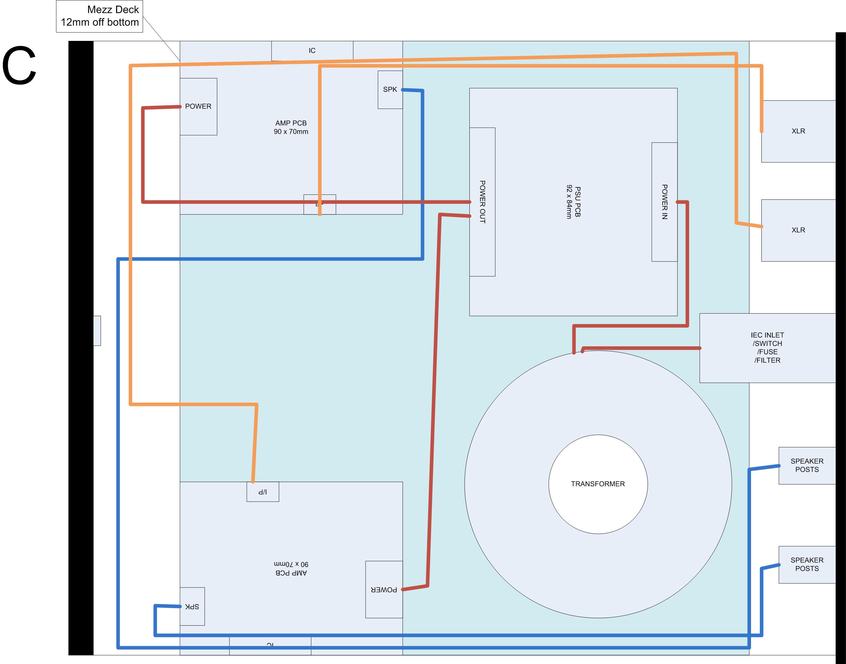

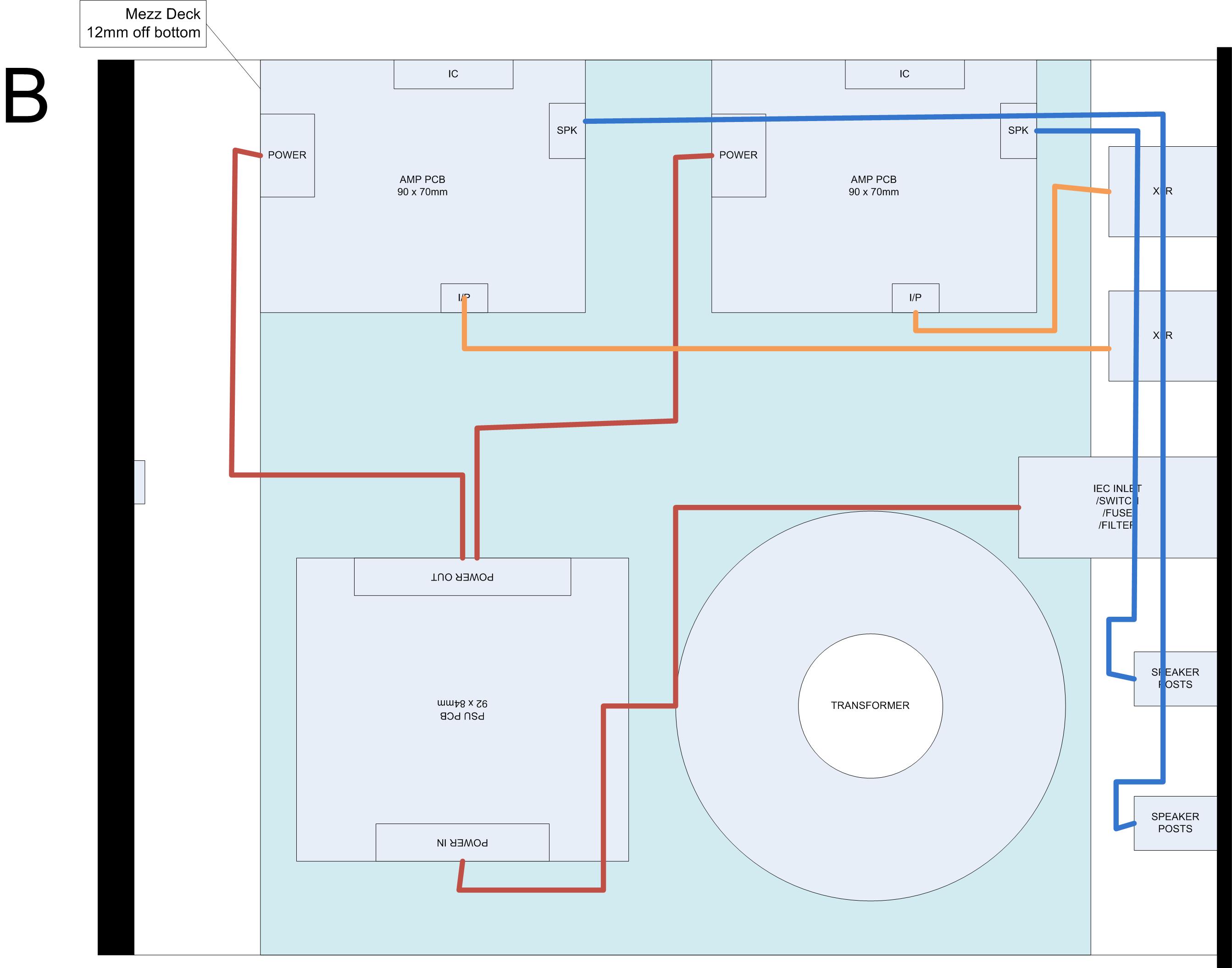

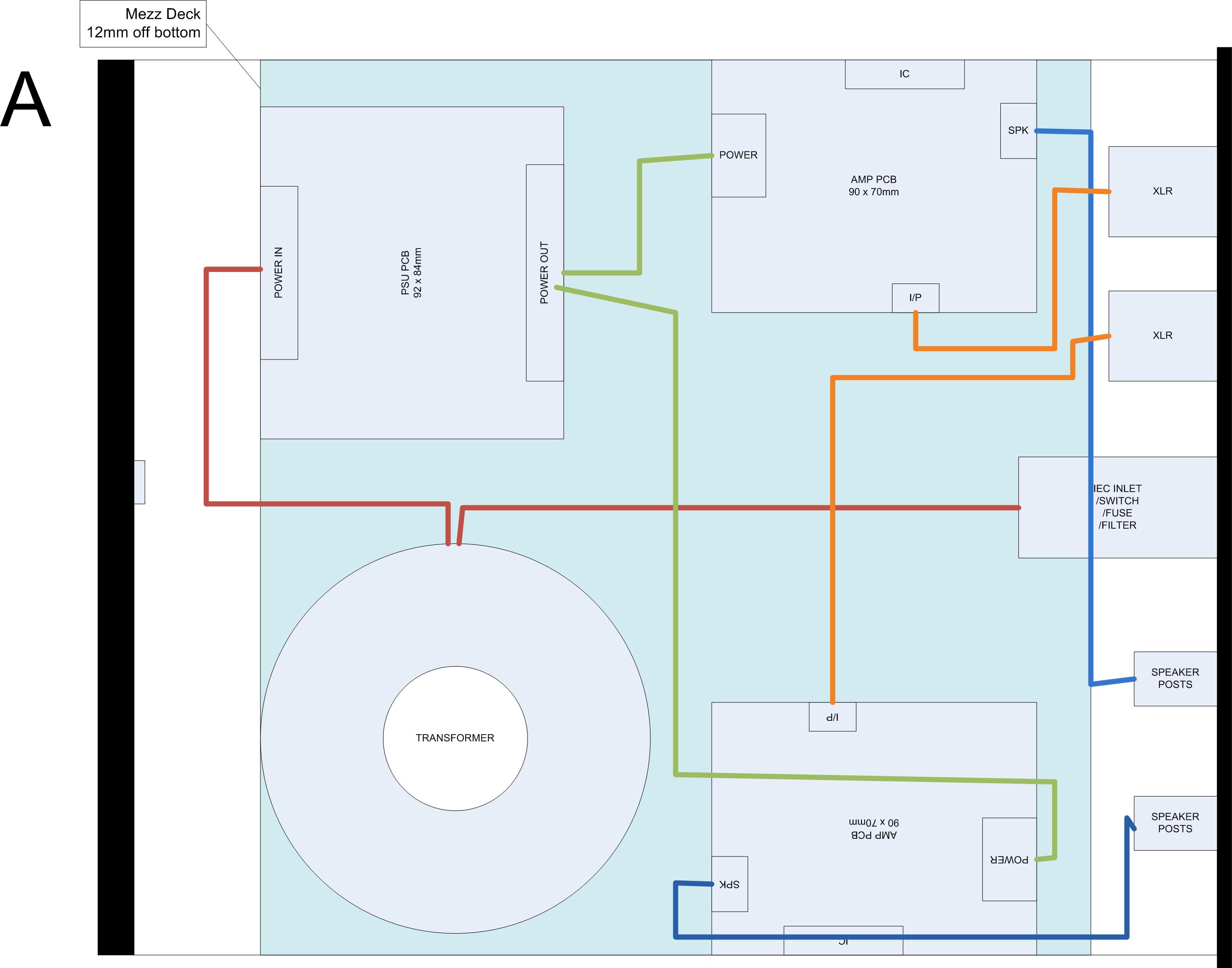

Layout optimisation in a Mini 300 Dissipante Case
Ok so some things are now fixed ie: the front panel LED and rear panel connectors.
I'm going to have an internal Ali deck so I can provide upper and lower cable runs. Although if I understand what I have read here that many not be much of an advantage, sheilding wise. I was going to have power cables on the underside and speaker and input on top.
Where cables of different types have to cross each other I shall try and to that at right angles to each other.
Tom has suggested that all the power leads should be as short as possible and not reach too far in to the chassis.
So as I see it I have three options, anyone have any thoughts on the best?
A
- My preferred layout
- Breaks Toms suggestion
B
- Keeps power on one side
- Heatsinking not optimised
C
- Power cables as short as possible as per Toms thoughts
- Power at rear of case with audio cables having to run around
TIA
All of those will work.
I suggest you lay these on the bench (no chassis) and actually test/measure the H+N at the output/s. You may find that all perform near enough the same.
You may find that one or two cables need a particular routing to minimise H+N.
When you see a layout that works as well as, or better than all the others, order up a chassis/enclosure that fits around your system layout.
Tis the same as my prefered, option A. But the suggestion is not to run the power lines to far in to the case and keep them all short. There is a lot going on in your case so I dont see many options I guess you could move the swap the amps to the front and try and get the transformers to the rear so all the power is a the back but then you will have all the amp cables crossing this lot.
I'd say your layout is a good compromise but I know nowt!
With the Modulus-286 it is especially important that the board is roughly centred left/right on the heat sink as you show it.
That soft start board is enormous! Is it really that big or is it just a placeholder?
Beware that the connectors on the MOD286 (and PWR86 R1.1) stick out from the PCB, thus, you need probably 50 mm minimum from the board edge to the next object.

With a large toroidal transformer, there's no good placement, really. This is even more true if a mains filter is used and allowed to protrude into the chassis.
These would be my priorities (roughly in order):
  • Keep the amplifier boards roughly centred along the length of the heat sink.
  • Keep the toroid on the centre line front-to-back of the chassis. That makes the amp much easier to move and tends to work out well with the wiring.
  • Keep the transformer wiring short if possible, especially for the secondary.
  • Tightly bundle the wires from the power supply to each amplifier board.
  • Keep the amp inputs away from high currents (power supply wiring).
Stuff like power-on LEDs and such is not on the list as it's really quite inconsequential.
I'm not in any way implying that this is an exhaustive list. As with anything else in engineering and audio design, it's a multi-variable optimization problem. There is not likely to be a global optimum. You may find several local optima, each with their own set of tradeoffs.
Tom
Yeah, in your case with the 2xMOD286, it may make sense to get the 3U size of the Dissipante. Better thermals. More room. You could flip quite a few of the boards vertical then.
