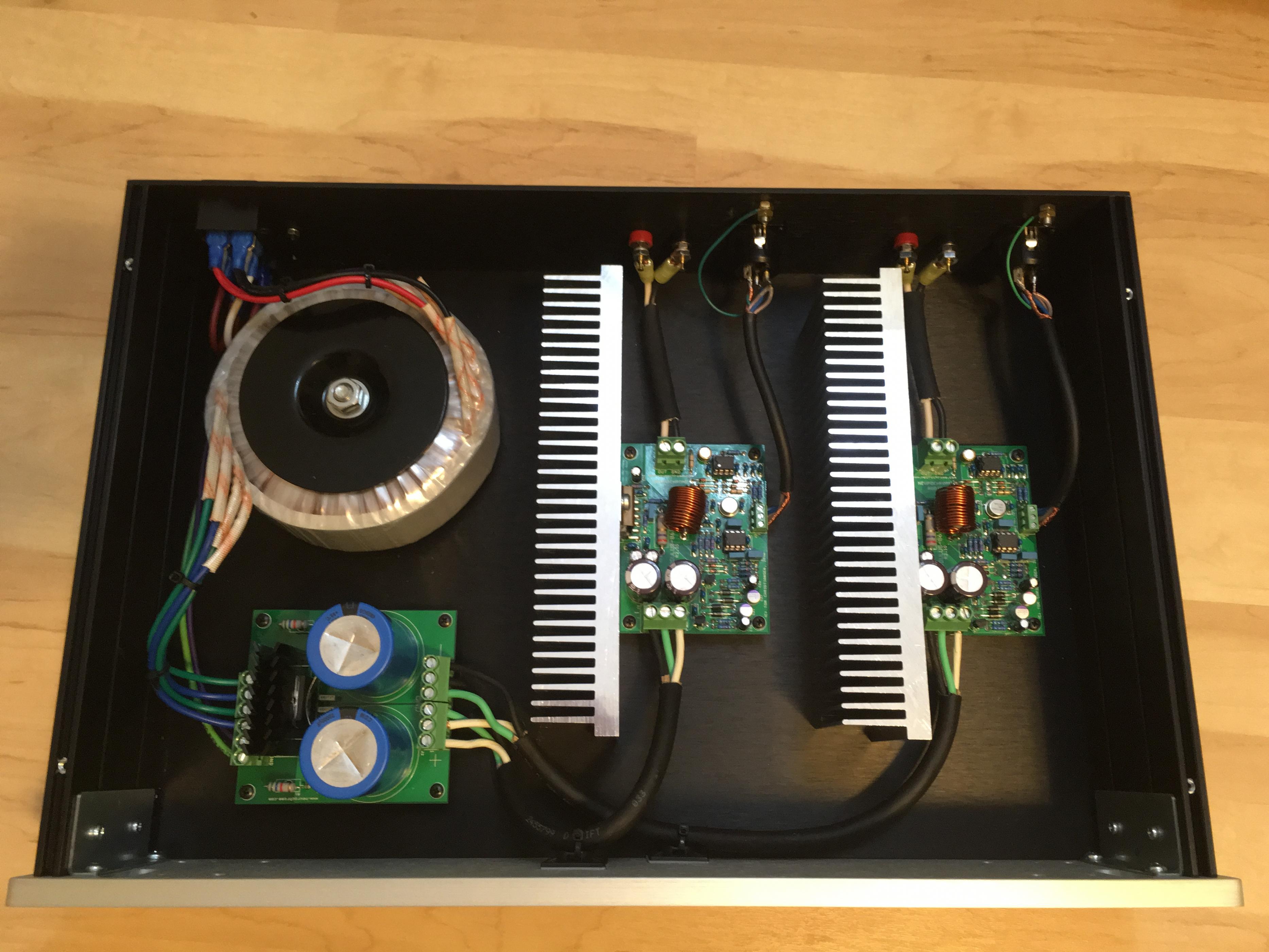

Henry,
take the transformer's shield wire direct to chassis floor using a short wire.
6A mains fuse seems very high for a 110/120Vac supply into a pair of chipamps.
I see the transformer has 4 primary taps for a dual primary type.
Each primary has a Flow and Return (Live and Neutral). This pair must be twisted. The other primary should similarly used a twisted Flow and Return pair.
The secondary outputs are also 4 wires. These too should be arranged as two pairs, each pair being the Flow and return of one secondary.
All the loop areas at the terminations of the transformer's pairs should be kept small.
All the above is to minimise the emi emitted by the transformer and it's wiring.
The +ve, -ve and Zero Volts from the PSU to each amplifier should be arranged as a twisted triplet. Again the loop areas at the terminations should be kept small to minimise emi.
The input XLR has 3 pins and a shell. The shell and pin1 are connected directly to the Chassis at the entry hole. Pins 2 and 3 are your signal and these are taken to the amplifier using a twisted pair. It can be screened or unscreened. If screened then it is better to connect both ends of the screen to the chassis using low impedance connections at both ends. A long pig-tail is not as good.
Finally each speaker pair should be twisted and incorporate low loop area terminations.
Attending to these emi minimisation steps will virtually remove the need to be concerned about emi effects of nearby cable pairs affecting any other cable pairs.

What are you builders of the Parallel86 using for a fuse. I'm using the Antek AS-3224 300VA transformer at 115 Vmains. Using the simple equation fuse = 3 X VA/Vmains I get 7.8. That seems a bit high based on what I've read in other posts.
On a slightly different fuse topic, my Aragon and McCormack have a 10 or 12 A slo-blo at the IEC but also have lower amperage fast-blo fuses on the rails. I haven't seen anyone using rail fuses. Why is that?
I use a 6.3 A slow-blow fuse with my 300 VA Antek transformer on 120 V mains. I've yet to pop the fuse.
As we discussed here recently, 3x VA/Vmains is likely overkill. 2x VA/Vmains is probably asking for trouble unless you use a soft-start circuit.
If you really want to get into it, you can look at the inrush current vs time and work out the I2t rating needed for the fuse. You then find a fuse that can handle this, which means you'll be specifying a specific brand, specific series, specific ampacity of the fuse ...... or you could just get a 6.3 A slow-blow fuse like I use and be done.

It's all complete and I enjoyed a long listening session with this amp on the weekend. It was fantastic.
This was my first amp build. My decision to build this particular kit was completely validated, but it wasn't only the sound quality. It was the entire experience: knowing the design was thoroughly vetted and measured; receiving excellent documentation with the PCBs; and reading the supplemental posts from individuals on this thread who shared obsessive musings about hardware, layout, and cables. I know I did my own obsessive musing about hardware, layout, and cables.
Here are some design decision that were made:
Input Connection
I picked up bulk Mogami W2534 quad microphone cable from Guitar Center (US) for the connection from the female XLR chassis mount to the input of the Modulus-86 board. I would have preferred the W2549 two conductor balanced microphone cable because twisting the quad cable into two connectors and keeping everything as short as possible was a challenge.
Assembly Tools
It was mentioned that a ratcheting crimp tool would be beneficial. I used a standard crimp tool, but I could definitely understand the appeal of an upgraded crimp tool.
I should have put money into a better wire stripping tool. I used inexpensive handheld IDEAL brand wire strippers. Of the 12, 14, 16, 22 AWG wires used on this build, it only stripped the 16 AWG wire nicely. I was either nicking and pulling conductors on the smaller conductors or not cleanly removing the jacket on the larger ones.
Soldering
Check out the PACE Worldwide Youtube page for excellent soldering tutorials. The videos are from 1980 but the content was excellent. I had barely done any soldering before this project, but I learned everything I needed to know from these videos.
Chassis
I went with the Modushop.biz SLIMLINE 2U case. I did provide them with CAD files for routing the back and bottom panels. I received the case a week after the order. It was great.
I didn't mess with threaded holes on the chassis. This allows for the looser floating fastener tolerance stackup. I did use thread rolling screws electrically for the chassis grounding connections and mechanically for screwing into the heatsink.
I didn't do anything with the front panel, no LEDs or engraving. I used an illuminated IEC power inlet, so if I want to know the amp is on, I'll just peak my head around to the back the case.
