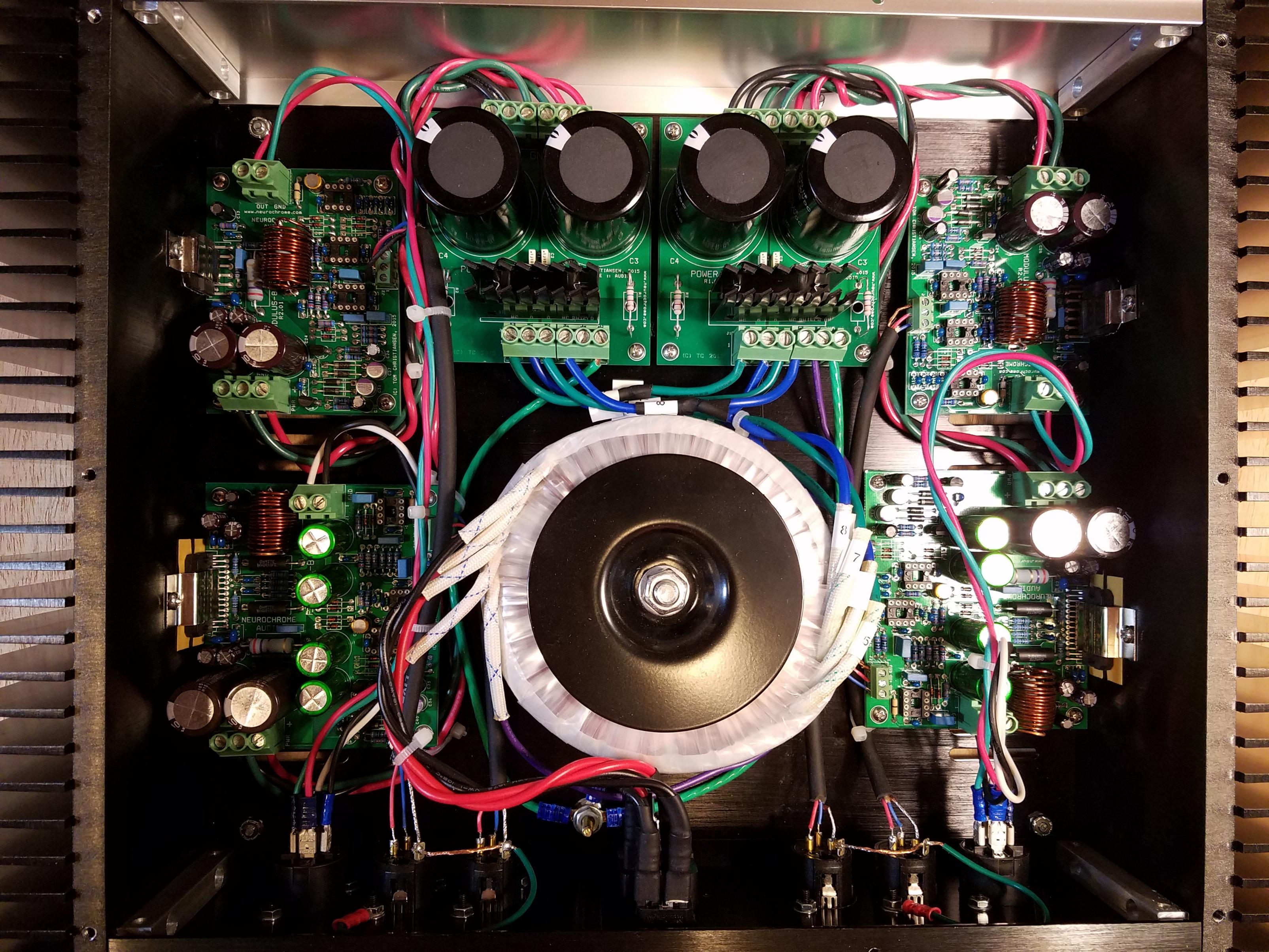

Here is a peek at my (finally) completed build. It was configured to drive my LXminis. Into an eBay BZ4309 enclosure I've packaged:
-an Antek AS-3222 transformer
-2x Power 86 (one for each speaker channel)
-2x Modulus 86 (one for each full range driver)
-2x Parallel 86 (one for each low frequency driver)
As you can see it's tight but workable. So today after installing a 6.3A slo-blow fuse and passing the quick check on Q4 supply voltages I populated the IC sockets, connected it to the LXminis and fed it some music from my Surface 3 Pro via jRiver Media Center 21 through an Emotiva Stealth DC1 preamp/DAC.
The sound was superb, and this is in my ~700 square foot shop with concrete walls, concrete floor and very little in the way of absorption. There was ample drive (I used the 26dB gain resistors) and after an hour of listening at the high end of comfortable the heat sinks were just perceptibly above ambient temperature at maybe mid-80s F. It was dead quiet between passages, even with an ear at the FR driver. So next I will pack it all back into the family room where the LXminis do duty both as TV speakers and for musical program. Tom...I am very impressed with both the final product, and with the no-issues build thanks to your superb documentation!
Dang! That's a very nice and compact build. Nicely done, Sir!
Thank you. I'm glad everything worked out well for you and you like the amp.
