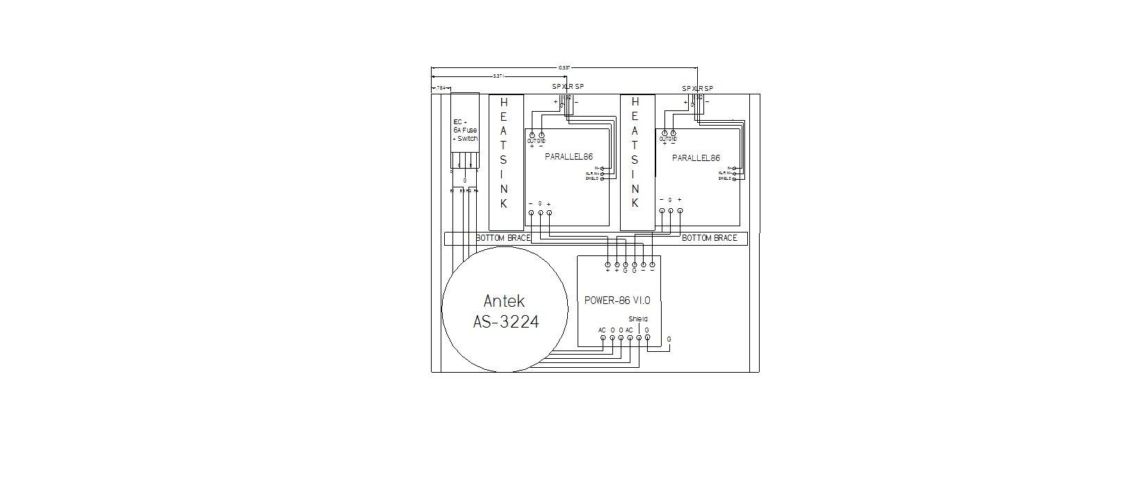

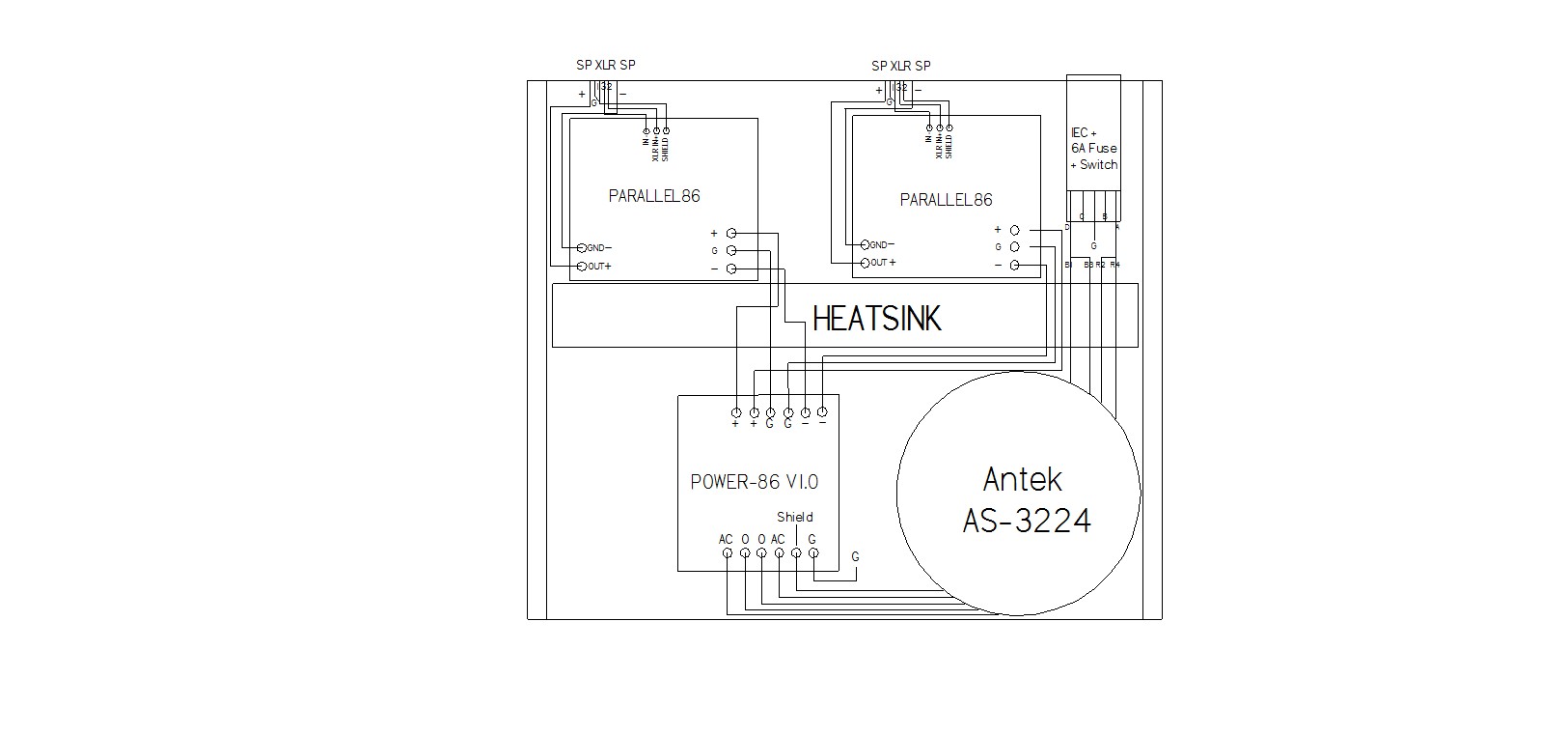

What layout is better
I've attached two layouts for my Parallel86 and would appreciate feedback.
One layout has a 12" heatsink, in the middle, running from side to side. It serves two purposes, one as a heatsink, the other as a brace to keep the thin aluminum bottom cover flat. My only hesitation is that the Power86 wires, connected to the left PBC, are parallel to and about 1 1/4" away from the right PCB speaker output wires. I don't know if that should be a concern.
The other layout is like my Mod86. Each PCB has it's own heatsink and it will have a brace, just like my Mod86, to keep the bottom cover flat. I like this layout because, the Power86 wires are on one side of the PCBs so, no power wires are near any of the signal input or output wires.
Bottom line is, if power wires and speaker output wires being parallel and 1 1/4" apart is not a concern, I will probably build the one with the 12" heatsink. It's thermal resistance, at C/W/4.5", is .702. The 5 3/8" heatsink, at C/W/4.5", is .949.
Thanks,

Honestly, they're functionally identical. One could argue that the arrangement with two heat sinks allows for shorter supply wiring (which doesn't matter greatly due to the Parallel-86's high power supply rejection ratio) and shorter speaker out wiring (which doesn't matter greatly as you follow that few inches inside the chassis with several feet of wire to the speaker).
The arrangement with the one large heat sink saves you the bottom brace and you could potentially use a larger (wider) heat sink, allowing the amps to run cooler. The drawback of this arrangement is that you run the wires over the heat sink. You'll need to devise some gizmo to prevent them from chafing.
The arrangement with two smaller heat sinks is cleaner from a wiring stand point. With the two heat sinks you have, using two sinks should result in better thermals (according to the thermal resistances you provide), though, I strongly suspect the two will be equivalent in thermal performance once you take into account the two heat sources vs one on one heat sink vs two.
In the end, the two are about the same. You say tomato. I say tomato.
Tom

Thanks Tom,
I bought a 3ft long piece for the original brace and already cut a second piece that will fit perfectly..just need to drill three holes.
I do like the cleaner wiring.
Even thought the 12" heatsink resistance is quite a bit lower than the 5 3/8" heatsink, it will be effectively higher with two chips on it, so I think either would provide sufficient cooling.
The transformer in the corner helps keep the bottom cover from sagging. So, based on my Mod86, no other bracing is required. My other amps weight from 40 to 80 lbs, are heavier on one side or front vs back, and I never had a problem moving them.

A close rated fuse is VA/Vac.
A fuse that is big enough to not suffer nuisance blowing in starting an inductive load is 3times bigger.
Thank you for clarifying. That's very useful information.
Because he asked.
Maybe I misinterpreted your response, but you came across as someone who assumed Henry had no experience at all. While he isn't the most experienced here, and he's usually the first to admit this, he does have a successful build behind him. He should at least receive that much credit.
Tom
