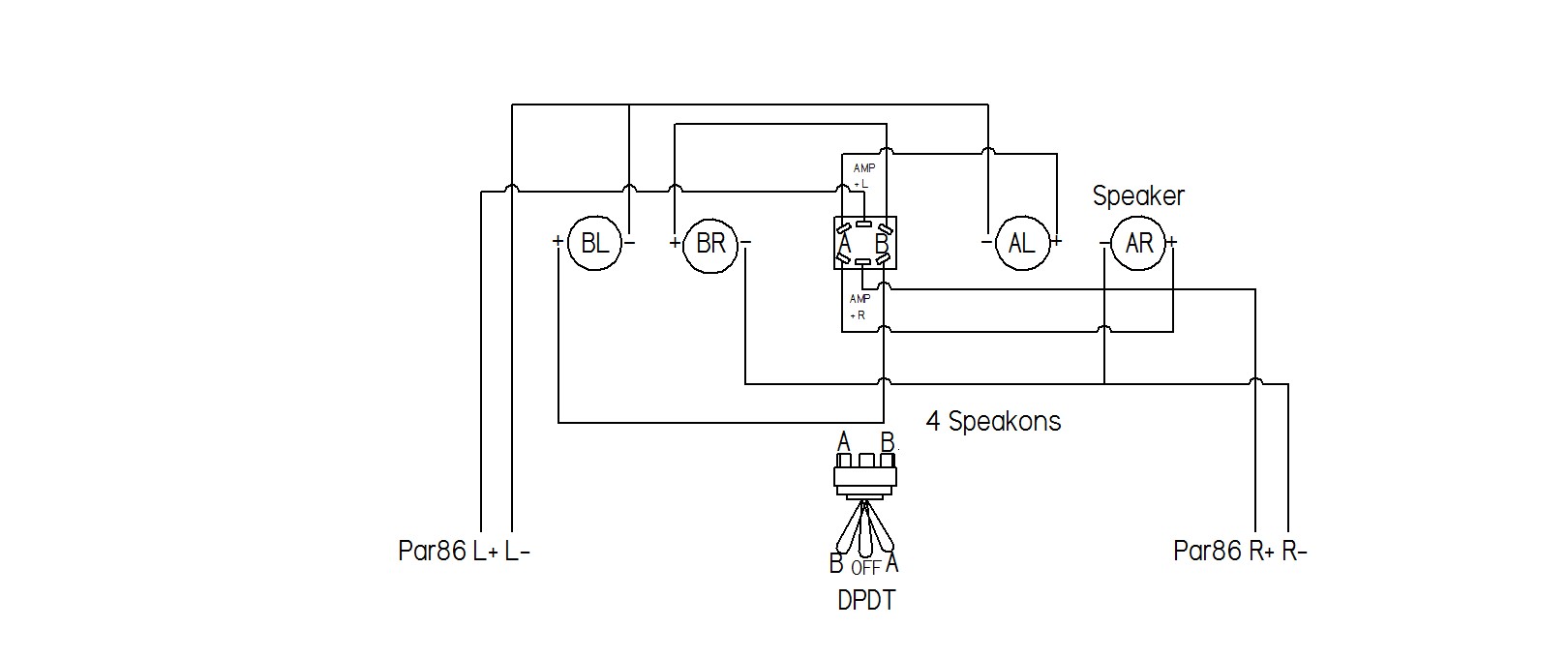

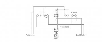

I've posted about building an A B speaker selector switch and included some sketches.
This is an update on my A and B selector switch in the Parallel86 chassis. It eliminates the need for, a separate box, four Speakon connectors and reduces the number of connections.
I’ve attached a new schematic of how I think a DPDT speaker selector switch, inside the Parallel86 chassis, should be wired.
Since there are left and right channel PCBs, and left and right channel speakers, the schematic shows both A and B left channel speaker negatives (-) connected to the left channel PCB GND at the terminal block. The same is shown for the right channel.
Is that negative wiring scheme important or can the speaker negatives return to either PCB?
I ask because I wonder if both left and right PCB speaker GNDs are ultimately going back to the same GND.
I also imagine the schematic could be simpler but I believe it shows needed connections. Am I missing anything? Is it totally wrong?
Thanks,
henry
The way you have it drawn is correct.
The returns from the right speakers should go to the right channel Parallel-86 PCB. Left speaker return to the left PCB. Exactly like you have it drawn.
Tom
